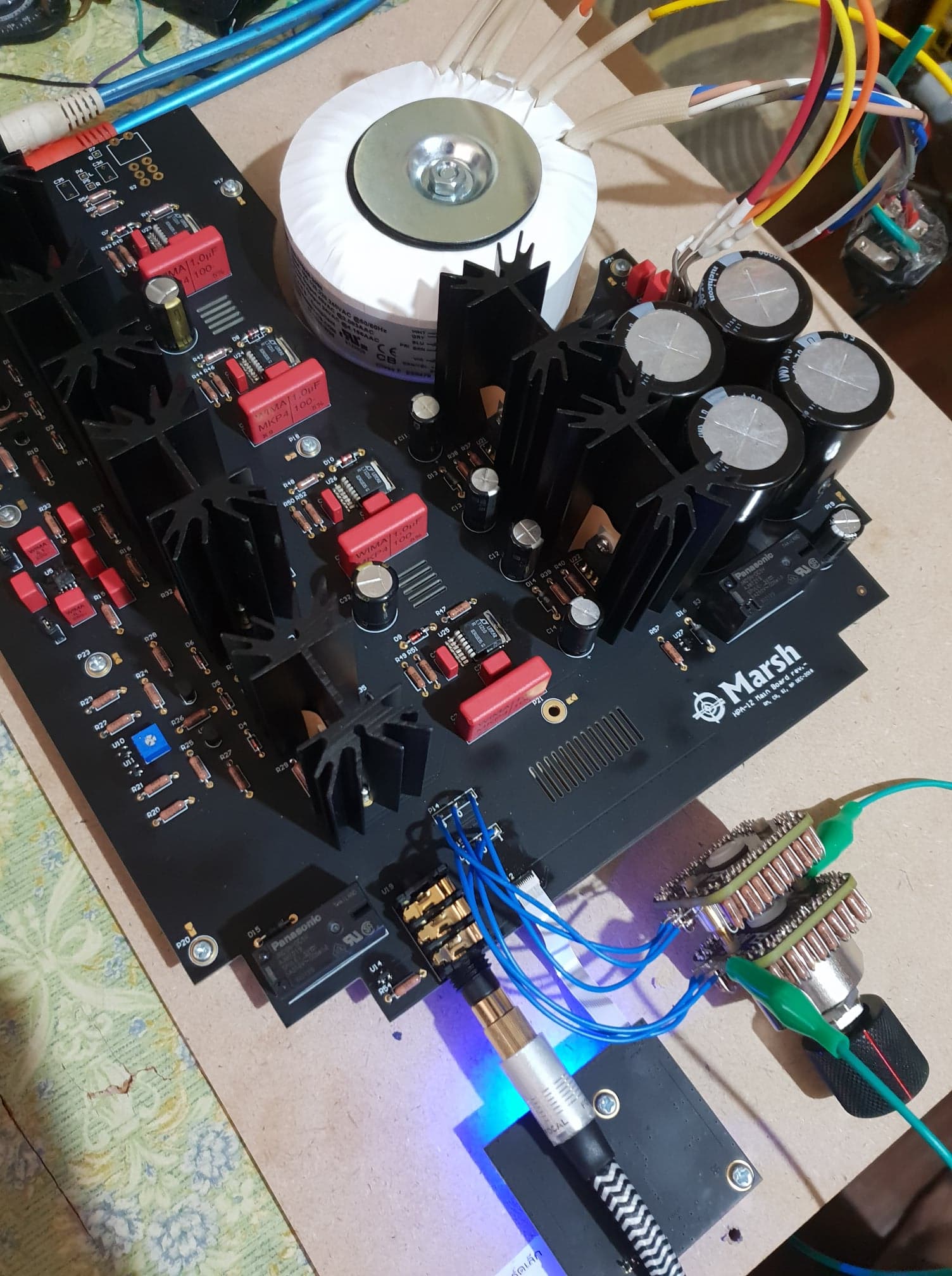

What is the output power of this amp? I am driving the HE1000 V2 right now, not easy to drive and this amp is doing an excellent job of it!
My MARSH amplifier with +-14V PSU can delivery about 2W @ 35 ohm (9V rms ) - and 1W of these 2W will be pure class A ( with 120mA bias per transistor) and then ir will switch to class AB

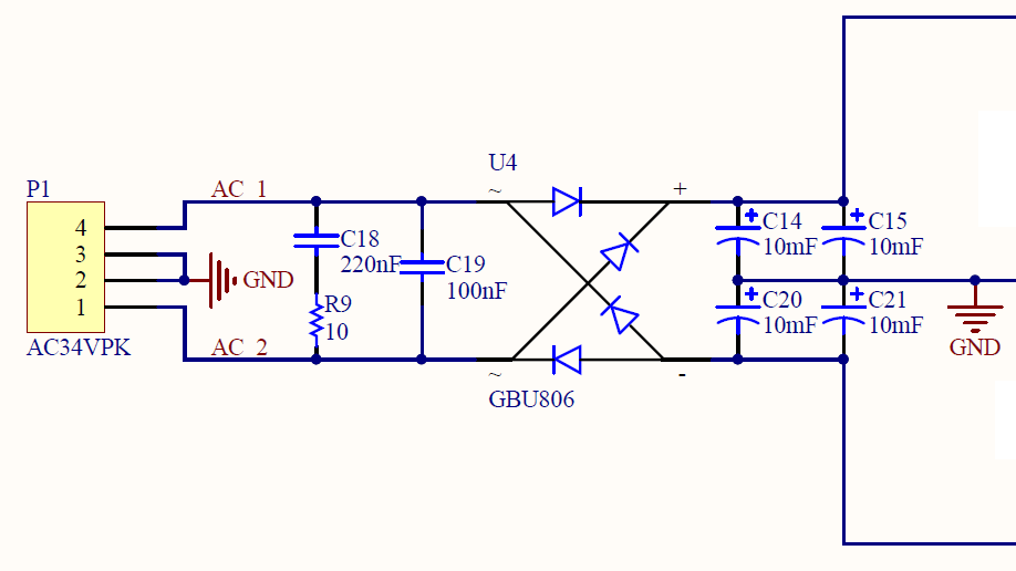

I will use this for my HPA ---->
View attachment hpa_psu_sch (2).pdf
THx-RNMarsh
THx-RNMarsh
Might want to install an RC noise filter between each zener reference diode and its output driver. I use those nifty 3-terminal Feedthru Caps that TDK makes for RF applications. Fortunately they sell feedthrus in values > 4 microfarads.
Parenthetical -- LT1210 wasn't around when Walt did the Audio Amateur "Regulators" article, i.e. 1995 -- it makes a good "rail driver" for PSRR measurement.
