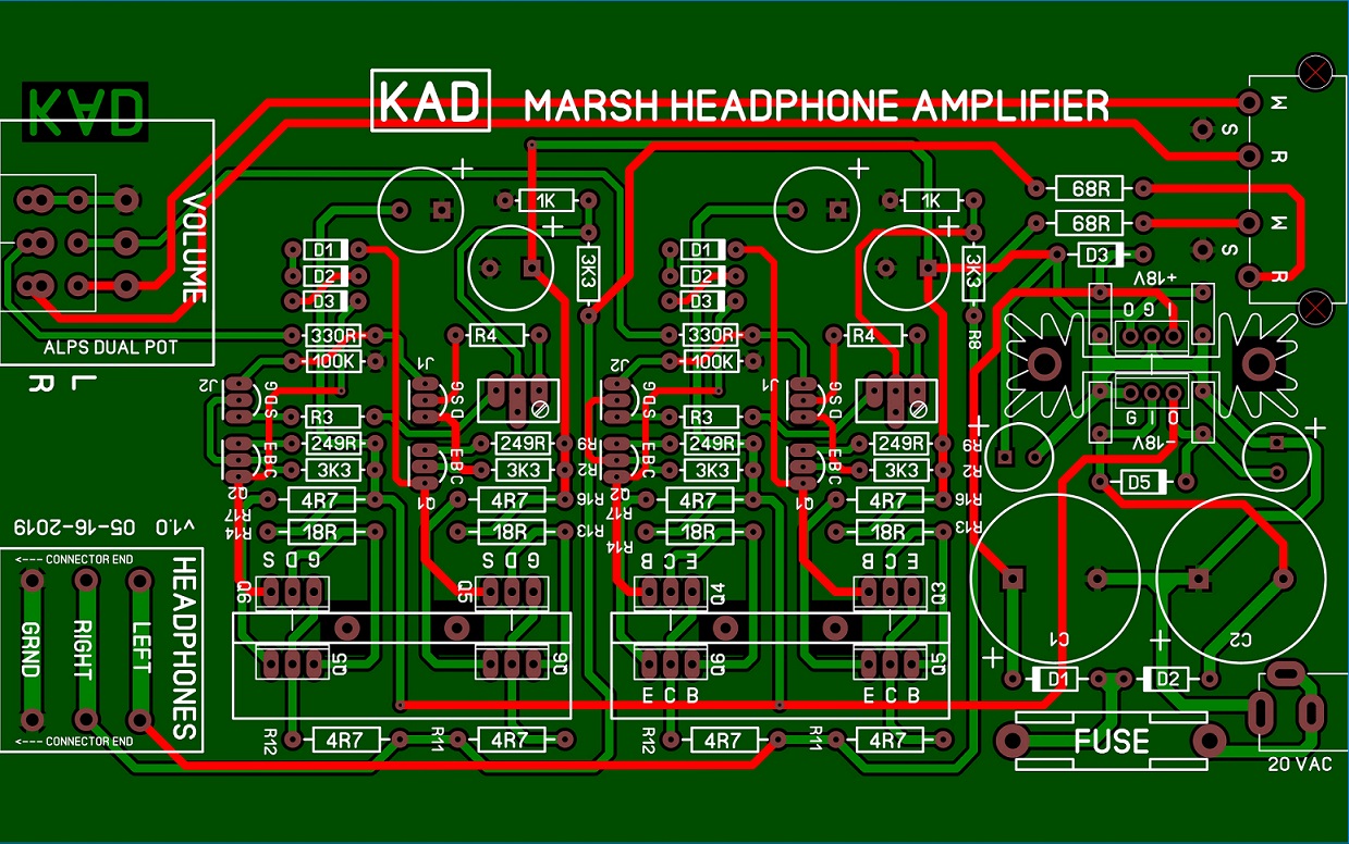

Does anyone have a pcb for this design?
I was thinking of making one, I will buy the article from LA.
I see that Mouser has all the semi's in thru hole.
I've been working on one. It is self contained with a wallwart power supply. I designed it to slip into a 100 x 160mm Hammond extruded aluminum enclosure. I haven't actually built one yet but expect to soon.
