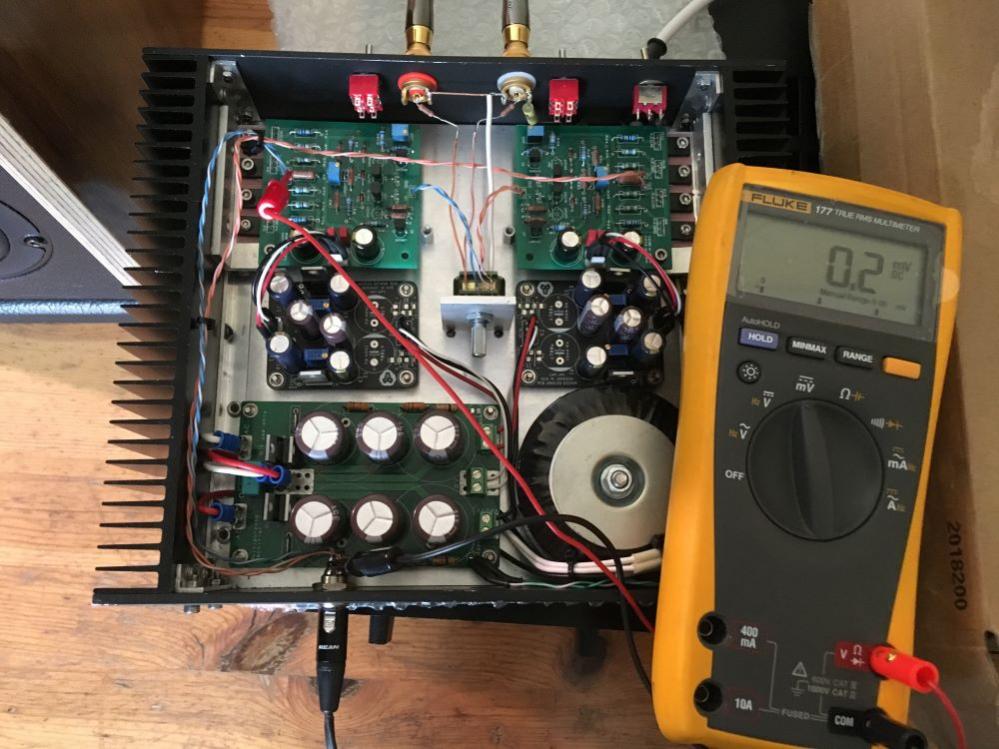

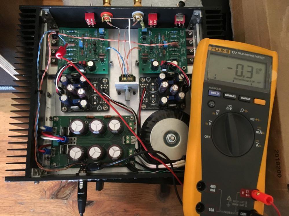

Been listening to the Marsh amp for a week now and can testify it sounds excellent.
Bias drifts slightly between -0.3mV - 0.5mV on each channel but generally very stable and running extremely cool, the 200mm heat sinks are way overkill it appears. Background is utterly silent, zero hiss or hum. No THD measurements yet unfortunately.
Headphones are AKG712 @ 62ohm/105db and Focal Elear @ 80ohm/104db.
The Juma / Prasi Cap Multipliers are working perfectly and highly recommended, very simple and versatile. Rails are at +/-18.5V
Big thanks to Jack for the kit and help and of course to Dr Marsh for a cracking DIY amp. Good job...
