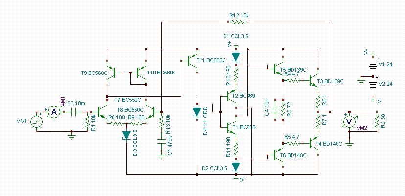

OK, if we're playing around with headphone amps, I really don't see a need for more than 6dB of gain. Unity gain would be fine actually. This one has 2.7x10^-5% (0.000027%) distortion @1kHz, 990mVrms into 30 ohms with 6dB of gain. It's nothing fancy. DC offset on the output is less than 1mV (730uv). Bandwidth shows a very mild bump @ 10MHz. No biggie in my opinion.

Here is a good place to start, look at figure 2, tweak it, make the output a cfp, bias the output hot, 100 ma or even more, mje172 series is excellent for the job, its not not too difficult to get .001 thd into 30ohms ( depends much on output bias current. Use hig beta input transistors to get high input impedance like bc550 series and bigger caps like 2200 uf 😉 One you have in simmed and seen the in and outs you can add simple features that will make it even better.
No 18 transistors needed 😀😀😀
Seems you dont need much help, you have the right idea, thats one way to go about it, its pretty simple reaching the figures mentioned here with headphone amps.

OK - forget about LA: posting to diyaudio a working circuit that's not pretty basic stuff for those in the art will be fine too (and I'm afraid DB, VF topologies with DB output buffer and the like * do are * pretty basic stuff for almost everyone here...). Nothing miracolous about RN's amplifier - do not have the last LA issue on my desk, but from what I've seen (and read) it seems only a well engineered simple and clever circuit that works really fine: something different from the same old discrete VF power opamp, which is one of the reasons why I'd give it a try. It's probably nor the best neither the worst way to do a headphone amp, but simply one of the ways to do it - I went for a crazy CF open-loop topology, other guys may well go for something entrirely different: there's more than...

Jaha! The buffer shown earlier in this thread is just a beefed up version of the one shown in your link at the bottom of the page.

Oh I have , I took that circuit and gave it much better performance. At solidstate there is currently two designs being developed around the basic scheme as shown and those involved love it, see TSSA thread. Funny how after all the years nothing as simple and good performing has come up and how many are only now discovering it.
