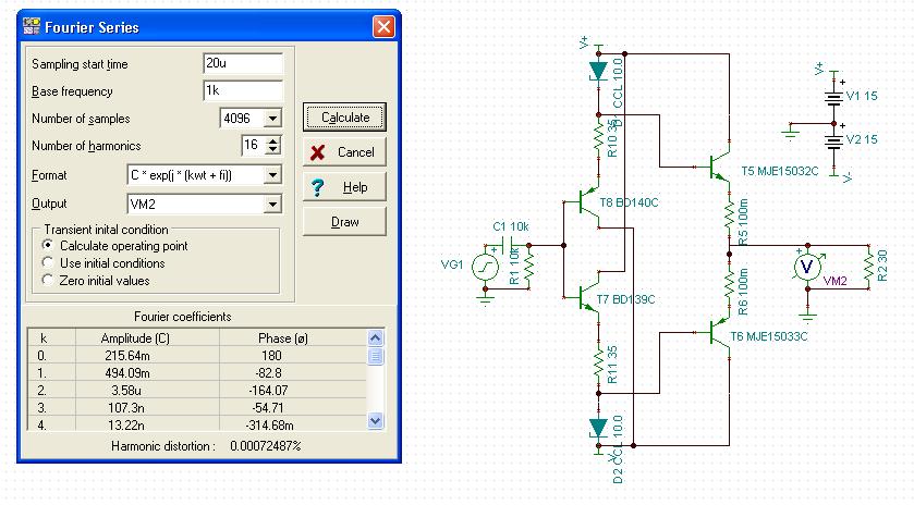

Guys, we're talking about an open-loop small-power buffer capable of 0.001% THD into 30 ohm - it seems there's quite a lot of good engineering behind these figures...
L.
So, is 0.0007% good enough? Four transistors and two diodes (which may count as transistors since they are CRD's). Since there is no loop feedback to reduce the output impedance, then you really have to juice it up to get a low enough impedance to drive 30 ohms at low distortion. Output level is 731mV rms. At 1V rms output, distortion goes up to 0.001%. This is across 30 ohms of course, as you wanted. These are Mr. Cordell's transistor spice models, btw.
Now run a variation of parameters.
Nah, you can do that. Go ahead. You're not my boss.
