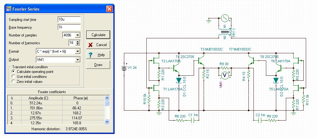

OK, if we're playing around with headphone amps, I really don't see a need for more than 6dB of gain. Unity gain would be fine actually. This one has 2.7x10^-5% (0.000027%) distortion @1kHz, 990mVrms into 30 ohms with 6dB of gain. It's nothing fancy. DC offset on the output is less than 1mV (730uv). Bandwidth shows a very mild bump @ 10MHz. No biggie in my opinion.
Boy, its like pulling teeth here.... I am into optimizing a given circuit topology right now.... like in LA..... can you redo this one without C1 and C3 and still have no drift and offset issues (at 12db gain)? Thx - RNM
Some of us are into optimizing a circuit, some of us want to argue about the meaning of "maybe not" and others just want to do other things I guess. It's no problem.
For that circuit, to eliminate the input coupling cap would require going to jfet inputs with gates referenced to ground I think. To eliminate the cap in the feedback loop would increase the DC offset on the output. I didn't know these were your goals, sorry! I just threw it out as an example of what's possible, not that it's better than your circuit or anything. I'm sure yours is super good since you have far more experience than I do at this.
This is in the spirit of "look what I did!", and not anything like "I'm better than you" or something like that.
I was fooling around with SRPP follower bridge circuits and did this one. I think it's pretty cool. Eight transistors if you don't count the CRD. The only downside I can see is the need for a really big capacitor in the feedback circuit and monster heatsinks on the outputs. Bandwidth and phase response are really nice according to the simulation in Tina. If I didn't have to drive 30 ohms I could get away with 6 transistors. Dang, pretty cool I think.
Output is 990mV rms into 30 ohms @ 1kHz. Distortion is very low, as you can see.

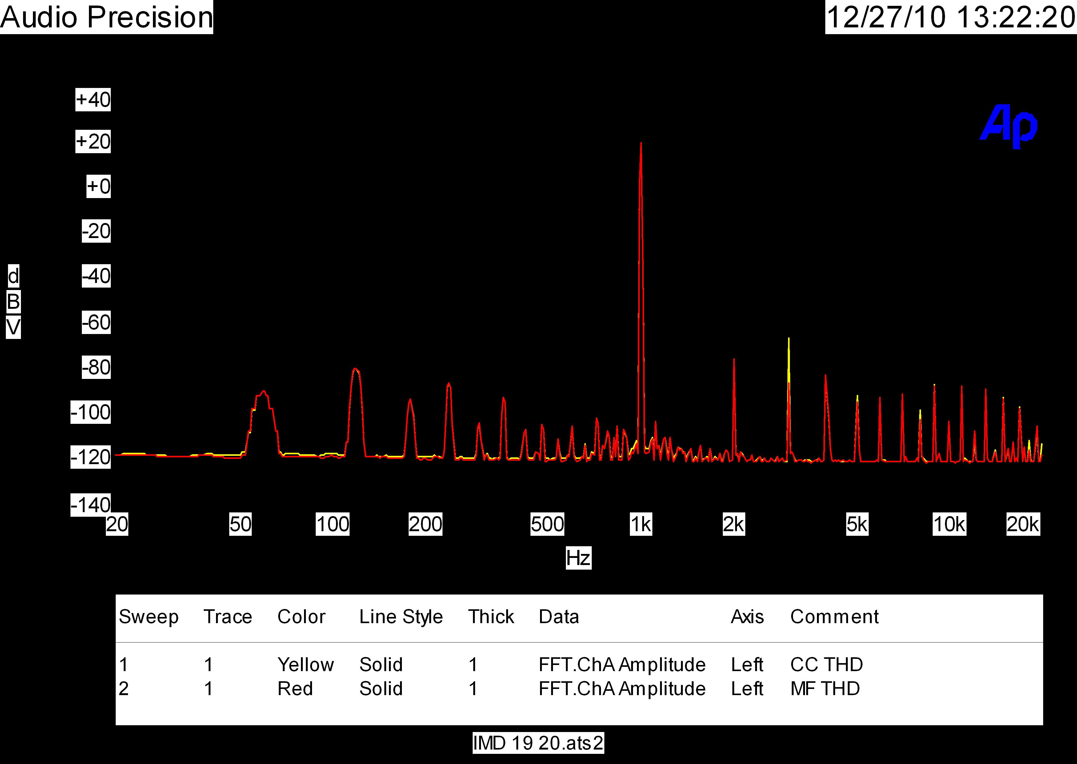

Actually I have been doing a bit showing that thermal mistracking can result in distortions that may be missed by some measurements.
Attached are things I have shown before. A distortion comparison of a carbon composition resistor compared to a metal film type of the same value, tolerance and wattage. With a THD measurement they are very close. With an IM measurement at 50Hz and 2 KHz they show differences. That is because the 50Hz is doing more cyclical heating of the resistors.
With a THD measurement at 50Hz they are not close. You don't even need to perform the IM test the thirds on the 50Hz in the left plot can be used to compute the IM sidebands on the second frequency. It is not an accurate blanket statement that "there are things that show up in an IM test that don't in a THD test". This relates to what you asked yesterday.
You need to be more careful in stating all the conditions.
As I mentioned long ago the phase of the sidebands could probably be used to separate the thermal from voltage effects.
EDIT - On second thought the thirds in the second plot don't look very close at all.
Scott,
Yes, I forgot to mention what we are looking at is the distortion of the same amplifier with the only difference being the feedback resistors.
The sidebands are not exactly what I expected from just the THD plots. In addition to the distortion difference in the two plots the amplifier also behaves a small bit differently. (As you can see the "noise" level has shifted!) So this is not a true resistor vs resistor comparison.
