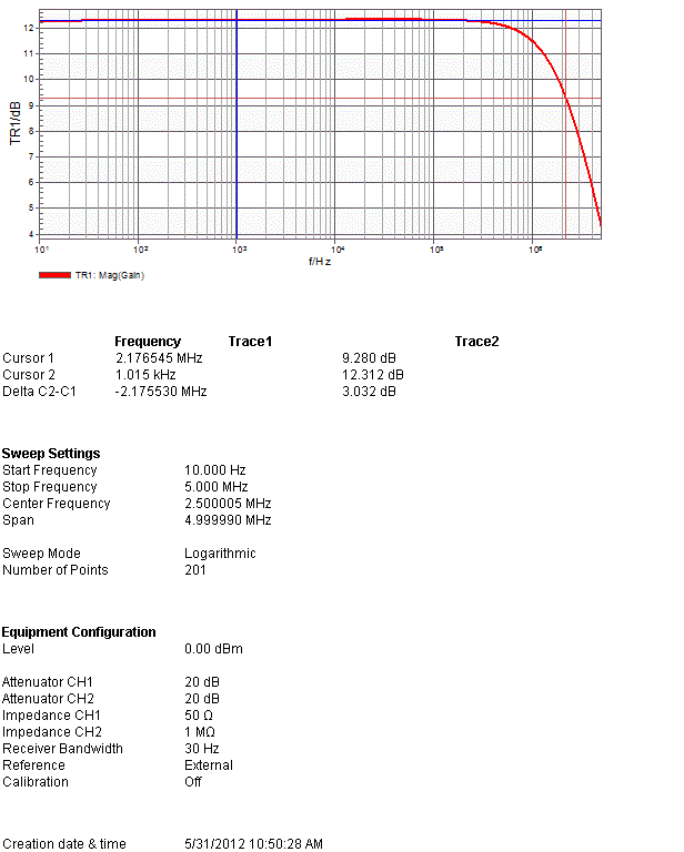

Speaking of output transistors -- the MJE200/210 hfe will vary from ~150 to 210. I found that the 2sb649ac/2sd669ac varied somewhat less. These have a higher ft than the On-Semi devices.
I think that the -3dB bandwidth which Richard stated in the article (25kHz) is extremely conservative as mine goes out quite a way...
Are you refering to Open Loop BW? That 25kHz was for Open-loop BW.
