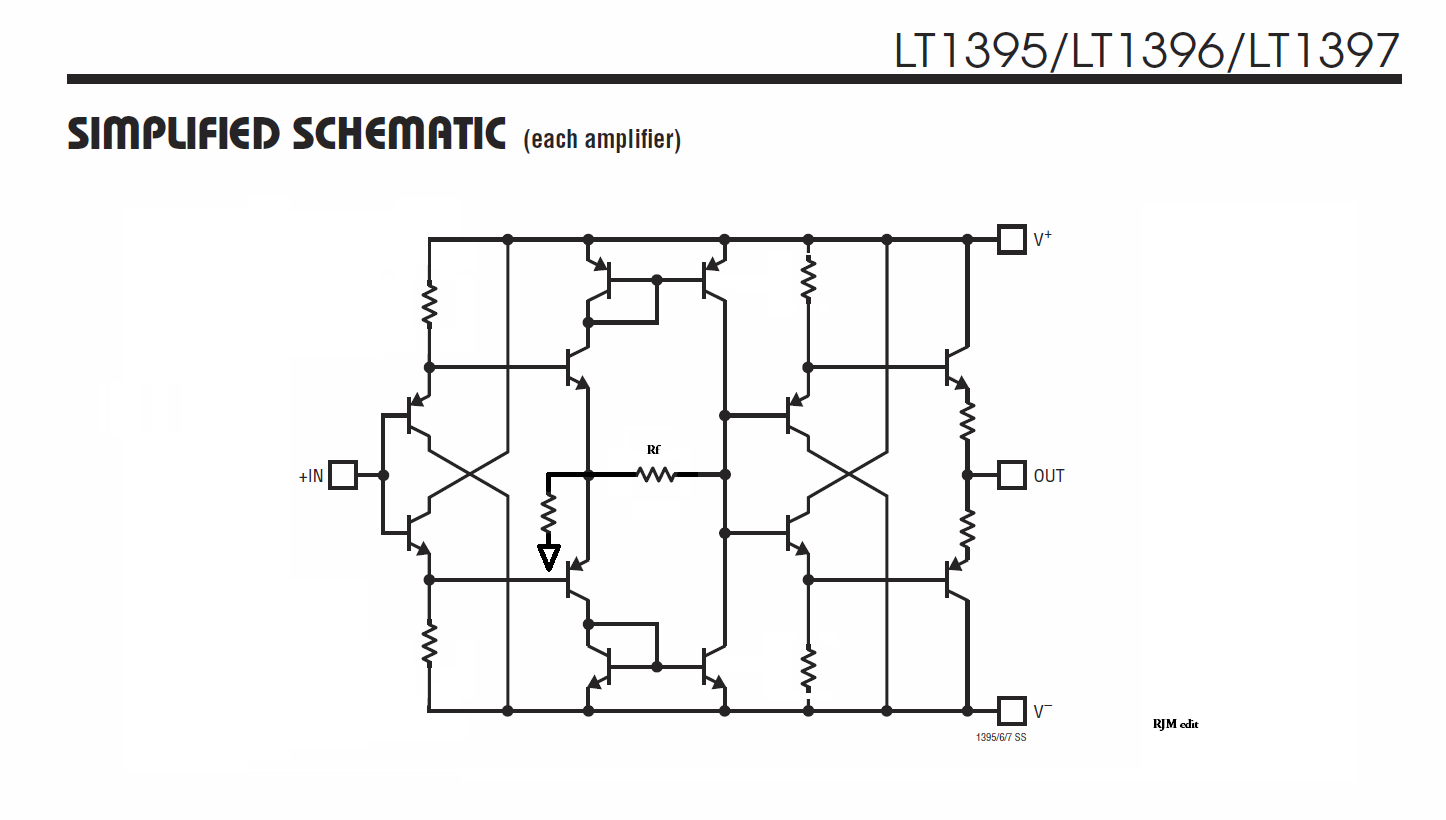

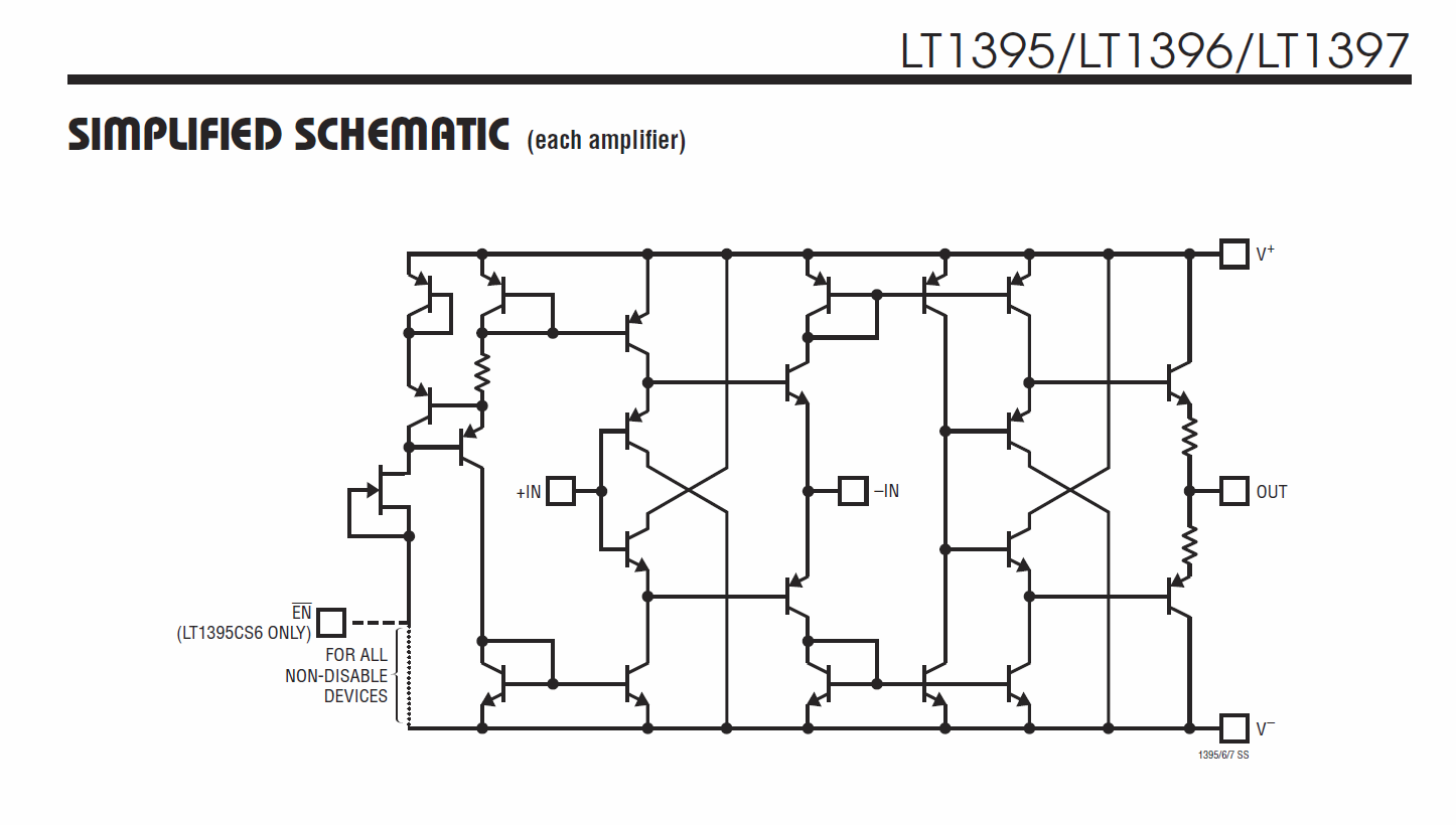

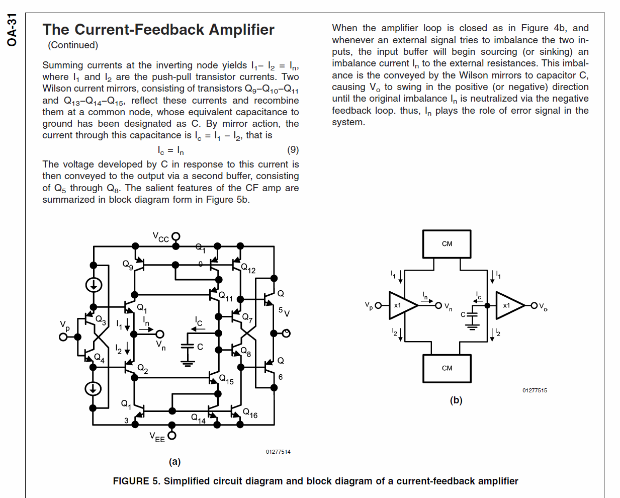

It's a variation on a theme I catch a glimpse of from time to time, but I've never tracked it down to any comprehensive source. Can you give me a little bit of background on it?
Hi rjm - if a comprehensive source of information about CF architectures exists at all, I haven't found it yet 🙁. My starting point were the Sergio Franco's chapter on CF Amplifiers in Analog Circuit Design - Art, Science and Personalities by Jim Williams, and an old (1994) article by Smith, Koen and Witulski: Evolution of High-Speed Operational Amplfier Architectures - imho both are worth a thorough read. You can find the very same topology (or a quite similar one) in a number of DSs/ANs by National (OA-31), Linear (LT1228, LT1395) and ADI (AD844) - it seems a well established and good performing architecture, and it works very well indeed even with discretes.
L.
@coluke
Thanks for the numerous resources! It's interesting (and impressive) that you worked from "scratch", that is, developed your amplifier circuit from non-audio specific references. I had hoped that there might be line of experience for dealing with these circuits in audio applications, where stability under non-ideal loads, rather than ultra-high bandwidth weighs more heavily on the designer's mind...
(all I found so far was this.)
@rjm - as far as I know only Accuphase and Marantz are employing (or have employed) CF topologies in their commercial products, but mainly in preamplifiers. Accuphase's architecture (see the first attachment) is pretty standard (a few old CF opamp by National are based on it), simple and straightforward, and I have indeed verified it works very well using it in a small power wide-BW class AB output buffer for testing purpose (it is capable of almost 20 Vpp into 50 ohm up to 1 MHz with low THD), but if open-loop linearity and gain are of paramount importance then current mirrors in the transimpedance stage are needed - open loop performances of the DB-CM-DB architecture are quite amazing 😱
