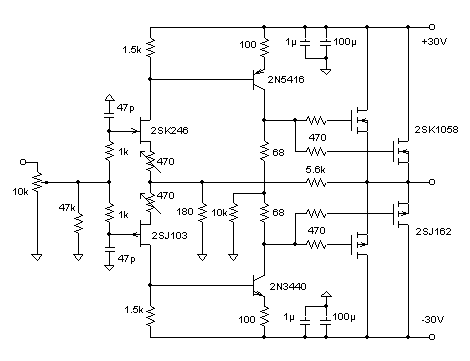

I meant to use a single differential, like done here:
PRE4 N-JFET preamplifier
very nice and a possible contender -- schematic somewhere?

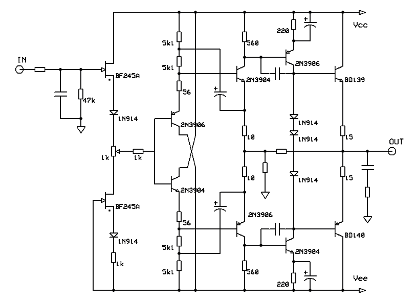

Well, I know I'm not going to win the Glenlivet bottle, nevertheless this simple CFA almost meets Richard's requirements. Beware: I'm talking about simmed figures (with Cordell's models) - still have to try it to see if it works that well even with real components.
1. about 60 dB loop gain up to 20 kHz or so
2. 0.0013% THD from 20 Hz up to 20 kHz @ 1 Vrms into 30 ohm
3. only a couple of bootstrap caps, and another couple to bypass transimpedance emitters stage (needed to keep OLG high)
4. DC offset and drift good (although not amazing) even with pure DC coupling and no servo
5. Aargh! 10 active components...🙁
6. about -110 dB of S/N ref 1 Vrms out - could probably be improved employing low noise BJTs
7. harmonics above 3rd are < -140 dBc @ 1 Vrms into 30 ohm
8. closed loop gain 12 dB
9. Zout < 10 milliohm (approx)
10 . so it seems
11. ultra low cost parts, and quite easy to obtain
Needs further development, but it seems promising (and it could drive low Z headphones, too... 😀).
unfortunately not public (and I dont have it).
