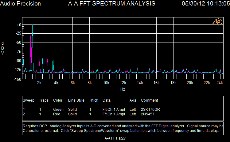

If you can't find 2N5457
2SK170GR will work, although as RNM points out these large-geometry devices have non-linear capacitance issues. 2SK170GR is available at Mouser, and the devices are DGS, not DSG as the 2N5457.
The prior FFT I posted was 1V out with Z=250R, the one below is Z=33R showing a comparison with the 2SK170GR and 2N5457
Using worst case load (33 Ohms) shows the 2nd and 3rd harmonics are in the neighborhood of -90 or under .01% that I said in the article you would get if you did not match transistor compliments. But with matching you can get well below -100. Thx for trying various devices for the DIY-er who might not find the ones I used.... however, I bought all transistors over the Internet for 10-15 cents each. It appears the topology is pretty immune to the specific transistor part..... another plus. -RNM
