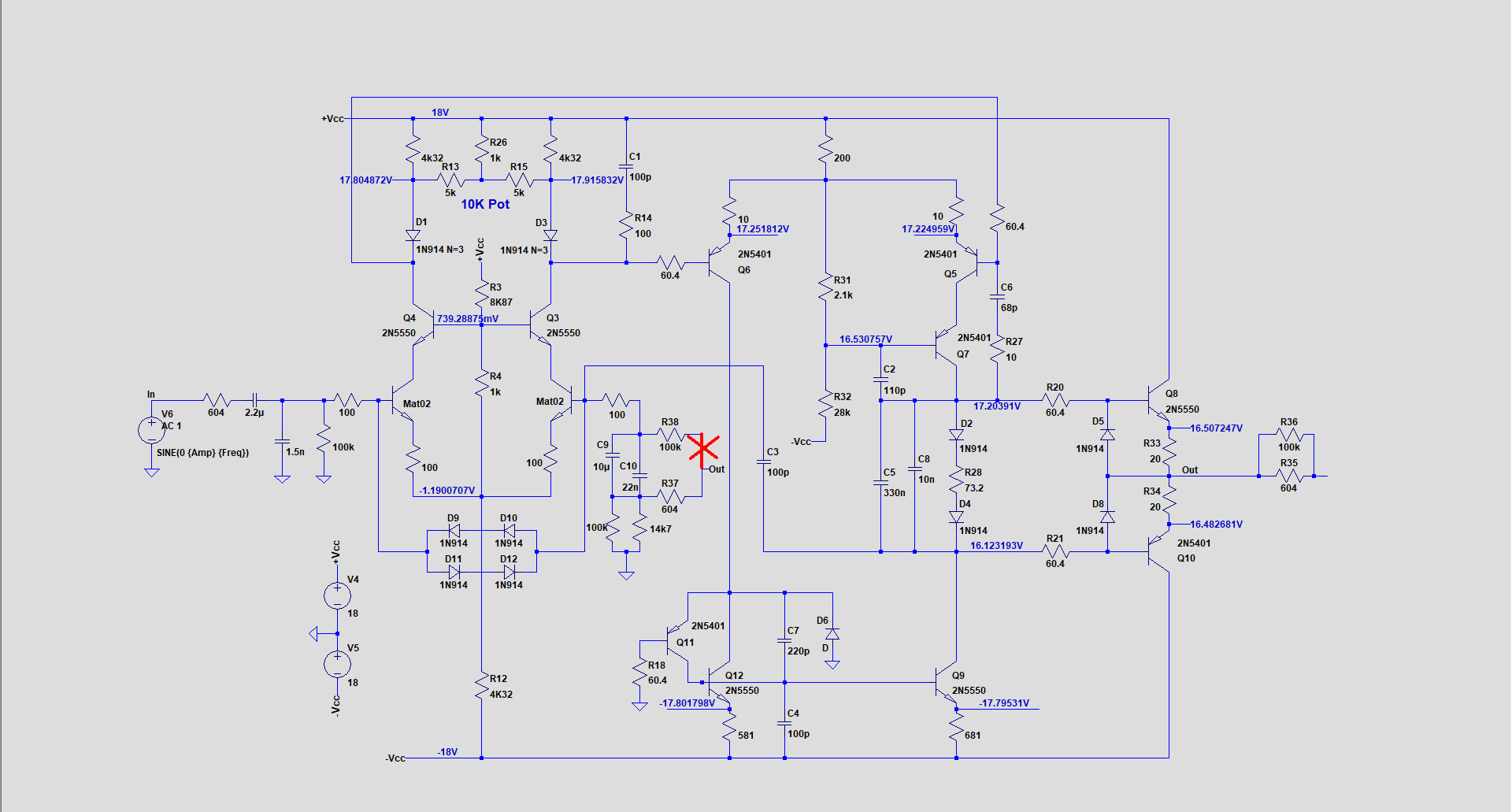

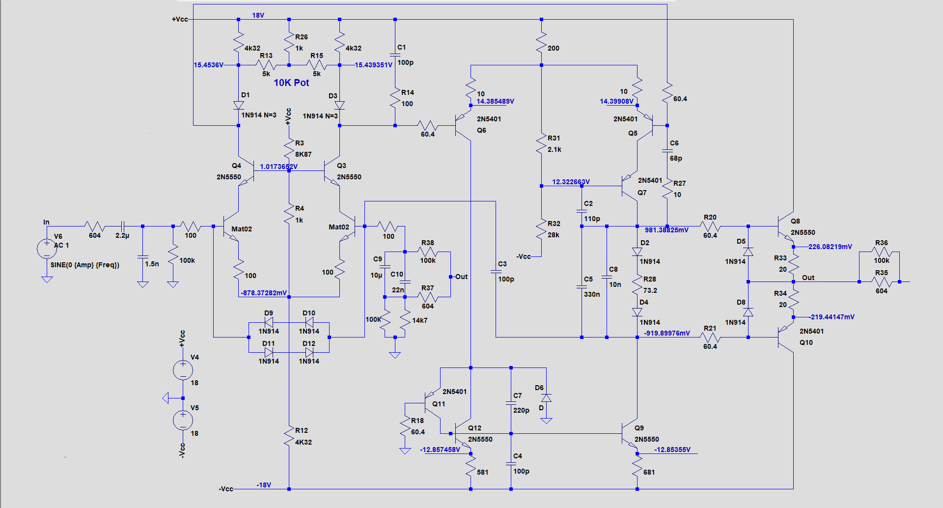

I've put your invert amp in to LTSpice, don't worry I like doing these things.
See below the circuit diagram with everything O.K. and all voltages you should see in your amp.
Second image shows what you have with the voltages that you reported.
Most likely is that the collector of your LM394 is interrupted, or the trace to the Q102, the 2N5089 or it's emitter.
Hans

is it normal that the inverting input still functions (i.e. I can see the AC signal on 14K7 while playing music)?
One more question, why there is some DC leaking to the LS output at cold? If the 10uF cap is unlikely to be faulty, could it be the 0.022 PP yellow cap that is in parallel with it?
Yes, a signal will still come out, but distorted.
What exactly do you mean with DC leaking out to the LS output, is it the offset voltage of a few mV that you refer to ?
Anyhow, the 10uF // 22nF are just there to give the amp a gain of 1 at DC, while going to 25 at AC.
So with a gain of 1, the input ofset is only amplified by 1 instead of 25.
Don’t you worry about these caps as long as the LS DC voltage is in the mV range.
Hans
By the way, I tested and matched Q102 before mounting it, and I check every solder joint with a strong magnifier, so unless Q102 got damaged during soldering, LM394 should be the most likely cause.
Transistors normally don’t get damaged during soldering.
However, after having removed the LM394, you still have to check whether the collector is interupted.
Very simple to measure, from base to emitter and from base to collector you should see a diode with your multimeter.
Hans

The old germanium transistors definitely did get damaged during soldering at they were rated for 70C or so, but silicon is way more robust, max junction temps are usually in the 175C or higher range. You'd have to really try to damage it, say by using a brûlée torch rather than an iron!
That’s very strange and frustrating, but the upper board had to be removed anyway.
Are the LM394 diode voltages between left and right absolutely identical ?
I’ll try to molest other parts in the simulation model to get the same anomaly.
You mentioned yesterday that by alternatively shorting the green circles, the other side remained at zero volt, true ?
Hans

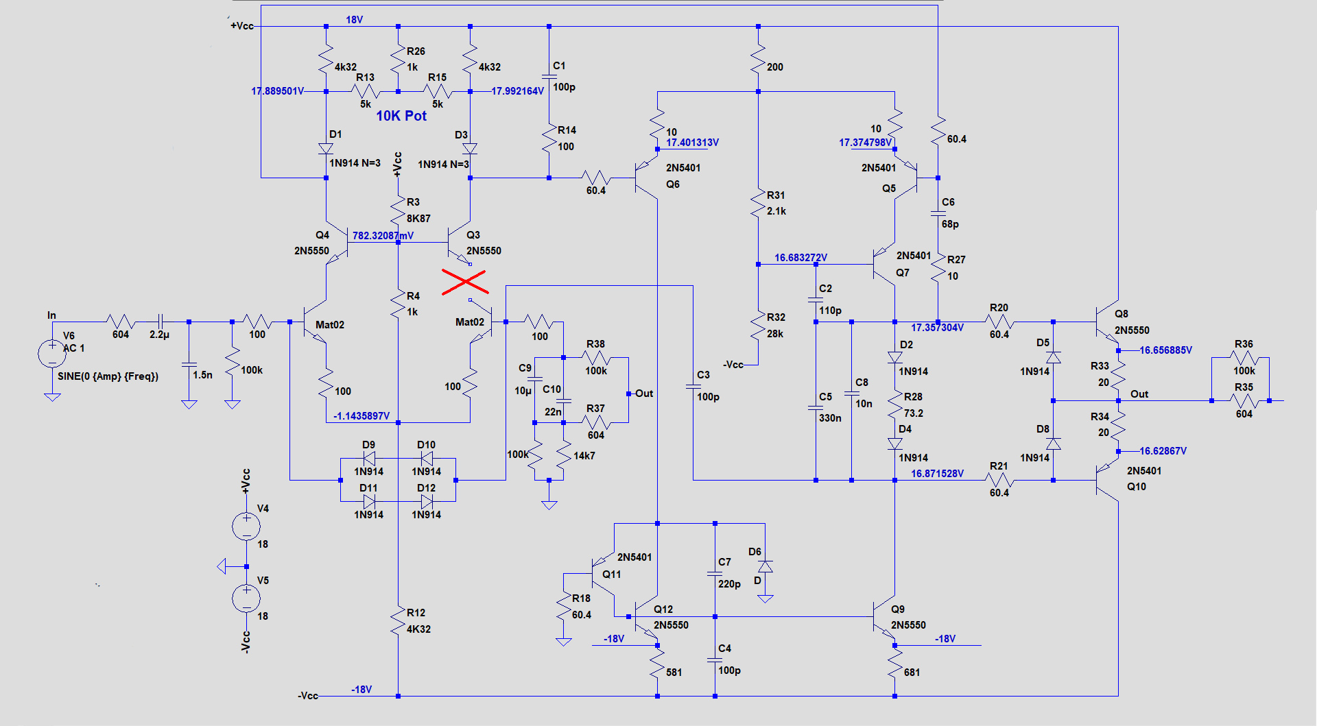

Here's another interruption causing the same problem.
The 100K feedback resistor, or even the 100R resistor going to the base, causing the feedback loop to being broken.
Hans

Yes, the voltages are similar in the two sides of LM394, although not as close as would have thought. Vbe difference is 5mV between the two sides. The difference in diode voltage between base and collector is 20mV, but I don't think it is important.
Maybe a small circuit can be built to test the LM394 in circuit?
Hans
Let me check this. It could be an issue because in this area there is the add on PCB update implementation where the 470uF cap and 1n4936 diode from the main board get soldered to these resistors thorugh a hole on the upper PCB. Not a neat job and some connection could be defective here.
I measured one example:
Be aware that between base and emitter there are two opposite diodes, one for protection that is less important.
What I measured:
Left:
Vbe 738mV reverse 910mV
Vce 750mV
Hfe629
Right:
Vbe 737mV reverse 905mV
Vce 751mV
Hfe 630
Hans
