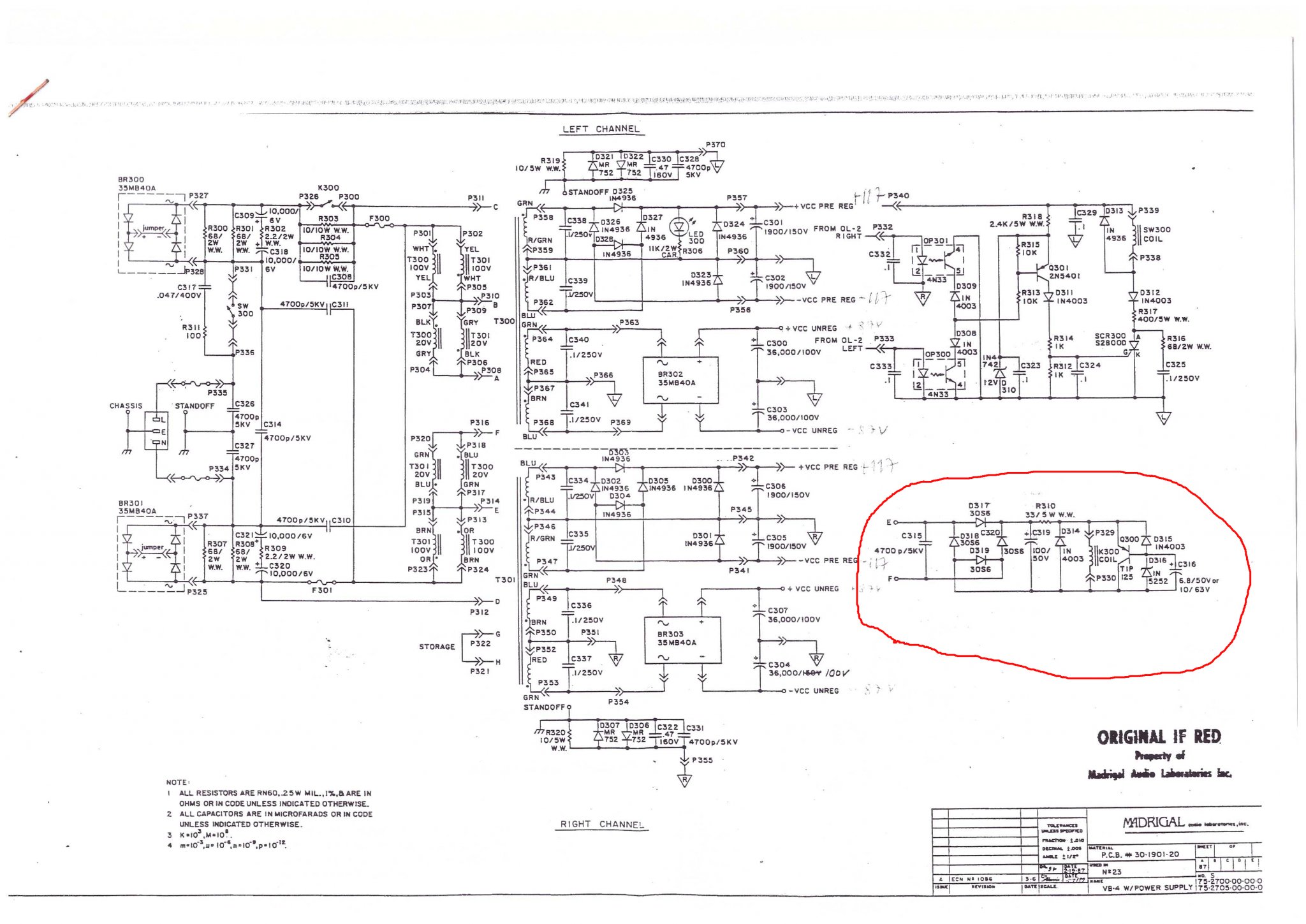

Anyway, by exclusion, other than the amp boards (that are not drawing excessive current), the transformers (that apparently have no excessive losses), and the rear boards (that I also tried disconnecting from the Vcc unreg line), other causes of excessive current draw can only be in the front panel circuit board right? So the relay circuit, or the DC blocking circuit right?
Yes I agree. The circle seems to narrowing down to the front panel circuit.
Hans
You also should have a look at the red encircled part of the circuit diagram.
This circuit is consuming power from the 20V windings.
In case one of the components is malfunctioning, it could draw a lot of current.
Hans

I started taking so more measurements but not yet finished. Mains voltage over P301-P324 is 219V. I tried replacing the relay with a jumper but that didn’t make much difference (a bit less current but not much).
Then I disconnected the primaries of the right amp and started measuring the left amp. Primary voltages are fine.
I then started measuring currents in and out of the rectifiers for the Vcc unreg and Vcc prereg lines.
For the Vcc unreg lines I calculate an efficiency of the bridge rectifiers of about 67%, whereas for the rectifier of the Vcc prereg lines I calculate an efficiency of 64%. It looks to me like the power loss is coming a bit from every bridge rectifier, at least for the left amp, so maybe replacing all of them would be beneficial?
Also, I just noticed, when measuring current out of the rectifiers I measured DC current (140mA as I posted yesterday), but now by mistake my meter was set to AC current on the -Vcc reg and read 300mA of AC current, does this have any meaning?
Some more precise numbers from the left amp (right transformer disconnected):
only Vcc prereg secondaries connected: 0,282mA from mains (~62W)
0,340mA AC from secondary (*168V =~ 57W)
0,140mA DC from rectifier (*110V = 15,4W , *2 = 30,8W)
So that should be about 50% efficiency, if those 300mA AC I measured on the Vcc prereg line don't matter
With all secondaries of the left transformer connected current draw from the mains is about 650-670mA
I remeasured current from the Vcc prereg lines, this time from the capacitor to the board. Still 140mA DC, no AC current present. So I guess my calculations on the bridge rectifier efficiency should be correct. What you think? Should I try replacing all the 1n4936 diodes in the rectifier and see if it makes a difference?

Ok. Meanwhile I also tested the other channel, disconnecting the primaries from the left transformer.
I have not yet measured all the secondaries, but so far I get the exact same measurements as the left channel:
650mA from mains with all secondaries connected;
330mA flowing through the 168V secondaries of the prereg lines when connected to the rectifier.
I also measured the secondary voltages and are ok, there are no voltage drops when connecting the secondaries compared to the unloaded measurements (actually just 1 V drop for the unreg secondaries, but that was with the amp cold so bias was probably 70-80mV).
I don’t really know how to interpret the results, seems like both channels are working symmetrically, but efficiency is really bad.

My idea after doing extensive reading these days is that it might just be a problem of low power factor, where the amp actually draws the correct amount of real power, but there a reactive power, that’s why so much AC current flowing. To make sure I bought a power meter which can also measure power factor. Maybe I will get it later today and can take the measurements.
Yes it’s exactly like this. I hooked up the power meter to the amp, with only one transformer connected, all secondaries and loads connected, bias at 275mA. Power consumed is 92W, about 620mA from the mains (it reads less current than my meter, probably not super accurate). the power factor is something like 0,67, explaining the discrepancy. I did a lot of reading and this power factor seems quite normal for a linear power supply with bridge rectifier and filter capacitors. As far as I understood there is nothing wrong with my amp or transformers. It seems weird however to me that you said you measured ~800mA from mains on other ML23.5 you worked on, which would mean a power factor of 1. I wonder if power factor can depend on the quality of line supply other than the equipment itself.
As far as the noisy transformer, since the noise is proportional to the current in the secondaries it seems that vibrations in the secondaries windings is the most likely cause, either they became loose or because there is too much current flowing. Also wonder if the 1260VA power tranformers can deliver the full output power, given the low power factor.
I still don’t exclude poor quality mains as a cause, especially since the waveform I see on the scope looks quite distorted. If the amp was lighter I would try it in other settings far from the city.
I really measure a power factor of 0.9 (not 1.0) all the time, just like your transformer shop confirmed.
In the end it seems to boil down to your transformers, since everything else is O.K.
So, when you are happy with the sound enjoy it and forget about the hum.

Do you mean that the transformers are causing the low power factor? Or just that they are noisy?
Yes I’m happy with the sound and the noise is not at all bothering, as far as the amp is working correctly.
I think I answered the question myself. I connected a purely resistive load to on of the secondaries of the transformer and get a power factor of 0,99 as expected by a transformer. The power factor decreases when connecting the bridge rectifier and filter capacitors. Since the components are all new, and the circuit design should have a higher power factor, as you observed, what could be the problem?
After doing some more tests I see the problem seem to be caused by the big filter capacitors, if I connect a load to the bridge rectifier, excluding the filter capacitors, the transformers are dead quiet and the power factor is 0,9.
I wonder if there is a solution to this, or if it’s just poor quality transformers causing this.
