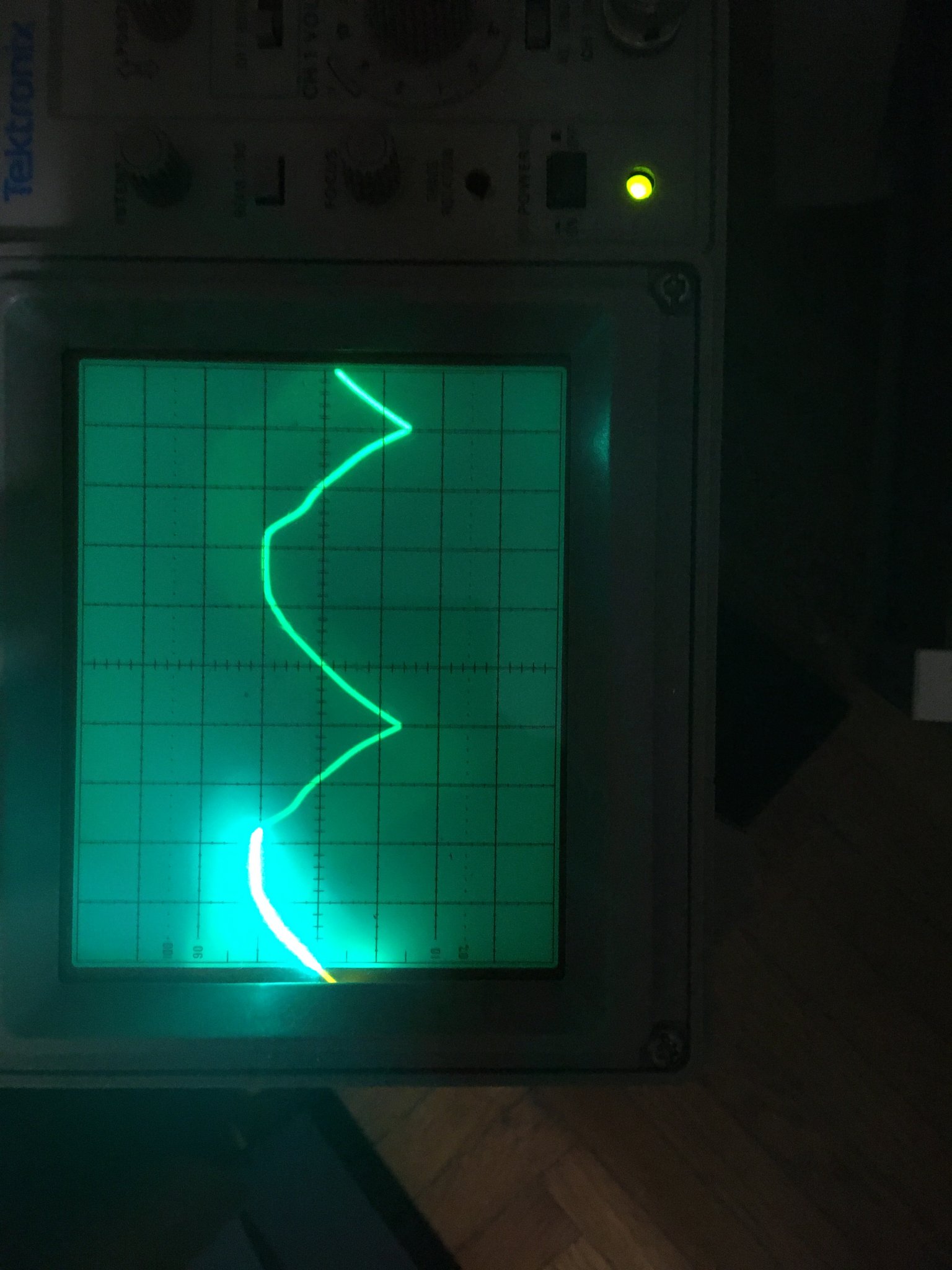

Also, I was looking with the scope at the waveforms on the rectified lines (with and without filter caps connected), and I noticed that the AC waveform is quite distorted (I think from the mains), see the attached picture. I don't know if it is within "normal" real world conditions or if it is enough to make the transformers hum.

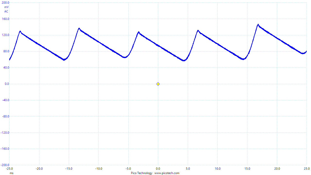

The trace on your scope however looks rather weird, it should show a slow linear decay and a fast recover.
Could you measure the VCC Unreg with your scope on the big cap, it should have a waveform like in the attachment.
With 100Hz, 300mA, 36,000uF and I=C*du/dt, decay should be ca 83mV.
The the 83.7V volt that you mention is on the low side.
So could you measure your mains voltage and the voltage between P301 and P323.
Hans

No the picture I attached is without the filter caps connected, so it’s showing the rectified “sine wave”, but looks rather distorted.
With the filter caps connected it looks how it should be.
Mains voltage is 220V. Are you sure 83,7V is low for the Vcc unreg for the ML23.5? That is with the amp boards mounted and the amp at idle.
