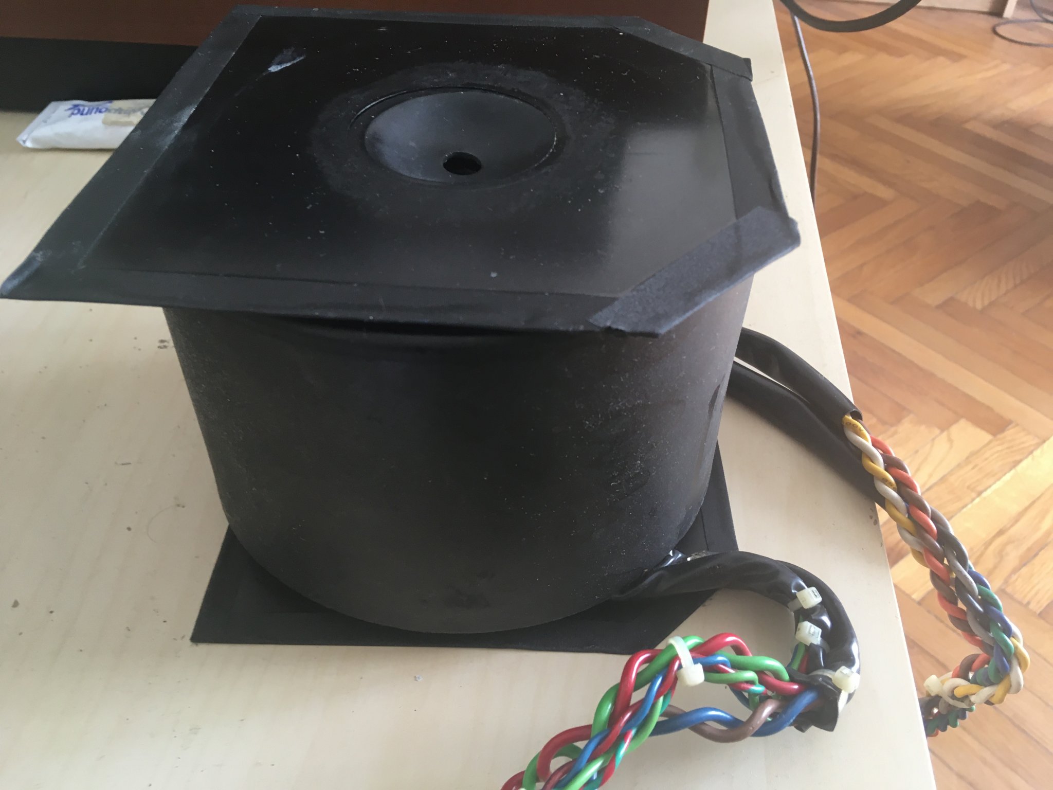

Ok, I will remove them and take them to repair. Since I cannot find the specs, aside from the primary voltages and rectified voltages, and the fact that they should be 1258VA each, do you have other information to rebuild them as close to the original as possible? Or they should be able to reverse engineer them at the laboratory?That would indeed be the best option to take them out both. As you say, they have to be exactly the same.

The tranformer shop should be able to reconstruct the amount of winding, most likely by counting them.Ok, I will remove them and take them to repair. Since I cannot find the specs, aside from the primary voltages and rectified voltages, and the fact that they should be 1258VA each, do you have other information to rebuild them as close to the original as possible? Or they should be able to reverse engineer them at the laboratory?

To be honest, they look different from what I have seen so far.Here are my transformers, do they look original to you? View attachment 1060170
But ML may have used products from different suppliers.

Yes I have only seen two different types, the black ones non-encased that look identical to the ones of the ML23, and in later models I see the plitron silver-coloured. Mine are in this plastic case and are potted. I don’t think they have been replaced, but who knows maybe it was a different (inferior?) supplier they used for some time during production.To be honest, they look different from what I have seen so far.

I also noticed something weird when disassembling them, the bracket holding the posterior transformer is held to the chassis with three screws, the middle one is longer towards the inside and a rubber foot is placed loose upside down on the screw thread, the transformer then resting on the foot. It looks original from production, but definitely a bit messy. I also see on pictures of the bottom of the chassis from the internet that this screw look different from the others, so it may be how they used to assemble the amps.
Having both transformers separated from the amp and from each other, you could connect the four 100Volt and the 20Volt windings in series (carefully in the right direction), connect it in this 240Volt setup to mains and measure how much current they draw from mains in this unloaded situation.Yes I have only seen two different types, the black ones non-encased that look identical to the ones of the ML23, and in later models I see the plitron silver-coloured. Mine are in this plastic case and are potted. I don’t think they have been replaced, but who knows maybe it was a different (inferior?) supplier they used for some time during production.

Then measure the voltage over the four primary windings and over the secondary windings.
This will most likely tell you what’s wrong and which transformer is not o.k.

Thanks Hans, but I already brought them to the shop. They will test them and get back to me tomorrow.In case the above is not giving conclusive information, you could directly connect a 220V/100Watt bulb to Vcc Unreg ( green and blue) and repeat the measurements.

I heard back from the transformer shop. They tested thoroughly both transformers and they say they measure equally good. They exclude internal shorts and/or other malfunctioning, and discouraged me from undergoing the rebuild. The problem must be somewhere else then.
They suggested me to check the transformer wiring since a few had the insulation damaged by the soldering iron during prior repair. I did notice that but concluded there was no risk of shorts, I will check more carefully and insulate with heat shrink if necessary. Other things to check? Should I check the current draw of all 8 rails?
