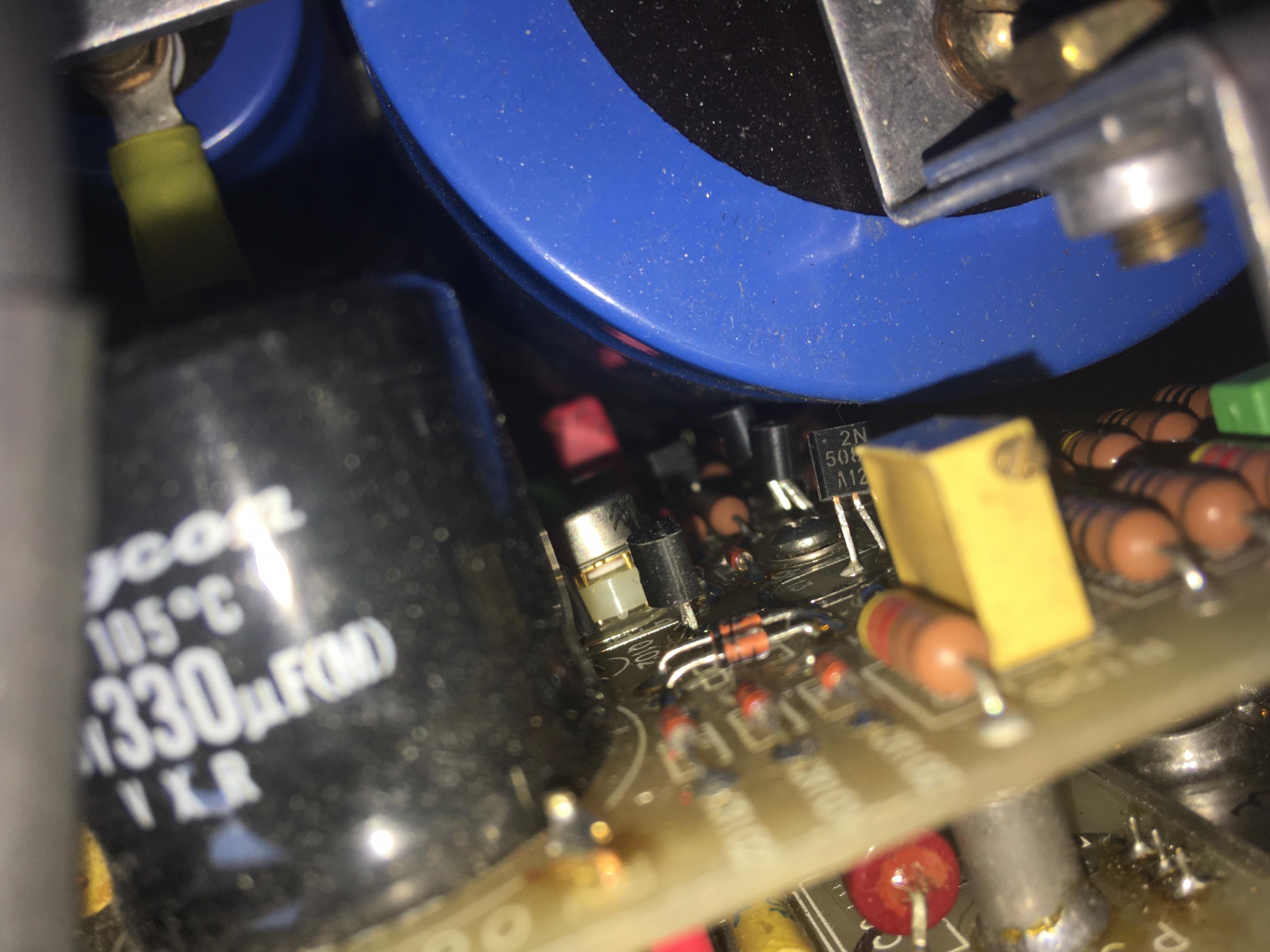

Hahah thanks Hans. But I would be more cautious and wait at least a few days before celebrating.
Funny enough I found a pre-restoration picture where the black cable was in the same exact position, so if the problem was caused by mechanical stress on the Wima capacitor it makes sense that the popping noise was present before the restoration as well. Also, since the 0.33uF Wima capacitor is in parallel with the green one, it makes sense that if it was the cause, it produced the same issue as in your case with the failing green cap, right?
Well, after one week no pops, so I closed everything back and it’s working great. It was tough to close it properly though, that cable really wanted to go and get stuck between the two capacitors.
When I first heard the pops I was desperate as I thought I would have been nearly impossible to find the cause but I was lucky enough that the problem was evident o simple inspection.
