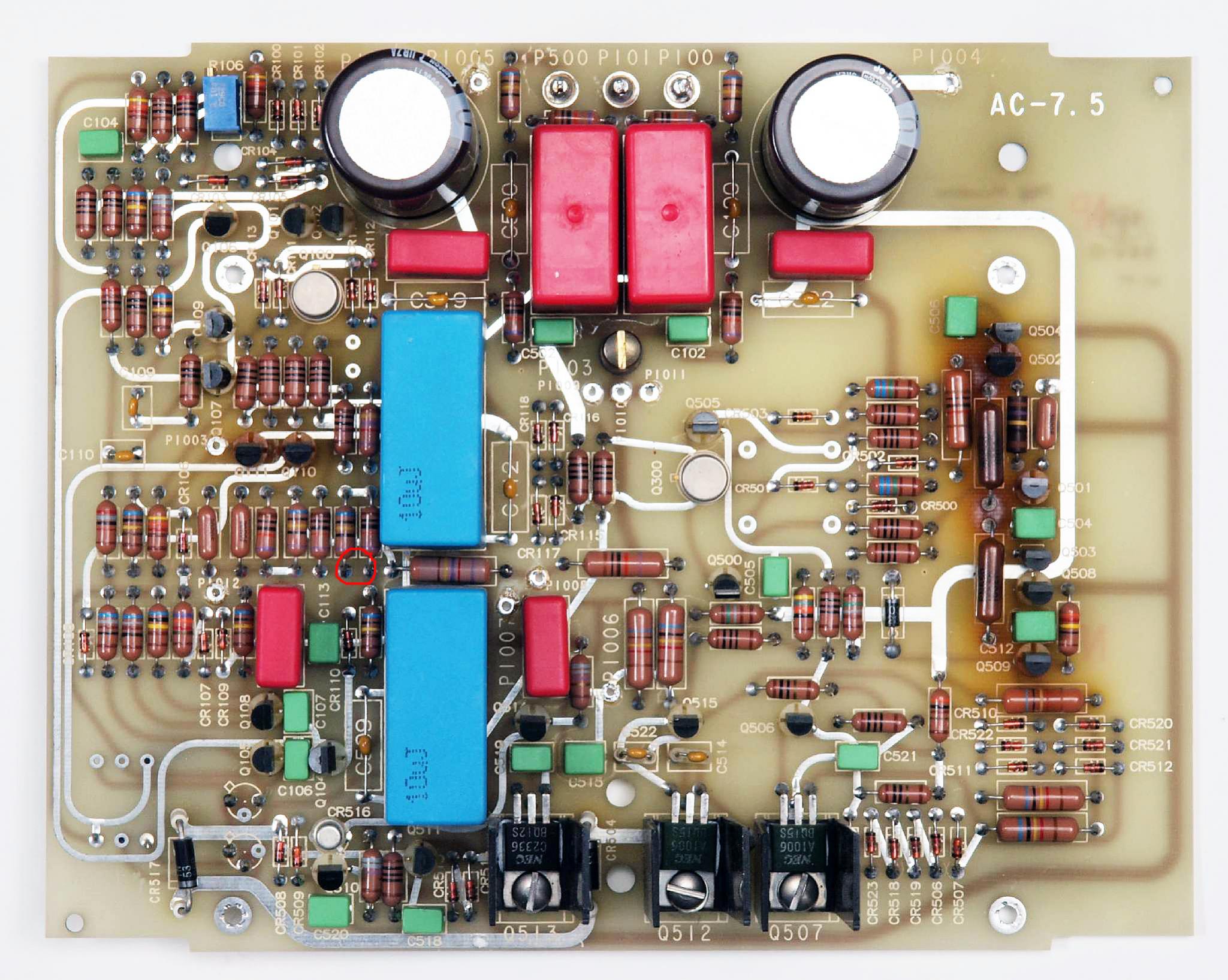

Hi Stefan,
Sorry to hear you are still having trouble.
What you experience can be anything that can die, transistors, caps or whatever.
The times I had such problems, it turned out to be Wima polyester caps in the Vreg part on the top PCB causing these pops.
The problem though is that it is very difficult to find when popping happens only now and then.
I can set my scope on triggering on a pulse and storing one event. That way I can find my way back to find the cause.
Without it will be difficult.
What about the TO3 transistor that measured so strange, was it indeed your multimeter or is the part not o.k. after all ?
But to start with, you could detach the output of the inverting amp to make sure the pop is not coming from this part, but you better use a cheap LS.
this can be done by removing one side of the 604R//100K resistors and connecting these two to gnd, see image.
When this doesn't stop the popping it excludes this part from the list.
I can probably give you some other tests, but try this one first.
Hans

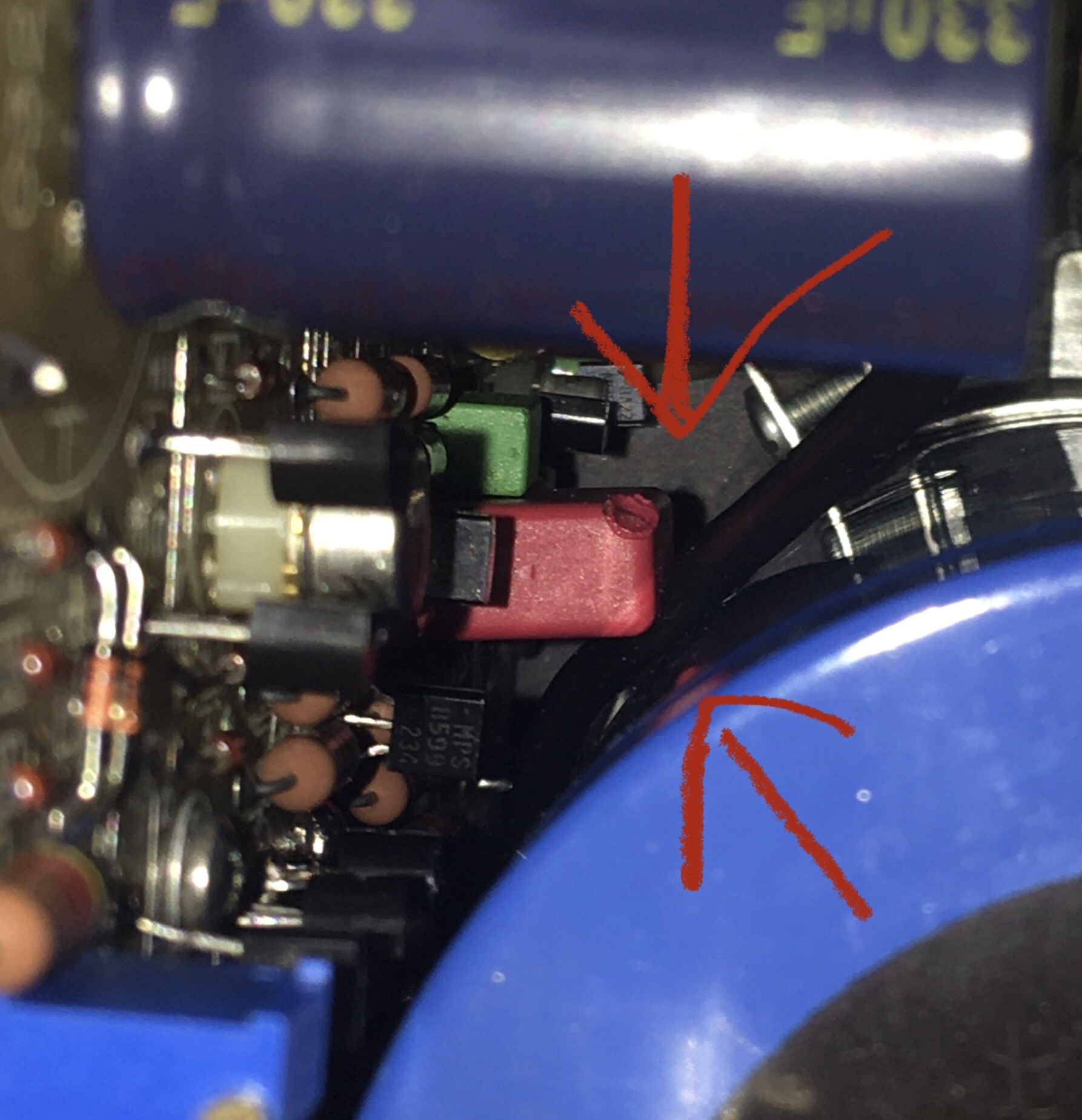

Hi Hans, I think I'm close to find the cause. I did some further inspection of the solder joints and boards and noticed that when closing the left amp, the black Vprereg- cable got stuck between the main filter cap and one of the Wima caps of the upper board (attached picture, by the way, is it one of those you were mentioning in your post?). The Wima capacitor is consequently slightly tilted towards the left, stressing the solder joints. By tapping with a sponge on the cable and/or the Wima capacitor I was able to trigger quite a few pops. So silly to have not noticed that the cable was stuck during reassembly, but that would be a great news and fixing it would only require removing (for the third time) the upper board.
p.s. the plastic case of the Wima gor melted with the shaft of the solder iron while desoldering a nearby pin for the last time, but I'm quite sure it is fine.
p.p.s. Actually I’m not sure the Wima is fine, I have an exact replacement so I will change it just in case

I’m glad you found a possible cause, but what nightmare to have this upper board removed again and again.
You have obviously the proper tools to get this done without causing any damage to the PCB traces, that’s great.
And replacing this Wima cap is a good idea, but also closely inspect the traces around to be sure there are no hairline cracks caused by mechanical stress.
Hans
P.s. You see the little green cap next to the red Wima ?
That’s the one I had to replace so you better replace this one too, out of precaution.
I removed the board. Honestly the joints and traces look fine under magnifying glass, was hoping to see some cracked solder joints but no. Ok thanks, I will replace the green one as well, since the tilted red Wima was touching the green one it could also be the problem was the green one actually. Thanks for the tip.

Sounds like you may be narrowing things down. As I suggested in my offline conversation with you, a wood chopstick is very useful. It can be used very specifically on small components, which is more difficult with something large and soft like a sponge. In cases where only the bottom of the board is available it can be used on each solder joint.
That melted corner is not likely deep enough to be a problem but it could have a cracked lead beneath the potting causing the popping so it should get replaced as well as the green one suggested by Hans.

Yes, FKP2 is o.k.
Popping was as you described but at very irregular and long intermediate intervals, but then finally it collapsed into a short circuit after a week in permanent use playing a 1Khz square wave.
After replacing this cap, the popping never returned.
Hans
