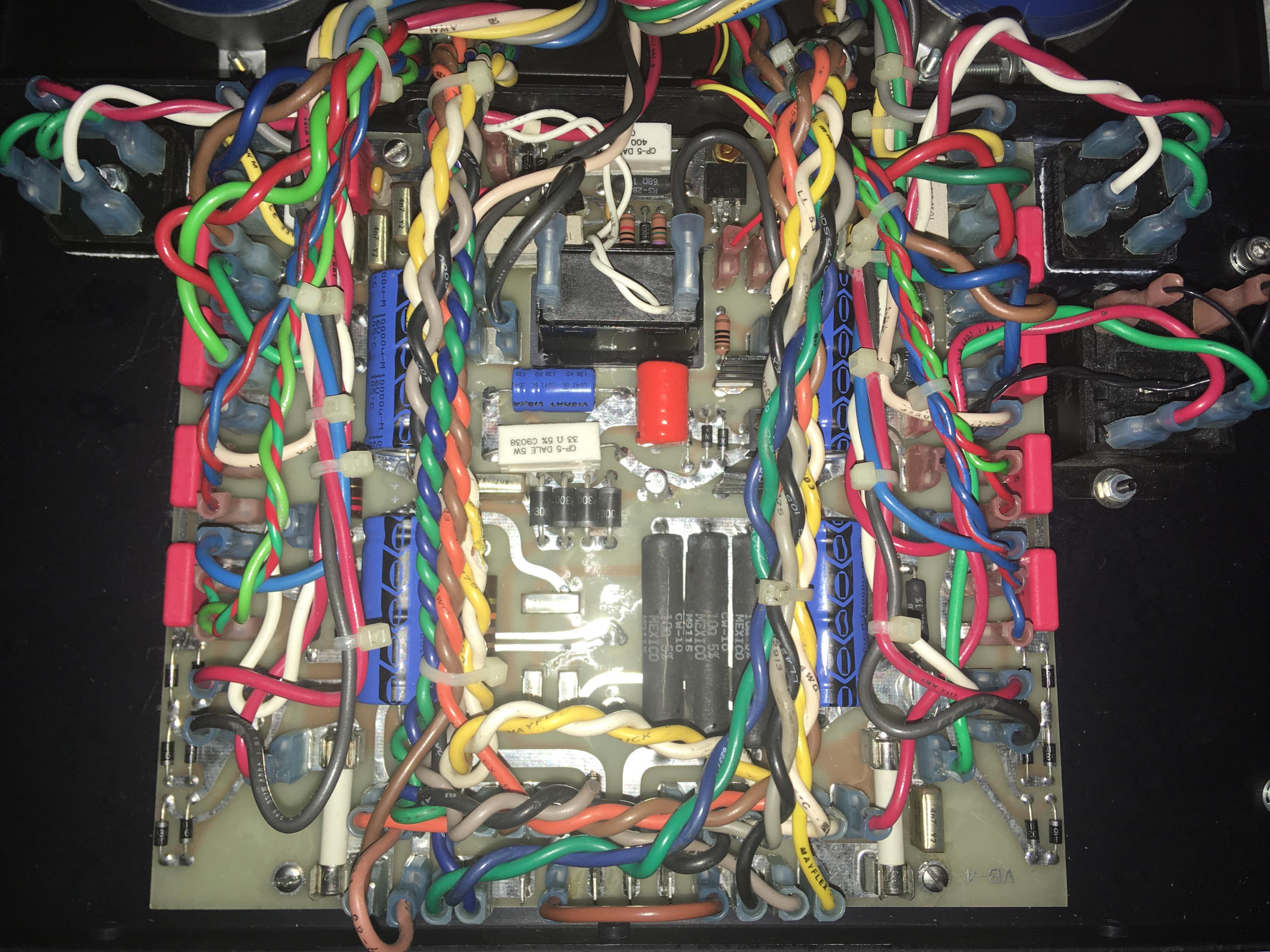

-Did you replace the two big caps on the upper board
-Which resistors did you replace on the base board and on the upper board. Pictures please.
-Can you with your scope have a look at both Vreg voltages in the AC position at start up to see whether oscillations are taking place

-I'm sure I replaced the voltage straps as they were before, I couldn't know if they were connected correctly to start with, however. But the buzzing was and is simmetrical and dependendent on the bias current (with bias to 0 there's no buzzing and it increases proportionally with buzzing). Only now I notice these intermittent brief interruptions in the buzzing that I don't know where they come from. I'm attaching pictures of how the voltage straps are connected.
-Yes I replaced the big caps on the upper board with the same value capacitors (Panasonic FC).
-I had to replace one of the MJE15030 mounted on the heatsink because I accidentally damaged it during disassembly. It is the one mounted on top, connected to the 2.2R resistor, so the one on the +Vreg section. I'm now starting to think it could be the culprit if it had to be hand selected. I didn't replace any of the output transistor, it turned out that the one that seemed to be acting strangely was fine, it was the meter that was wandering, with the new meter it measured ok.
I also noticed that previously the same transistor on the -Vreg section (MJE15031) had been replaced on this channel. I also replaced the two 2.2R as they looked discolored from the heat and one of them was slightly cracked.

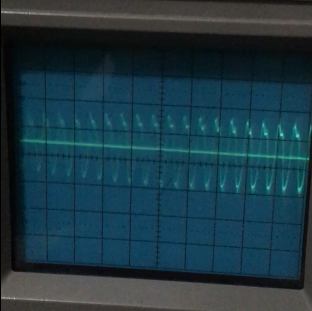

-I checked with the scope and I can see some oscillations for a very brief period of time (fractions of a second) about 3 seconds after switch on. I can see them on both +Vreg and -Vreg on this channel. On the other channel I can also see them but they much much lower amplitude (about ten times smaller I would say). I'm attaching a picture (500mV and .1 microseconds per division).

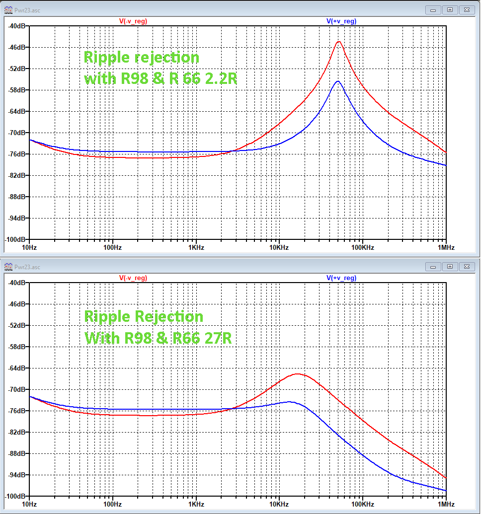

Changing the MJE transistors is uncritical, but I'm surprised that the 2.2 R resistors where cracked.
With 50mA, power is I^2*R = 0.005 Watt.
Only at start up they have an inrush in loading the big caps.
I know the oscillation problem, that's why I replaced those 2.2 resistors with 27R resistors. See image below for better HF suppresion.
But anyhow, does the oscillation completely stop after so many seconds ?
Then I would leave it as it is and see what happens with a load on the LS output, something like 10R or whatever you have.

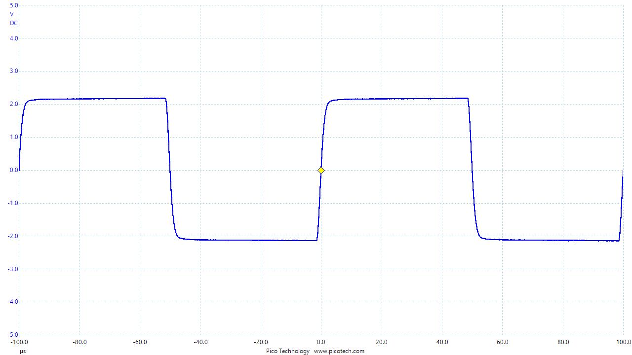

The best final checks are putting a 10Khz square wave at the input with 8R load and to measure distortion at 1Khz.
But might be out of your reach.

The oscillation only lasts for a fraction of a second, barely visible on the scope, and immediately stops.

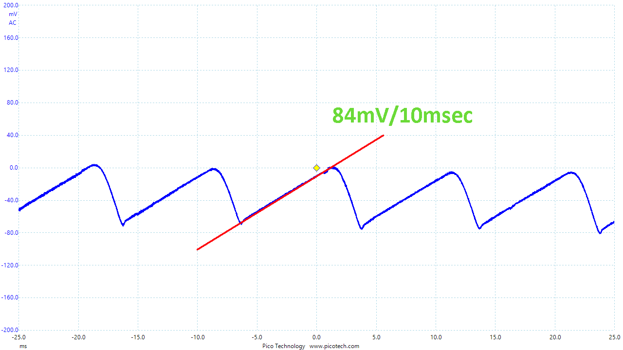

Let me first tell you how to do the cap test for the 4 blue PSU caps.
I=C.du/dt
For the 1900uF caps that are supplying 100mA, this means between two charge cycles:
100mA/1900uF=52V/sec or 0.52V in 10msec.
For the 36.000uF caps supplying 300mA, this means
300mA/36.000uF = 8.3V/sec or 83mV in 10msec.
Look at the trace at the image below where I measured the AC waveform with a scope in AC position with a calculated result of 84mV/10msec, very close to the 83mV I just showed.
For the negative supplies the slope is of course inverted.
When your readings deviate quite a bit, put a current meter in the line and check the 100mA and the 300mA.
Hans

I quickly measured the slopes of the 4 big caps on the scope. I see that the 36000uF caps are about 100mV/10msec, so pretty close for both positive and negative on both sides. The 1900uF are difficult to measure safely with the amp assembled so I will take more precise measurements tomorrow. I can see that the ones on the negative side are probably close to 0.75V while those on the positive rail definitely don't look ok. The left side in particular is probably close to 1.5V and has a spike on the leading edge of the cicle. The right channel one looks similar but with smaller amplitude. Tomorrow I will take pictures and more precise measurements, as well as check the current draw.
I repeated all the measurements on the caps. The 36000uF are about 150mV, while the 1900uF are 0.6V for the negative one and 0.75V for the positive one. The big spikes I was seeing yesterday on the 1900uF are not present, not sure what I was measuring yesterday.

1) all the ac voltages on your blue caps are twice as high as suspected.
