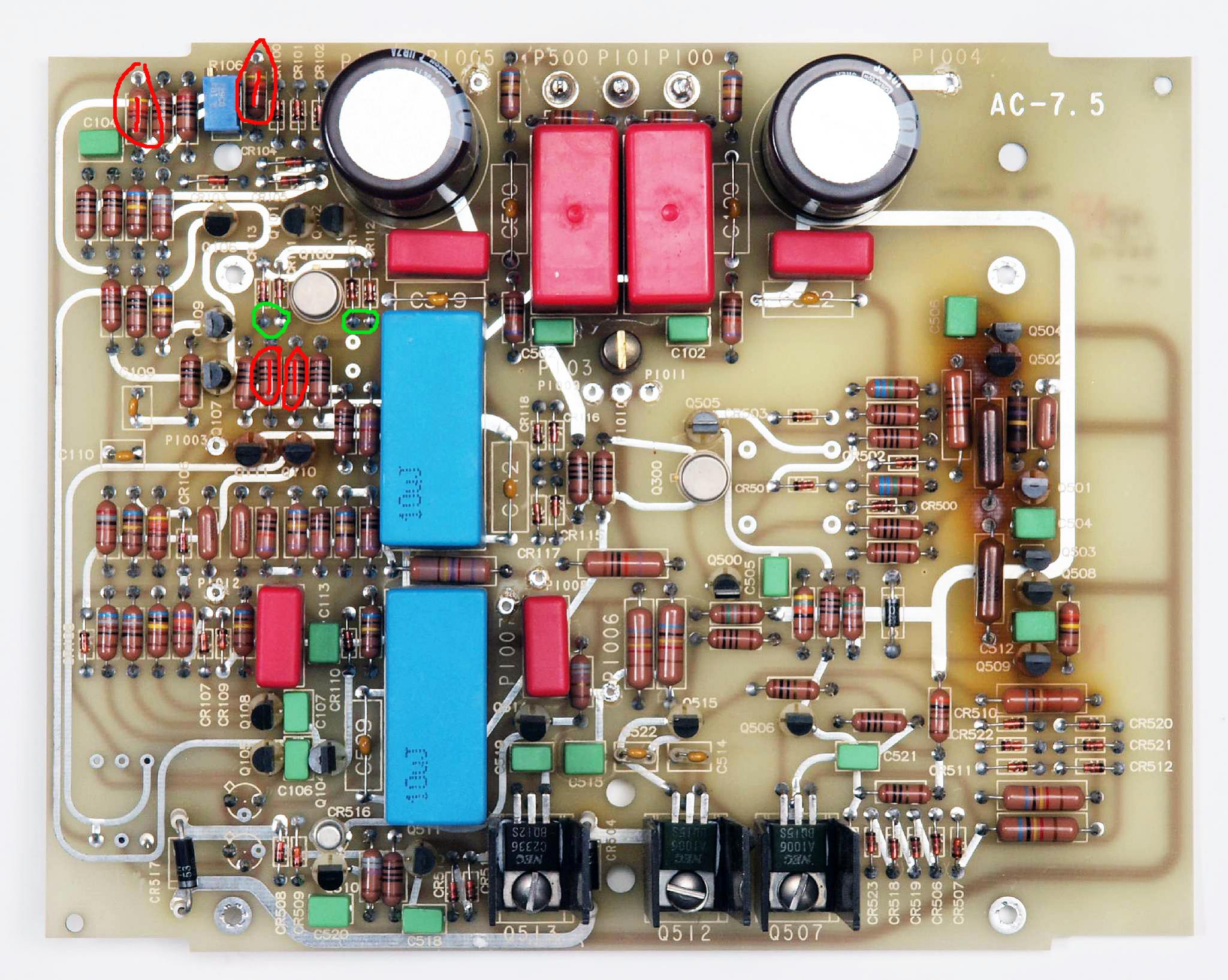

Anyway I just checked again the bias, and for some reason it was 400mA, don't know how it god there. the amp wasn't well warmed up so it probably would have dropped a bit but 400mA seems too much. Will measure again the caps with the bias correctly setup
O.k. here we go with testing the input stage.
There are four 1n914 diodes protecting the input and directly connected to both bases of the LM394.
1) Touch one of the green circles with a wire that is connected on the other side to gnd while measuring the other green circle.
In one case the other side will still show ca 1Volt, then you have connected the wrong side to gnd.
When having connected the right green circle to gnd, the other green circle will also have to show gnd.
When this is not the case, LM394 is no good.
2) when the above was successful, measure the voltages over the four resistors encircled in red with the gnd wire still connected to the right green circle.
Yes the 14K7 voltage is still 15V.
Voltage over the two 100 ohm resistors is -25mV on one and -180mV on the other. At switch on it is possible to try and balance them with the pot but after 2-3 minutes they drift and stabilize at the values I wrote.
Voltage over the 4.32k resistors is ca -600mV and -700mV, respectively.
Yes I imagined that. I already ordered a NOS replacement (by the way is LM394CH the same as LM394BH right?).
Are the 15 V on 14K7 explained by the faulty LM394 or there could be other faulty components? Although I already replaced all the other transistors in the inverting input section.

When you haven’t taken everything apart yet, I’ll give you another test tomorrow to be 100% sure.

Thanks. No it's still assembled, exactly because I'd like to avoid disassembling it more than twice 😀
Also, I recall being instructed that a pair of 2SK170 can be used if matched and in contact with each other (e.g. paste and copper tape).
Thanks, I'll check the other options you posted as well.
I'd like to keep it original if possible, especially for symmetry between the two channels, but if needed, or if the risk of a fake LM394 is high, I'll consider alternatives.
I've always thought that a new fake device looks different than a NOS one because of the visible effects of age on the materials (dirt, discoloration etc), but maybe they can fake that two.
I have several LM394 as well as the identical Mat02, but all used.
When you can’t get a proper one, I can send you one of mine for free.
But let’s first wait the outcome of the final 100% tests.
