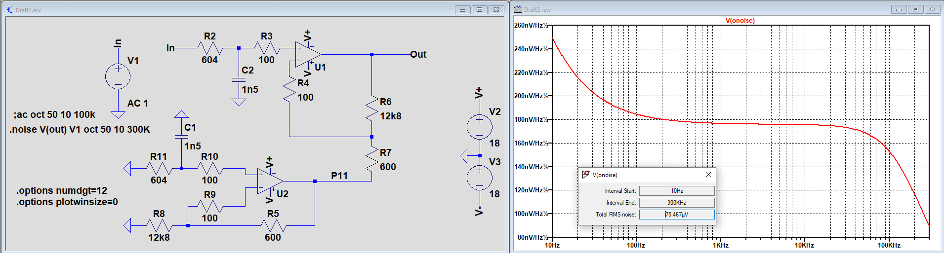

Because I just guessed the noise production yesterday, I wanted to be more accurate and made a model in LTSpice.
The 27.5 BW spec overall is 122Khz including the input filters. To get that, both amps in the circuit diagram below where given a GBW of 5Mhz and the 2.5nV/rtHz noise from a dual LM394.
Overall noise referred to input was now a bit below 8nV/rtHz, times 22 for the gain is 176nV/rtHz.
For a BW of 122Khz this would mean 61uVolt noise at the output.
In the picture below I measured 75uV for a BW of 300Khz, say roughly 0.1mV.
I suspect this 0.1mV is way below the noise of your scope, so what you measure is probably mostly noise from the scope.
Just to verify connect the gnd lead of your probe to the probe itself and see what noise is shown on the screen.
What does your Scope manufacturer specify for the input noise ?
To get a better idea of what's coming out of your amp you should either have a spectrum analyser or a low noise amplifier between the LS output and your scope to isolate the amp's noise from your scope's noise.
For the purpose of a low noise amplifier in between, you could very well use the other 27.5.
Hans.
