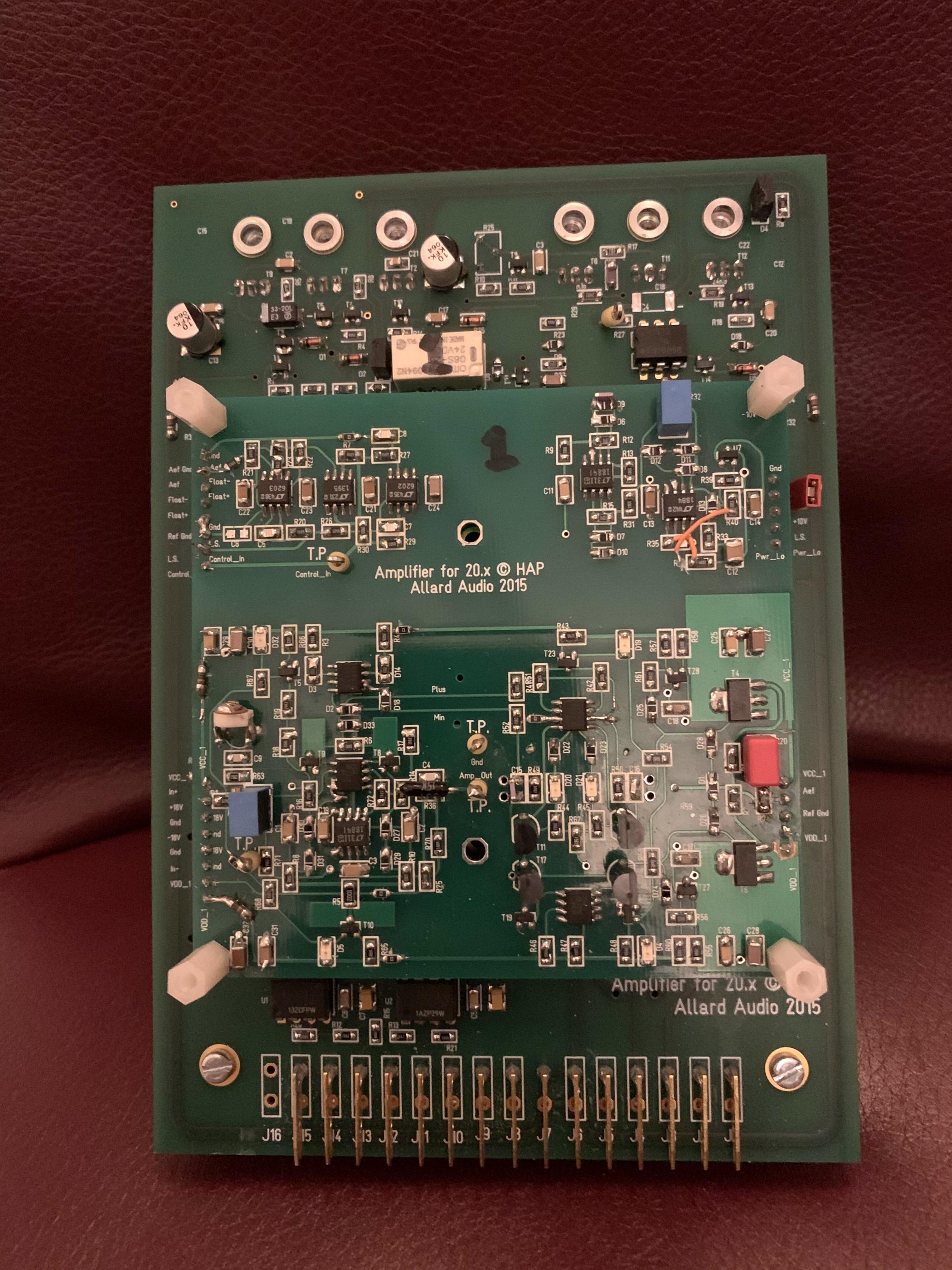

Here is a picture of the board that I designed for my ML26.
I offered it to ML, but they did not even react.
Hans
Hans

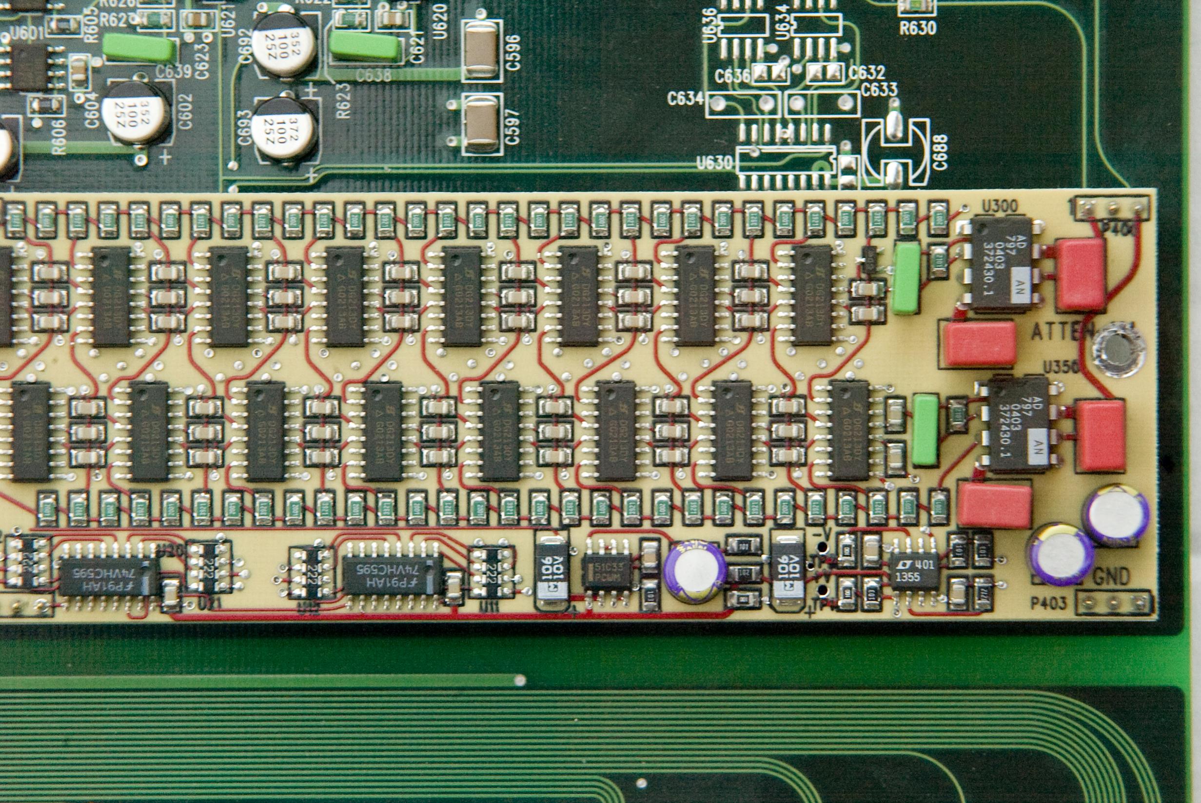

As said, fantastic looks, love at first sight but not top of the bill in sound despite the use of expensive components like four OPA627's and eight AD797's.
The main cause was probably their implementation of the Linear volume control with a zillion Fet switches, see picture below.
That's why I added a Logarithmic volume control to the BPBP with only 6 real relays instead of Fet switches , covering a 64dB range.
But let's go back to the ML27.5 because we are floating away.
Hans

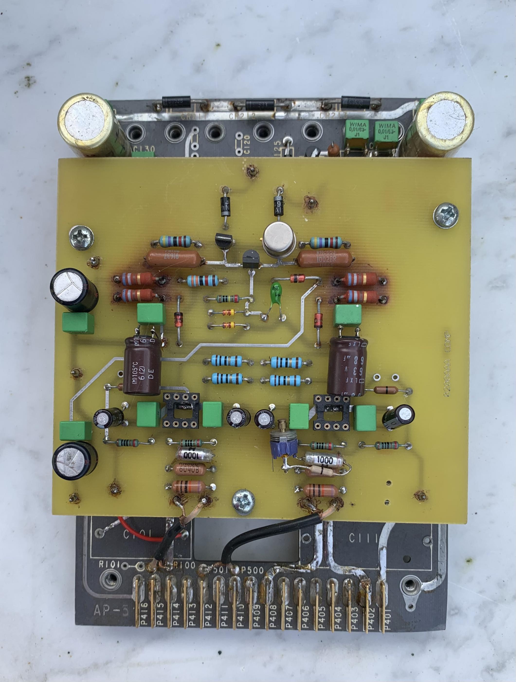

I must confess that I made a bit of a mess of the numbers, sorry for that.
Originally I bought a 20.5 that was later upgraded to the 20.6 with the teflon boards and with a new 20.6 faceplate all done by ML.
Here you see the remains of my 20.6 board, where I already had replaced the upper teflon board with discrete buffer for an OPA627 opamp buffer, but now also using the same opamp as buffer for the positive input, making it possible also discard the large 2.2uF and 10uF caps (see the large holes in the lower PCB). This all situated on an epoxy board together with the soft start circuit.
But as you know, in the end I replaced them completely by my own design.
The second picture shows the backside with heatsink removed giving a better view on the often repaired teflon board.
Hans
