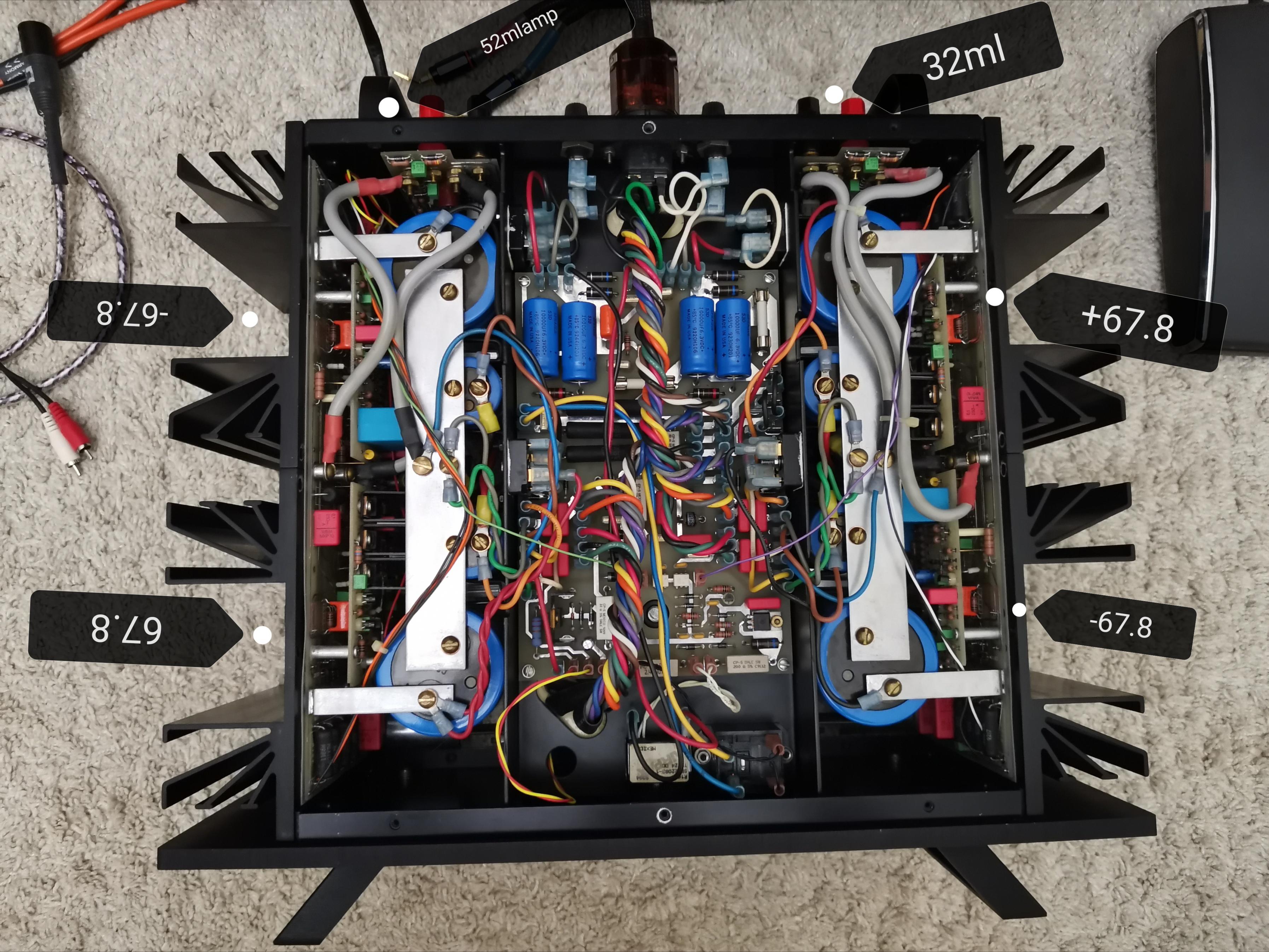

Mark Levinson No.27 amplifier,,,NEED HELP
Current.
Before you take things apart, which is indeed very inconvenient, I strongly advise to first replace the two 680uF caps on the upper board and to make Vreg+ equal to Vreg-.
When these two voltages are not equal in magnitude, the start up circuit interferes with the signal chain, that's why.
Hans
I did say that the regulated voltages have to be of exact the same magnitude for each channel, not at all the currents of both channels.
What do you mean with “there is no start mode ....” ?
What model do you have to 27 or 27.5 ?
Hans
Previously, when you turn on the amplifier in the first second, my speakers moved on the speakers.
As I learned this is a soft start mode due to the absence of a relay in the circuit. So after replacing the worn parts, 27.5 turns on, but this soft start mode is not. The amplifier works, but there is no sound.
So in fact the amp does not work because you get no sound.
At what point did you measure those 4 voltages ?
What are the voltages of P6 and P7 with respect to gnd and what current flows when connecting your multimeter set in the DC current mode directly between P6 and P7 ?
Hans
Hans, I measured these four voltages for about 10 minutes of the amplifier's operation.
It was possible to measure napryadenie p6-earth p7-earth
One channel 0.71 0.68 the second channel 0.7 0.68.
Between p6 p7 could not measure, I can not crawl, tomorrow I will try to measure
It will be close to impossible to measure anything unless you remove the top board.
It is Q216 that's doing the soft start, and either this mosfet is broken, or the cap C213 on it's gate is shorted or something in that range.
C213 should be slowly charged positive after powering up, thereby letting the mosfet transfer from an open into a low ohmic position, thereby releasing P6 and P7.
Hans
...P6 and P7 which should become resp +1.9 and -1.9Volt after the soft start has ended...
Interesting. P6 P7 are 1,76 / 1,73 in my amp.

Prior to repair I learned in Harman at the expense of condensatorul. They did not recommend changing 680uf 75v if they are normal, because they are better in quality than new ones. But you still unsubscribe, which will give you a replacement. They wrote that the hiss most likely comes from the bourns resistors.
In my ml 26 preamp, the channel rustled. After replacing bourns, everything is fine!
"..mosfet transfer from an open into a low ohmic position.." so, if it closes not fully, it drains partial current from the driveline?
Yes, but that’s not very likely to happen.
A much higher risk of draining current from the driveline is when Vreg+ and Vreg- are not equal in magnitude, because in that case the mosfet can open one of the two transistors with their emitters to gnd.
The result is that the LS output will show a relatively large offset.
As long as that’s not the case, everything is o.k.
Hans
They did not recommend changing 680uf 75v if they are normal, because they are better in quality than new ones....They wrote that the hiss most likely comes from the bourns resistors.
Thnx for passing that on. Although C21 seems ok, PosReg does have a ripple problem, and there must be a reason. I'll check.
Yes, resistors can add increased noise if defective.
