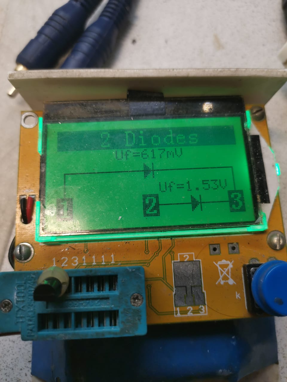

Hans, good evening! You were right! Transistor c216 was not working! Why do you think it could have failed in both channels? This could be due to the fact that I mixed up the wires p17 and p19 in one channel(but only in one channel).
I have no idea why things failed in both channels, they are completely independent, unless you have changed components in both channels in the same wrong way.
Could it be C213, where you damaged the mosfet Q216 with a high electrostatic discharge ?
Hans
P.s. What are P17 and P19 doing, I can't find them in my schematic.
These are the power supply wires of the channel, they are 190v I confused only in one channel when the Cr207 diode burst. After I called all the parts except for these transistors, all were in good order. But the error was in one channel, and the q216 transistors failed in both channels, this is interesting.

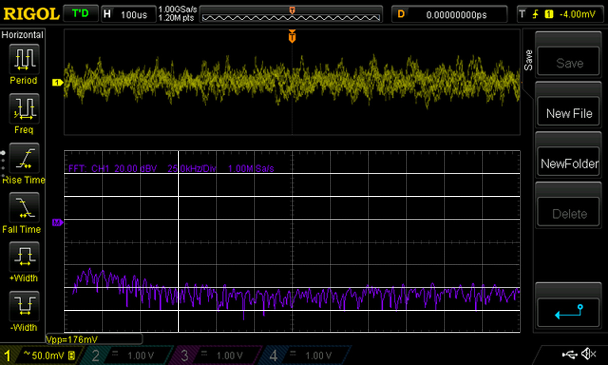

Interesting warm-up effect with cold amps: the noise or noise gain doubled (according to ear) after 10 sec. Will try to verify if this is indeed output from noisy ML that's responsible. Could be a components that functions briefly and then breaks down?
1) LS gnd to pin 2 and LS + to Pin 3 xlr
10kHz/div. 0 dB is where the blue M marker is. For 10d/div I had to raise it up to +30dB to see something (last pictures). Used 'Hanning' window.
first, without noisy ML switched on, 20dB/div
now noisy ML on, 20dB/div, had to raise offset slightly
10dB/div, 2 pics with different offset
Hope that helps. If not, I can repeat the measuring.
It seems noise amplitude falls as frequency rises? Does that tell something?

Then back to the first image of this morning, noise from the Noisefree amp.
I'm sorry, but have to go in a bit of a technical background:
Your timebase was 0.1msec, so the window size was 0.1*12=1.2mSec.
For the FFT this gives a resolution per filter of 1/1.2msec=833Hz.
Remember I had calculated your Amp to produce 176nV/rtHz, which is 20log(176e-9) = -135dBV/rtHz.
But since your filter width is 833Hz, we have to add 20log(sqrt(833))=29dB.
So your reading should be -135+29= -106dBV.
However your FFT reads ca -90dBV, meaning that almost 100% is scope noise and not from the amp.
So no conclusions can be drawn, other than that your scope is producing -90dBV-29dB=-119dBV/rtHz = 1.1uV/rtHz
which for the assumed 1Mhz BW of your probe means 1.1uV*sqrt(1Mhz)= 1.1mV rms, which seems quite correct.
Conclusion: forget this first measurement.
When adding a second Amp you lift the noise from the first amp by 20*log(22) = 27dB bringing the noise from the calculated -106dBV to -79dBV or 11dB above the -90dBV noise from the scope.
Scope noise will now hardly interfere and readings will become useful.
So If you want a reference noise spectrum, you will have to take one channel of the noisefree amp as input for the other noisefree channel and measure it's output.
I will still comment of the spectra hereafter where you used two amps in series.
Hope I did not overload you with figures, but we are getting somewhere.
Hans
I took the last image in posting #108 and added the division lines that where a bit hard to see.
Three things are apparent:
1) the slope going down from 0Hz to 75Khz by 20dB, this should be as horizontal as the spectrum hereafter.
2) the peak between 10Khz and 25Khz, indicating that some source is jittering in this frequency range, probably your power supply.
3) the fact that the spectrum goes on at the same level after 125kHz, although the BW of your amp is only 122Khz ??
Now could you do the same measurement with the two channels of the noisefree amp, output of one connected to the input of the second channel to get a reference spectrum.
And if possible it would be good to connect a 1K + 1nF in series at the output of the second amp, measuring over the 1nF that is connected to LS- on one side and to the 1K on the other side.
This will function as an anti alias filter and should be visible in your FFT spectrum.
Hans

Hans, thanks a lot for the time you are taking.
I will set this up so there is a reference noise FFT, with some anti-aliasing.
I confess I do not fully understand your calculation, but if I get this correctly, the FFT only uses the 1,2ms window the scope currently displays, correct? I thought it is using it's storage memory for averaging, but apparently not, which is why the frequency graph jumps around like crazy.
I found some software that reads data from the Rigol and does a better FFT on PC, it hasn't been updated in a while, but I'll quickly see if I can get it to work.
BR
