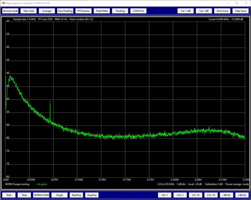

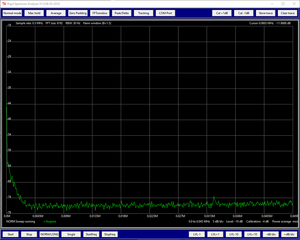

1MHz working vs. noisy
Hi BakedAlaska,
Big, big improvement.
Two things are visible:
1) Amp doesn't have a BW of 122kHz as Stereophile reported but of 350Khz, but that lower frequency was caused by the input filter.
2) The silent one looks O.K. apart from a strange peak at 60Khz, but that is most likely caused by the switching power supply of your computer.

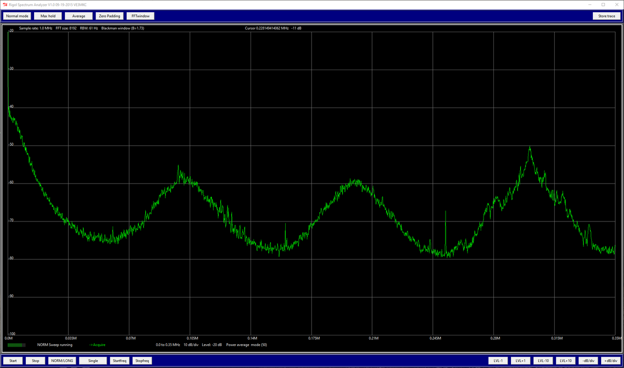

As a reference here the spectrum of my upgraded ML20.6 amp from 0-325Khz.
That's how the spectrum should look like, but as you see, yours comes close.
I'll study your images a bit further, and come back to you.
Hans

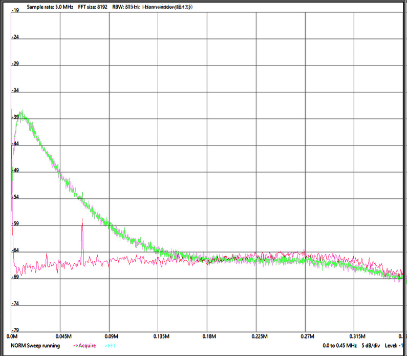

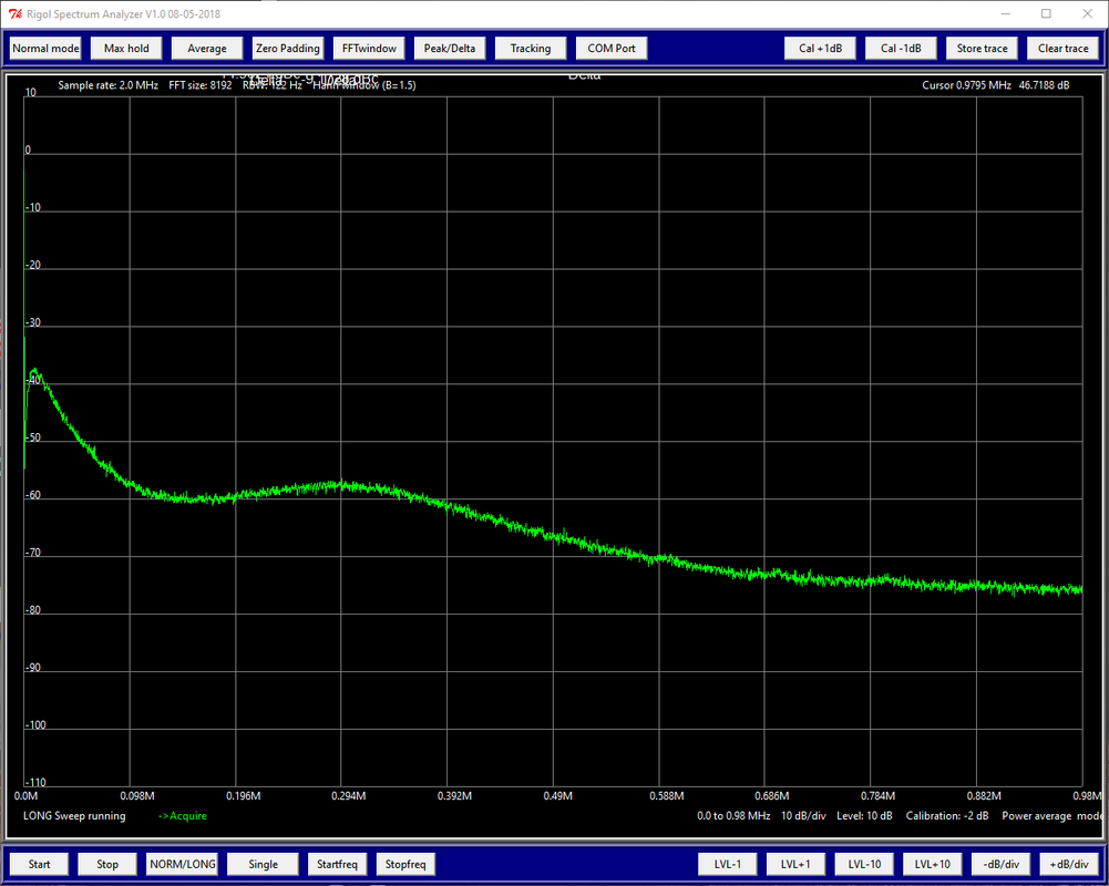

I have taken your 450Khz images, restricted them to 350Khz, being the actual BW and overlaid both images on top of each other.
As can be seen, as of 150kHz and upward, both are equal, so we only have to concentrate on the frequency below.
However, it is not an oscillation that's going on but a pure noise generation, so I think that this can only be caused by the regulated power supply (a zener?) , but before measuring the power supply, could you:
1) repeat the same noisy measurement with 450Khz, but now with P11 shorted to Gnd.
2) what about the other channel of the noisy amp, does it behave the same ?
Hans

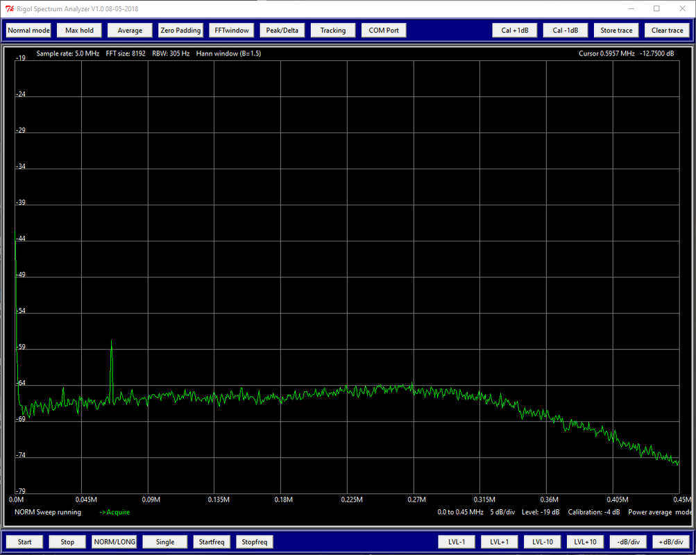

The 60kHz Peak stays there. Either PC or Scope switching PSU or some source in apartment above. On the Rigol I don't see this peak with the FFT, it's too limited, I need to get one of those pico scopes. The Rigol is only 8bit, the Pico at least 12.
Difference is also I'm using AC coupled all the time, but that should not make any difference here.
Heard the zeners mentioned before regarding ML 27.
And yes, the working ML does not look completely linear, compared to your 20.6 over the 350KHz BW.
Will get the other measurements, bear with me, I'm slow.
