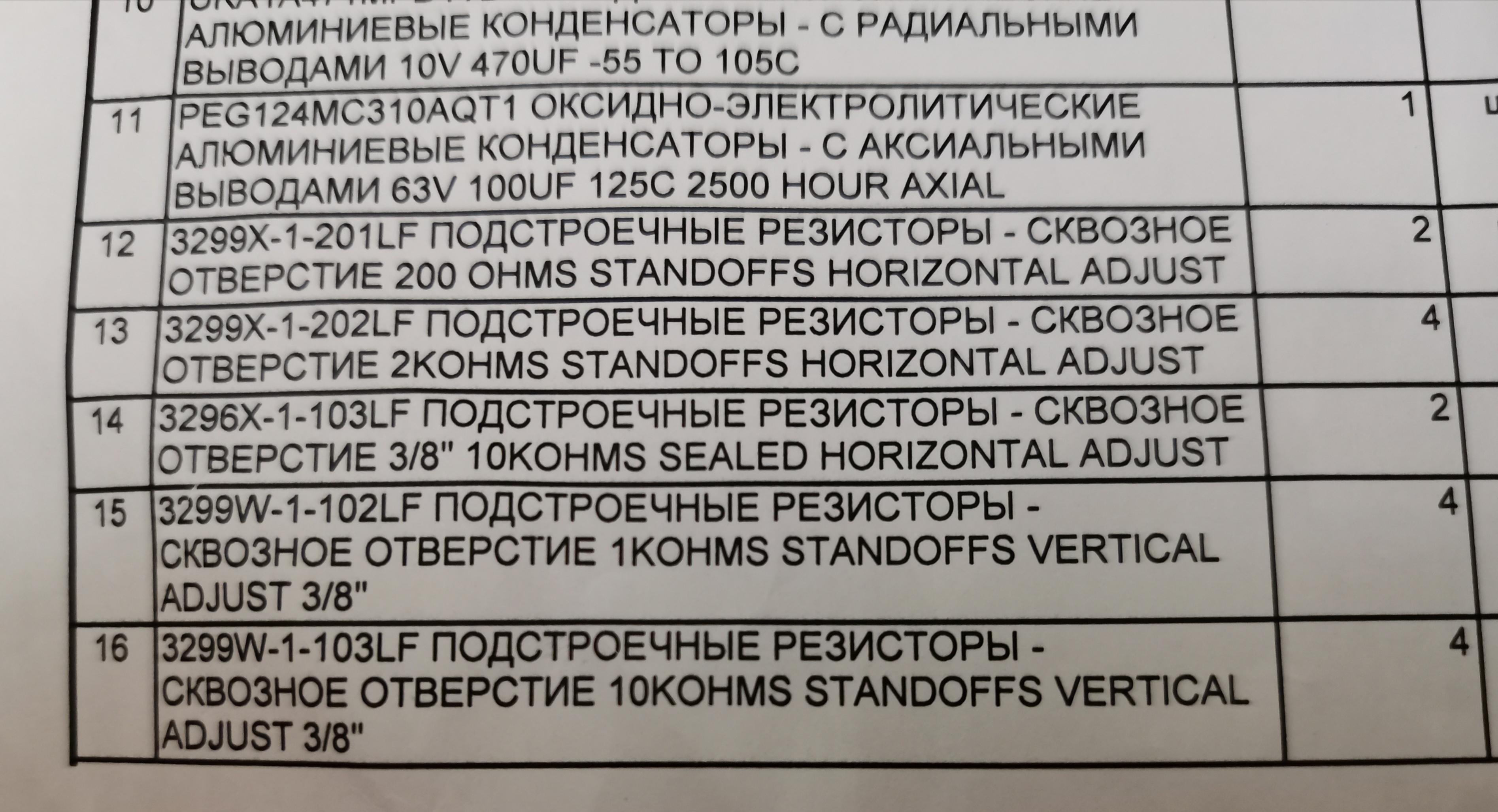

Ahh, the Bourns are the 4 trim pots, now I get it.

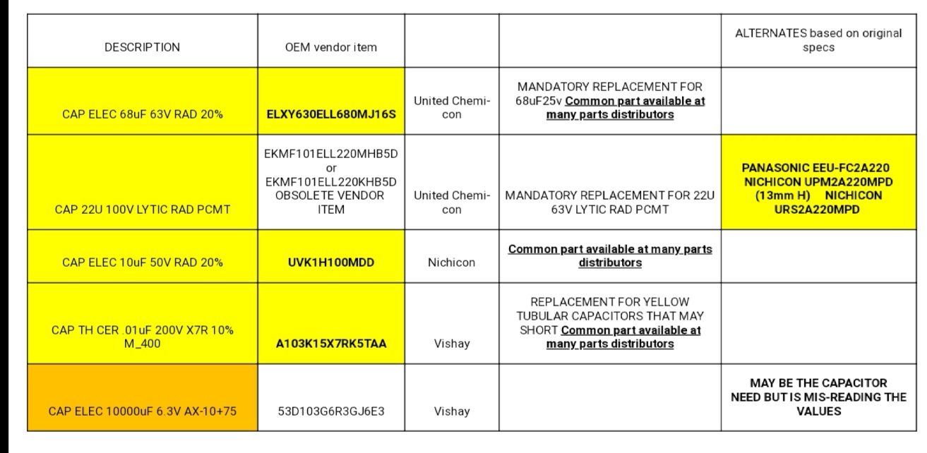

Hey, thanks. Where did you get this? From Harman?
Well, I' contemplating should I a) take blue pill, slab on the caps and enjoy the music or b) take the red pill, dismantle the boards, replace caps & all the other stuff properly 😉
BR
BR
Apparently the used different 0.22uF - in one amp this are "EKM..", in the noisy these are Roedersteins.

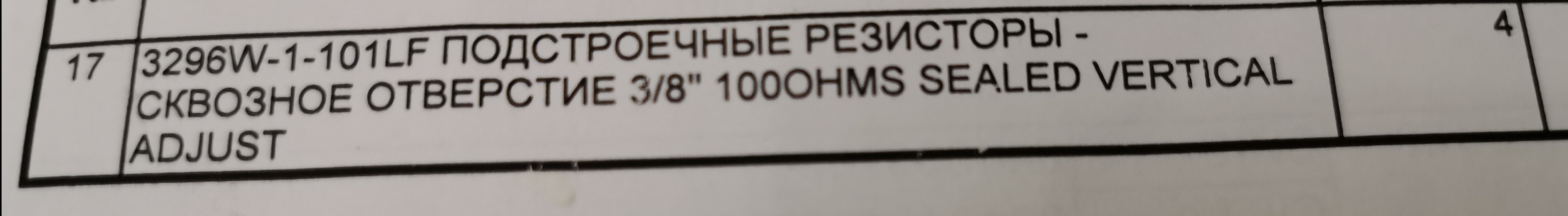

Sorry, but I can't figure out the Bourns resistors, I ordered for ml 26 and ml27.5 in the same order.
Here I made a photo for you, by the location of the regulator, determine for yourself, the series are written there.
BR
Yes, this selection is from Harman.
Yes, these roe disgusting capacitors! I set myself a nichicon muse kz 22uf 100v. Harman recommends another nippon kmg 22uf 100v.
