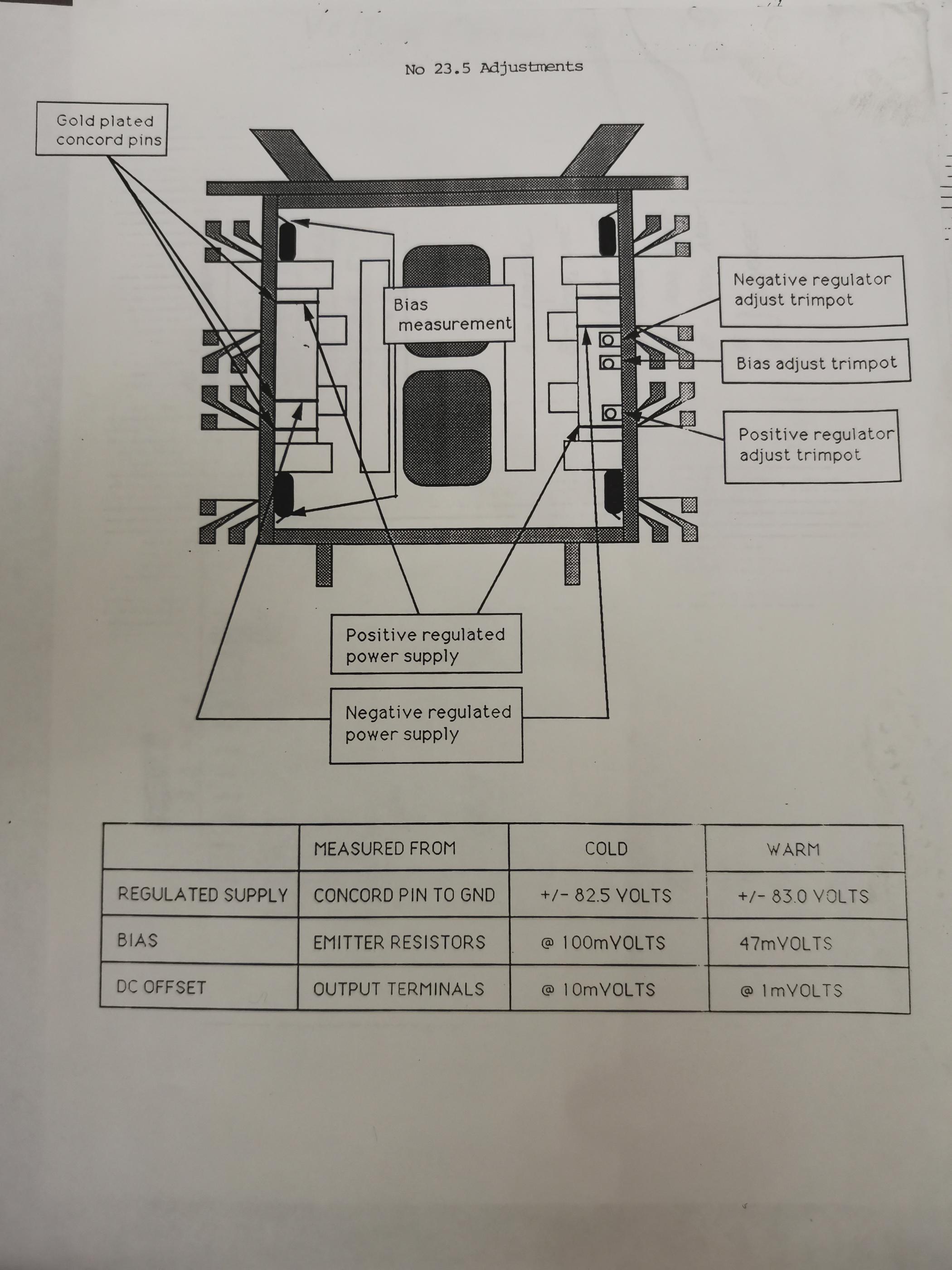

Hans, good afternoon! What do you think for 27.5 the same current settings as for 23.5 ?
Nice table but not correct IMO.
Bias current for the 23.5 is 270mA flowing through 6 pairs of output transistors.
That’s 45mA/transistor.
With 0.22R emitter resistors this means 9.9mV per emitter resistor and not 47mV.
So the 47mV in your table should be read as 47mA.
The same amount of current should also flow per transistor in the 27.5
With 4 pairs of output transistors this adds up to 180mA.
Since all the emitter transistors are joined in four 0.22R that are two by two in parallel, they act as two 0.11R resistors.
So you can also measure here to see 180mA times 0.11R is 19.8 mV or 39.6 mV if you measure over the 2x0.11R.
Hans

Understood, thank you for your clarification. Look what I have a rarity)Nice table but not correct IMO.
Hans

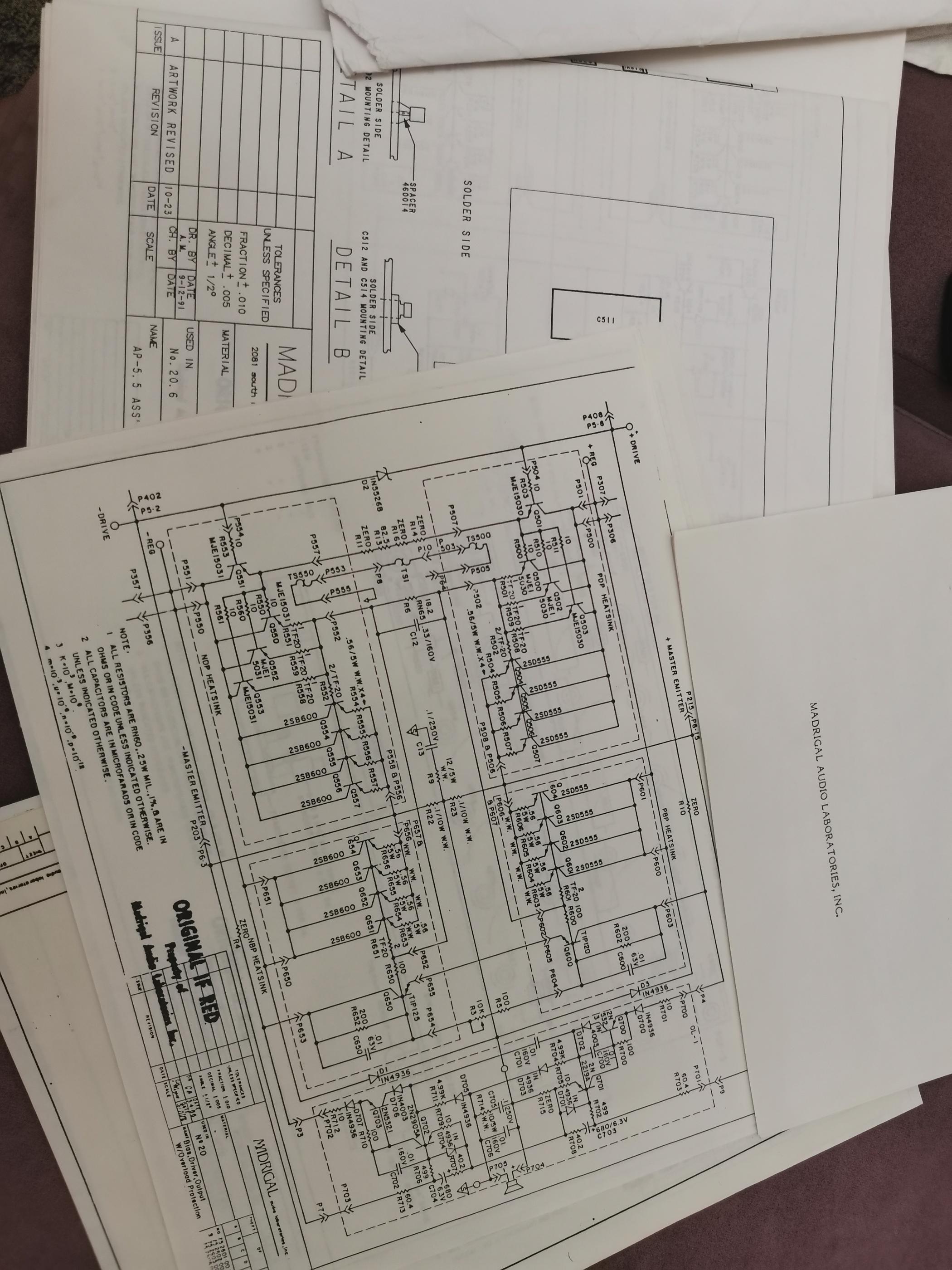

Be aware that this is ML20 documentation.
Hans
Gotcha! I read 20-20.6 and somehow thought it is for the whole 2x series
