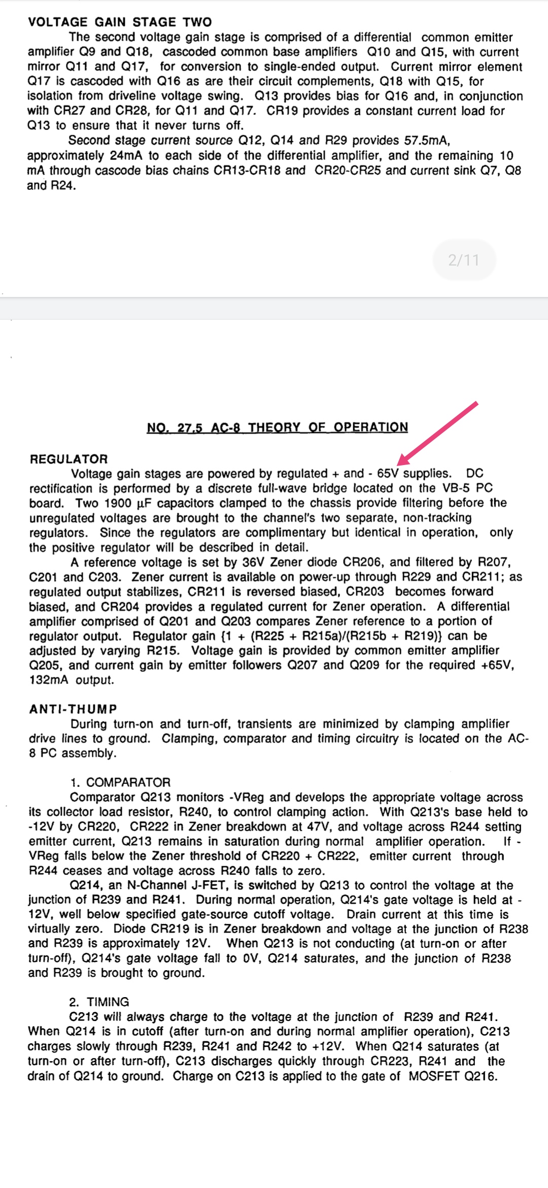

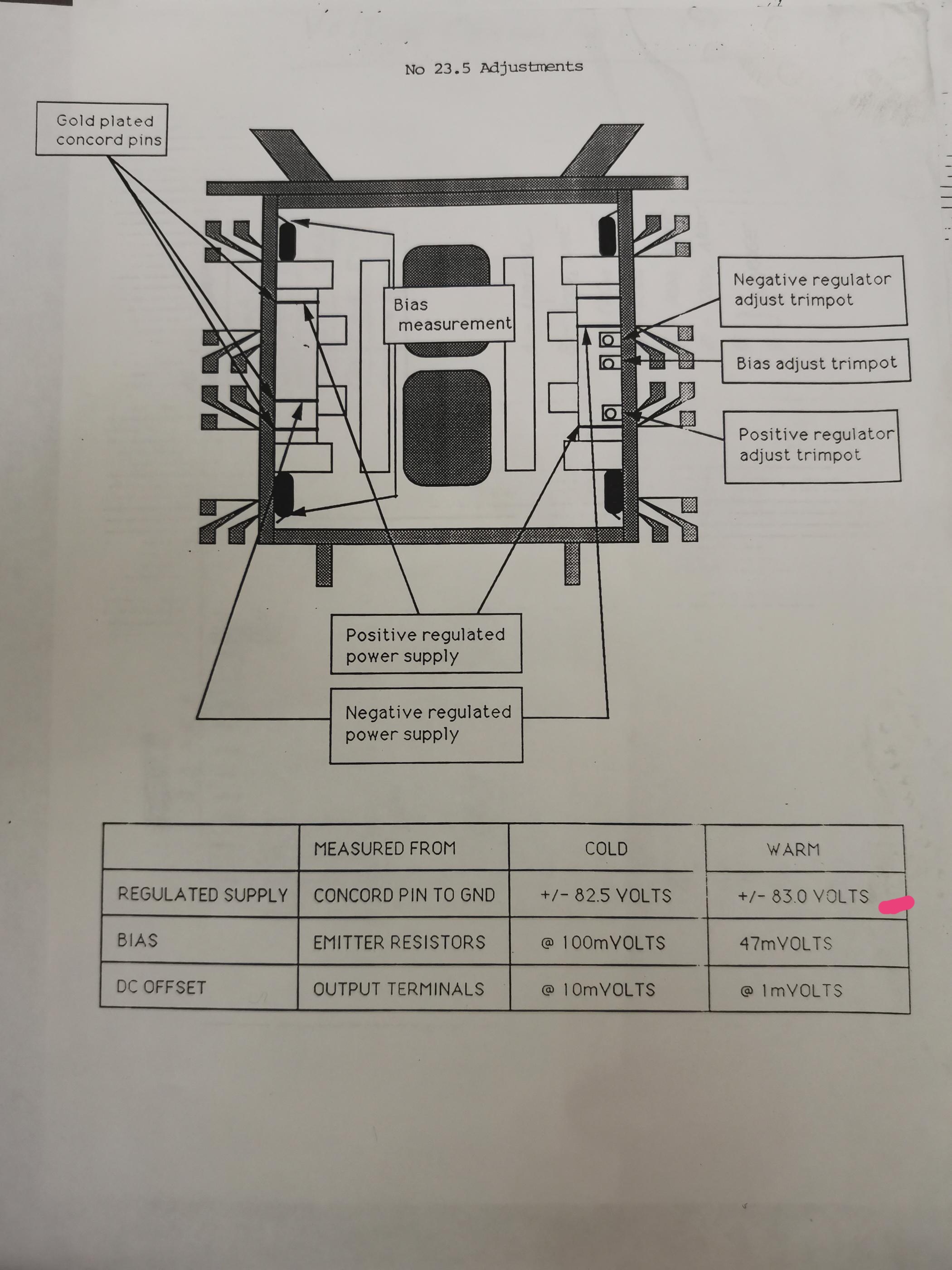

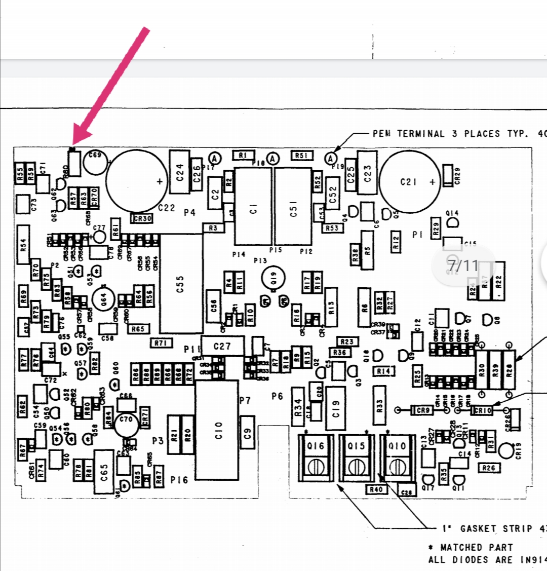

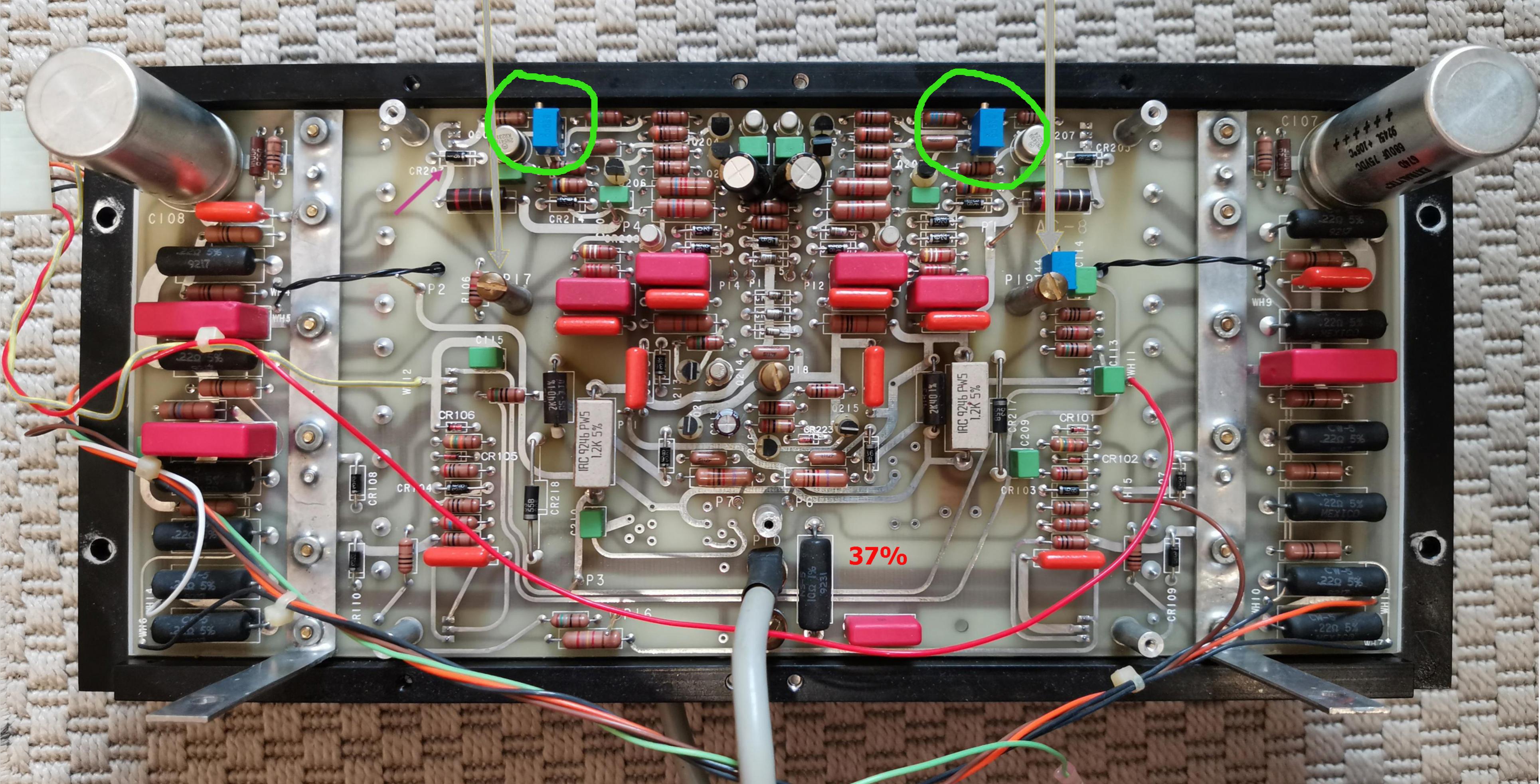

Hans, please tell me what regulates the tuning resistor on the ac 8.5 R60 Board highlighted with an arrow in the photo. And another question, 23.5 in the photo shows the voltage between the gold studs 83volt. And in 27.5 should be 65.2 volts?
The last photo is taken from the service manual ml 27.
You adjust the DC output voltage of the inverting input amp.
So measure on P11 while turning the pot to set the offset voltage to zero volt.

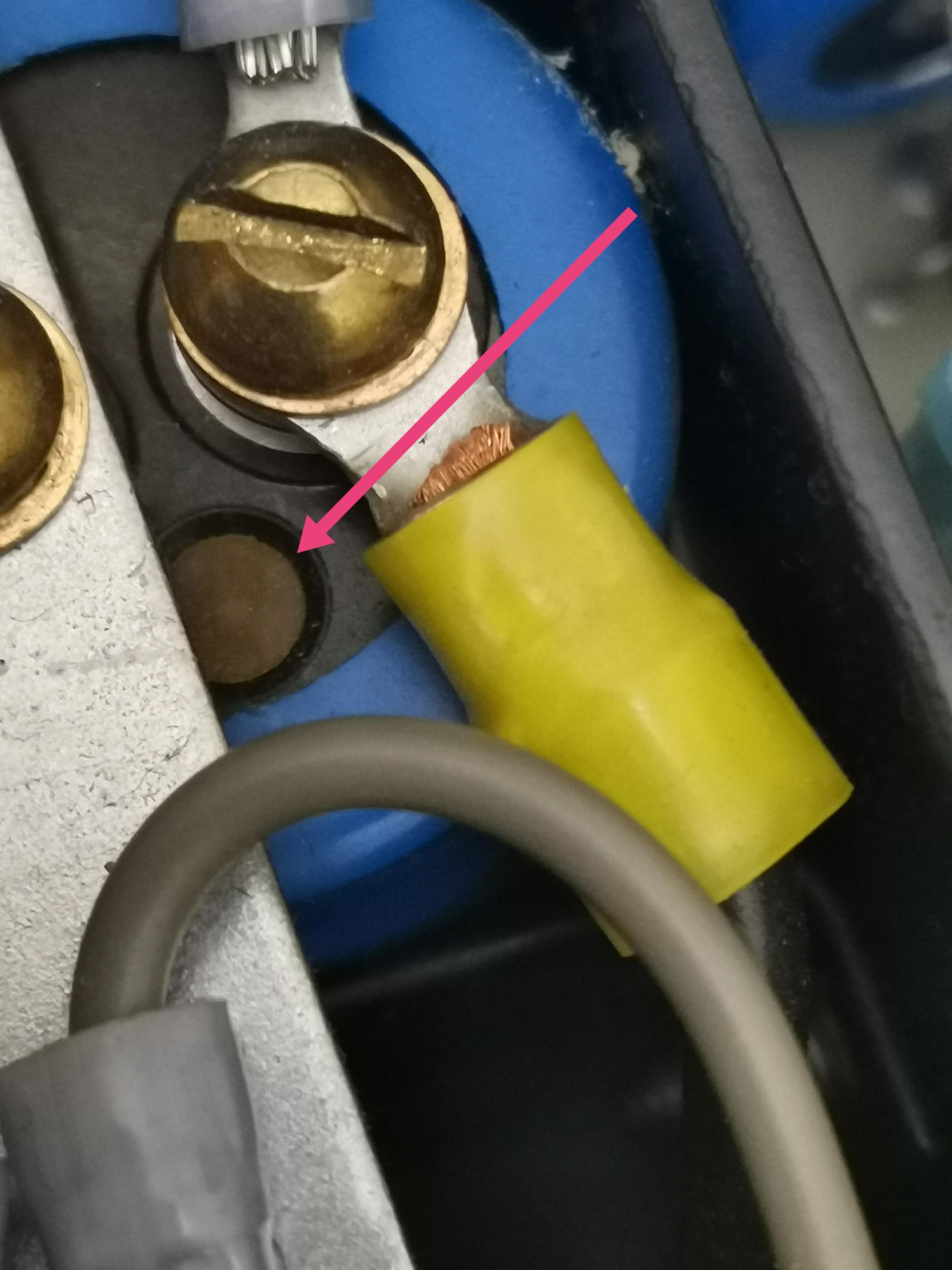

Do you have a brown valve on the new 1900uf?
I just thought that the new 1900uf valve should be white. Unfortunately, I do not have a complete service manual �� there is only the beginning of the gle, the disassembly of the 27th is described and that's it.
just looked for new mellory for $ 60, so I thought to change them or something. I wonder how the replacement affects the sound do not know?

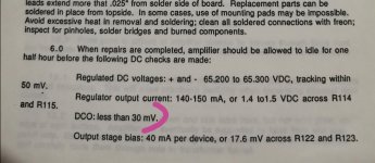

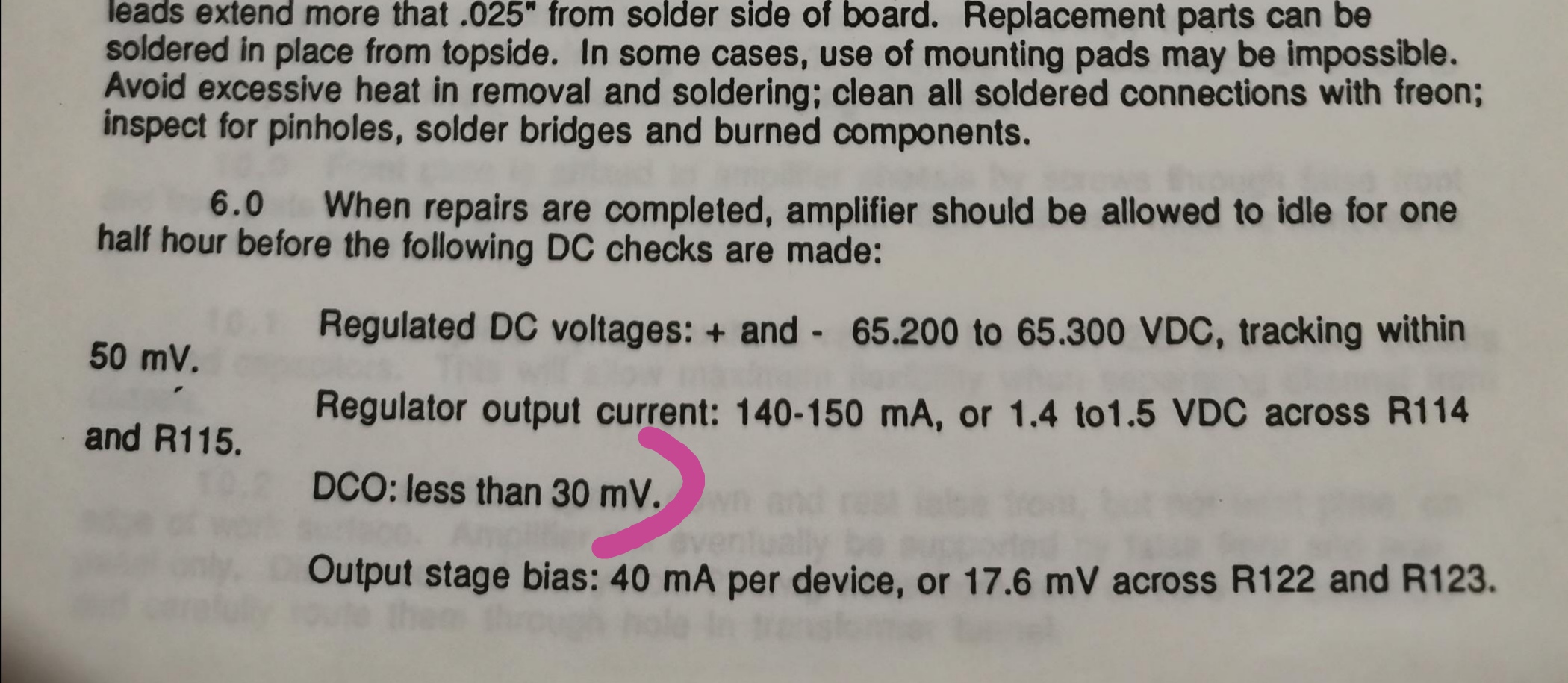

Hans but in the service manual to 27 it is written 65v and in the service manual 27.5 it is also written 65v.
At what points should I measure + -63v, I do not understand.
Yes, 12.3 mv in the other channel 0.02 mv
Oops, forgot the image.

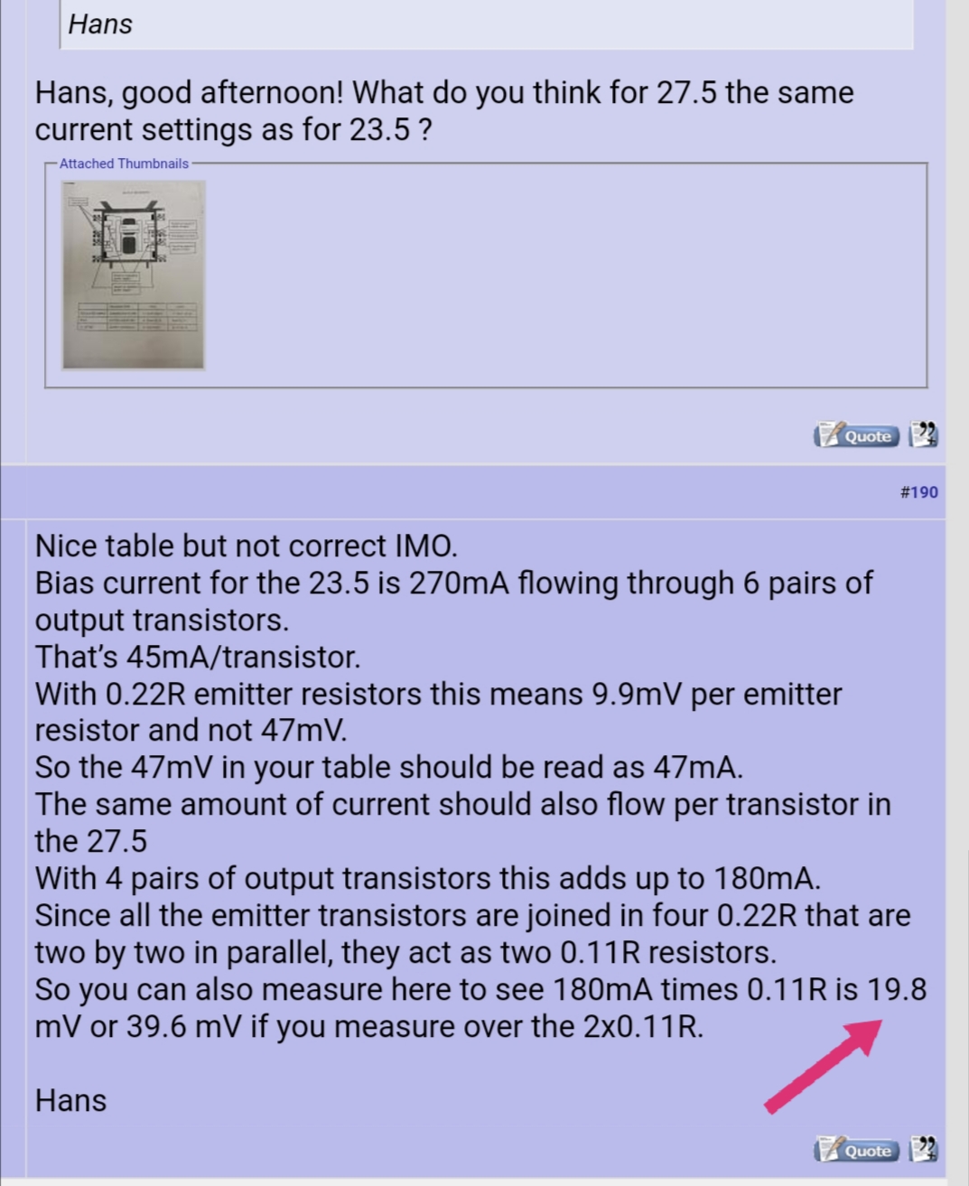

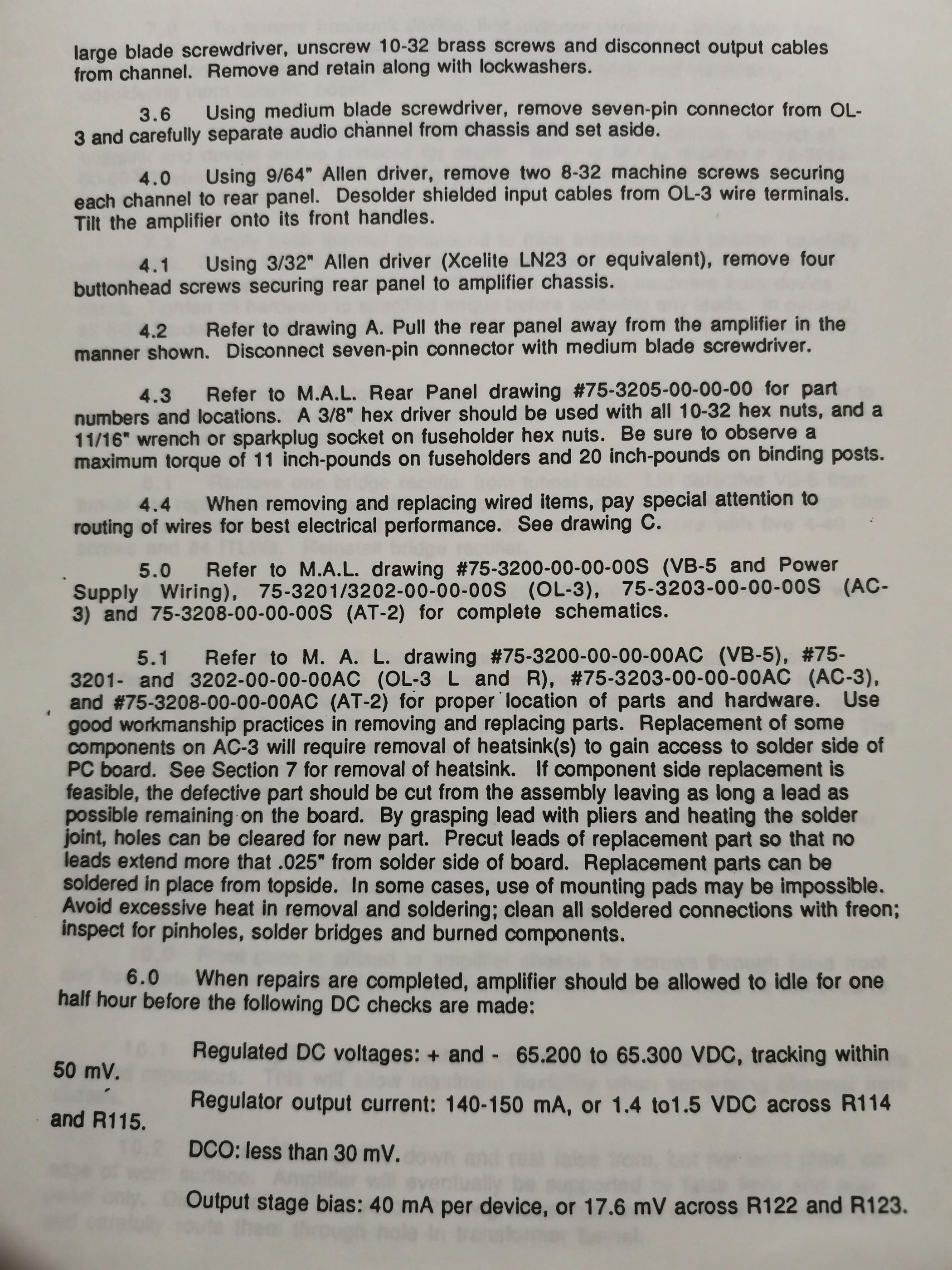

Hans, I attach a screenshot from 27.5 and from 27. And so de in post 190 you wrote that the current is worth putting 39.6 mV.
Hans that in the end will be correct? 35 mV or 39.6 mV 🙂

You are right, 65 Volt is the right value, sorry for the typo, good that you checked.
My earlier 180 mA was deducted from the ML23 with 45mA per transistor, but reading your manual, 40 mA was advised instead.
But it does make hardly a difference, so either 35mV or 39mV is O.K.
The +/- 65 volt should be measured at P1 and P4.
Hans

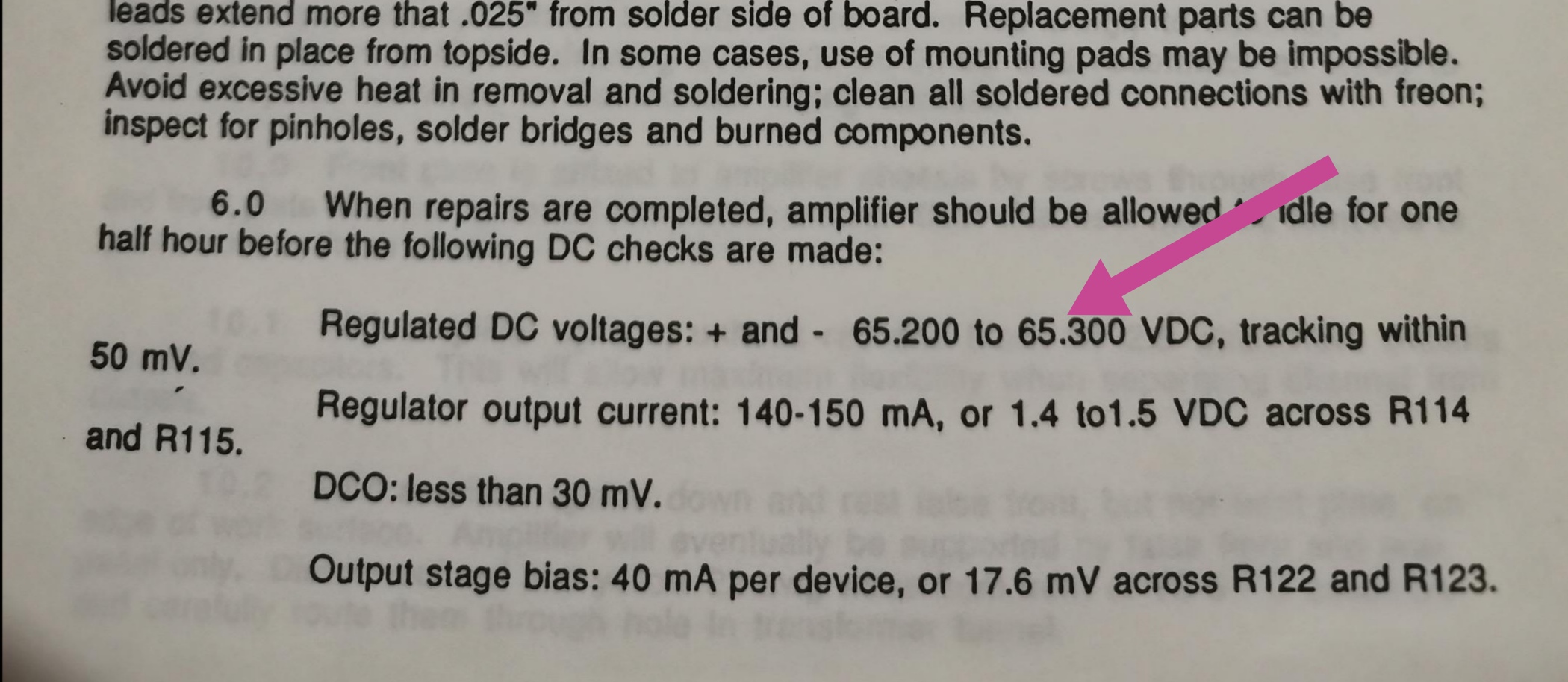

I also read in the service manual that the constant voltage at the output terminals is up to 30mv within the tolerance, so I should not worry?
Or should there already be 0 mv at the output terminals at 27.5?
