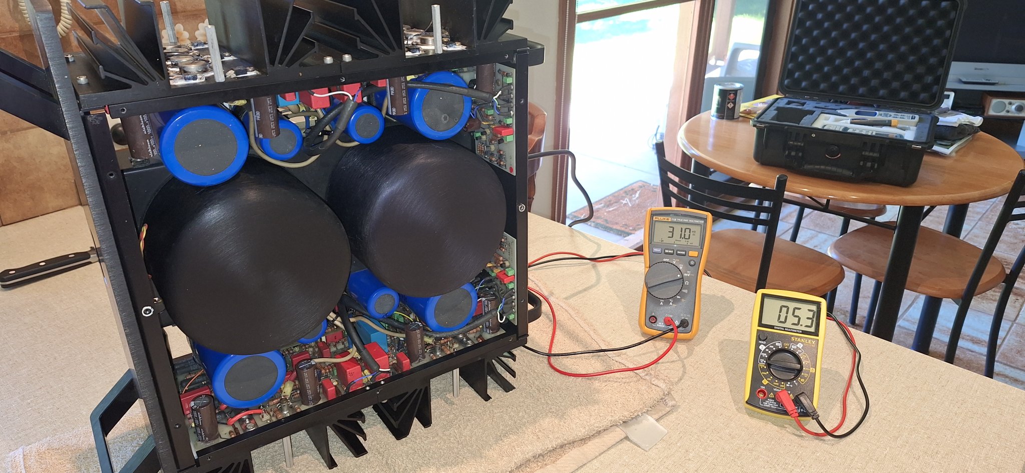

well I've sorted Vac in on my 27, the amp starts nicely on 240V & both channels work, however..
today I checked the bias;
left channel is 12.2mV
right channel 24.1mV
(so both channels are out somewhat!)
I also checked the regular current across R114 and R115
Left 1.33V & 1.41Vdc
Right 1.4 & 1.33Vdc
I'm unsure of the way forward here, should I first adjust the regulator current (L&R) and match them better or just re-bias to 17.5mV?

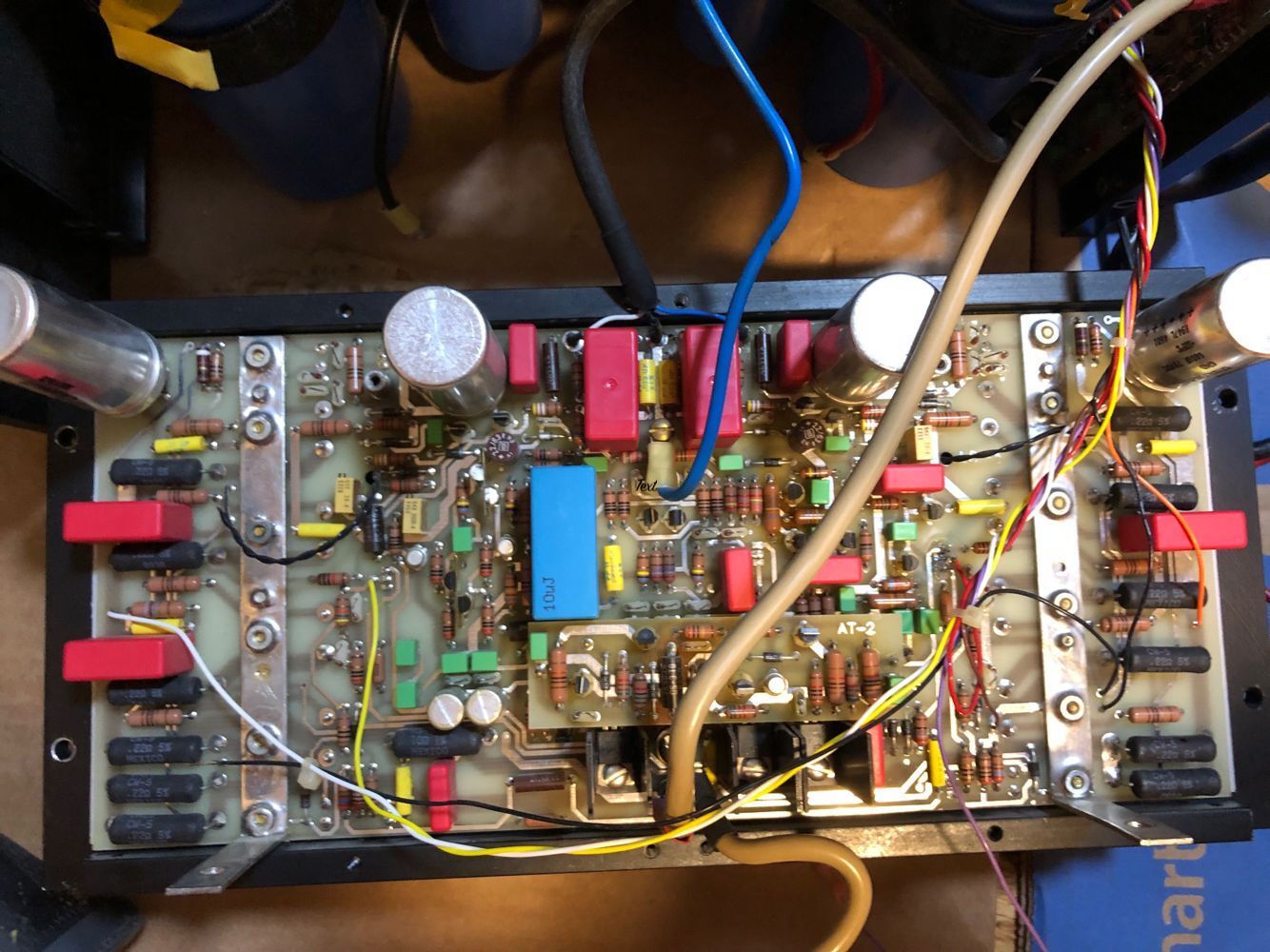

Also, my eyes are playing games seeing the PCB traces... can someone please confirm its the middle pot for bias?

Hi Allan,
I don't have the ML27 documentation, but only the 27.5.
But apart from a more sophisticated input buffer on the minus input, they are the same.
There are three pots as you can see.
Two are for adjusting the Vreg+ and the Vreg- supplying the voltage gain amp with +/- 65Volt
The third pot is for adjusting the bias.
Now the question is which one you should use.
To measure the bias you should use the outer side of the two black resistors on the lower left corner in your picture that are in parallel giving 0.11R and also the outer side of the ones on the right, again 0.11R, so since they are in series you have 0.22R.
For the four complementary output transistors of which each pair should have a bias of 35mA, a total of 140mA should flow through the four black resistors.
so at the outer ends of both you should measure 140mA*(2*0.11R) = 31mV.
I'm pretty sure that the two most outer pots are for Vreg- and Vreg+ and the one in between is for the bias.
When turning this pot carefully while measuring in the corners over the black resistors, you should get immediate feedback that the bias is changing.
If not, take the pot next to is and repeat the process.
Good luck,
Hans

thanks very much for the help here, it biased up nicely.. mid pot.
Prior I had mistakenly adjusted one of the outer pots hoping it was bias when I noticed it changed the DCO, so returned it to its position by DCO.
30min warmup and everything's rock solid. Its sounding very nice, its definitely got more body & drive.
Adj DCO again after the below photo was taken, both L&R now <1.0mV
