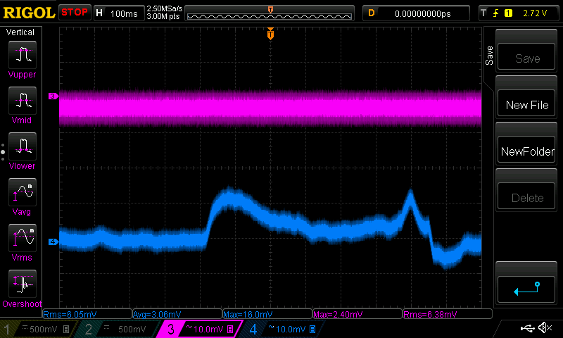

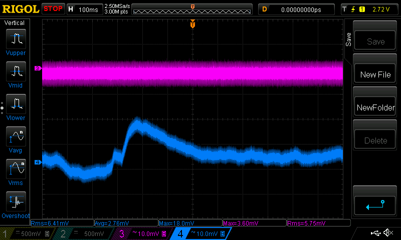

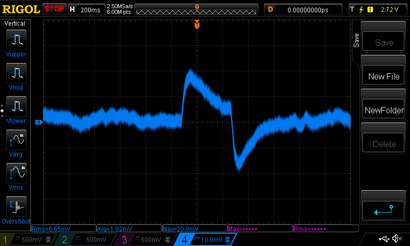

..looked at the voltages with my scope, and realized that Vmax and Vrms for -VReg is 0,2 higher than show by multimeter. So I looked at it in more detail:
upper is +VReg, lower is -VReg
So, apparently there is a problem with -VReg. Could this influence the soft start circuit?
Also, the lower graph seems to 'calm down' a bit with warm-up, which would explain why it tends to happen either right at switch-on or 5-20min into warm-up and then goes away.
Checked the other channel as well: both +- look like the upper graph, with +VReg *slightly* starting to ripple. So ok.
BR
PS: this ML has been at a dealer recently with the glitch description. They didn't hear the glitch while it was at the shop, which is possible, as it is really rare.

The noisy ML also had a problem with +-VReg, but, remember, it was noise (from C201, C202), but they don't have this ripple in the 100ms timescale like the 'working' ML above. I guess this explains the different symptoms.
PS: there is a little ripple in noisy ML right channel +VReg (where I have replaced the original spraque), but it's not triggering the soft start yet. Probably should fix this as well, good thing I have not disassembled it yet 😀 - want to fix all in one go. These old MLs are a piece of work.
So what could cause VReg to ripple like this? Defective C20, C21 or their bypass Cs?

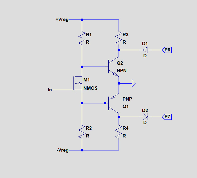

Below is the soft start circuit.
The Nmos is open at start up, so both transistors are conducting, forcing P6 and P7 to Gnd.
After a few seconds, the Nmos will become a short circuit because of a cap being charged slowly.
In that case both transistors will switch off, thereby releasing P6 and P7.
HOWEVER, suppose +Vreg is 1 volt lower as -Vreg.
Then the voltage on the Nmos through R1 and R2 will become -0.5Volt, thereby opening Q1 the PNP, so P7 will be forced to shut down while P6 will continue to operate.
This seems exactly what you describe.
Hans
