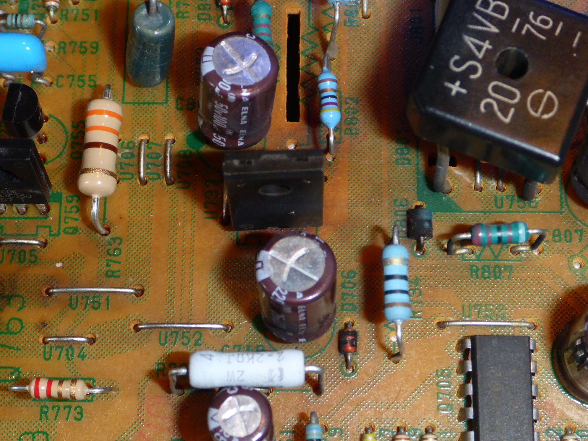

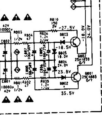

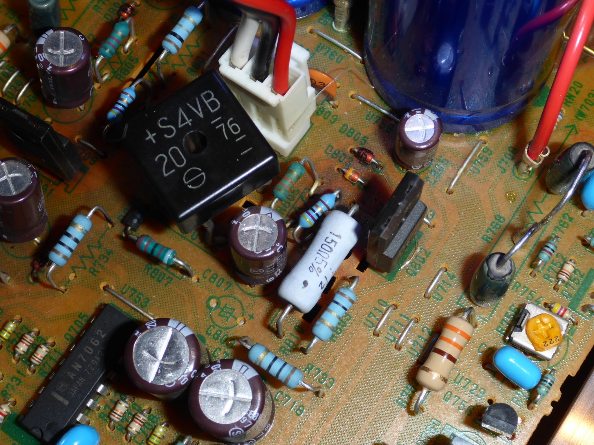

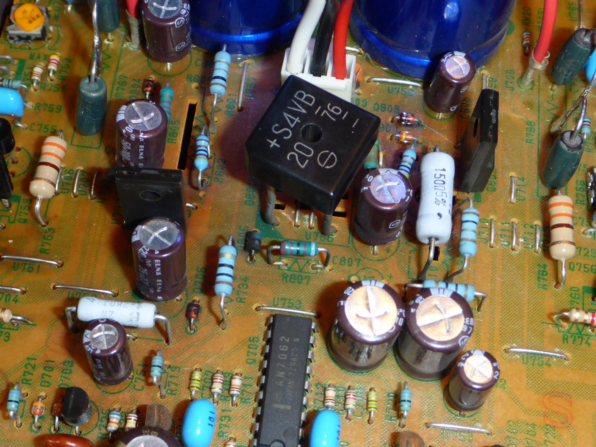

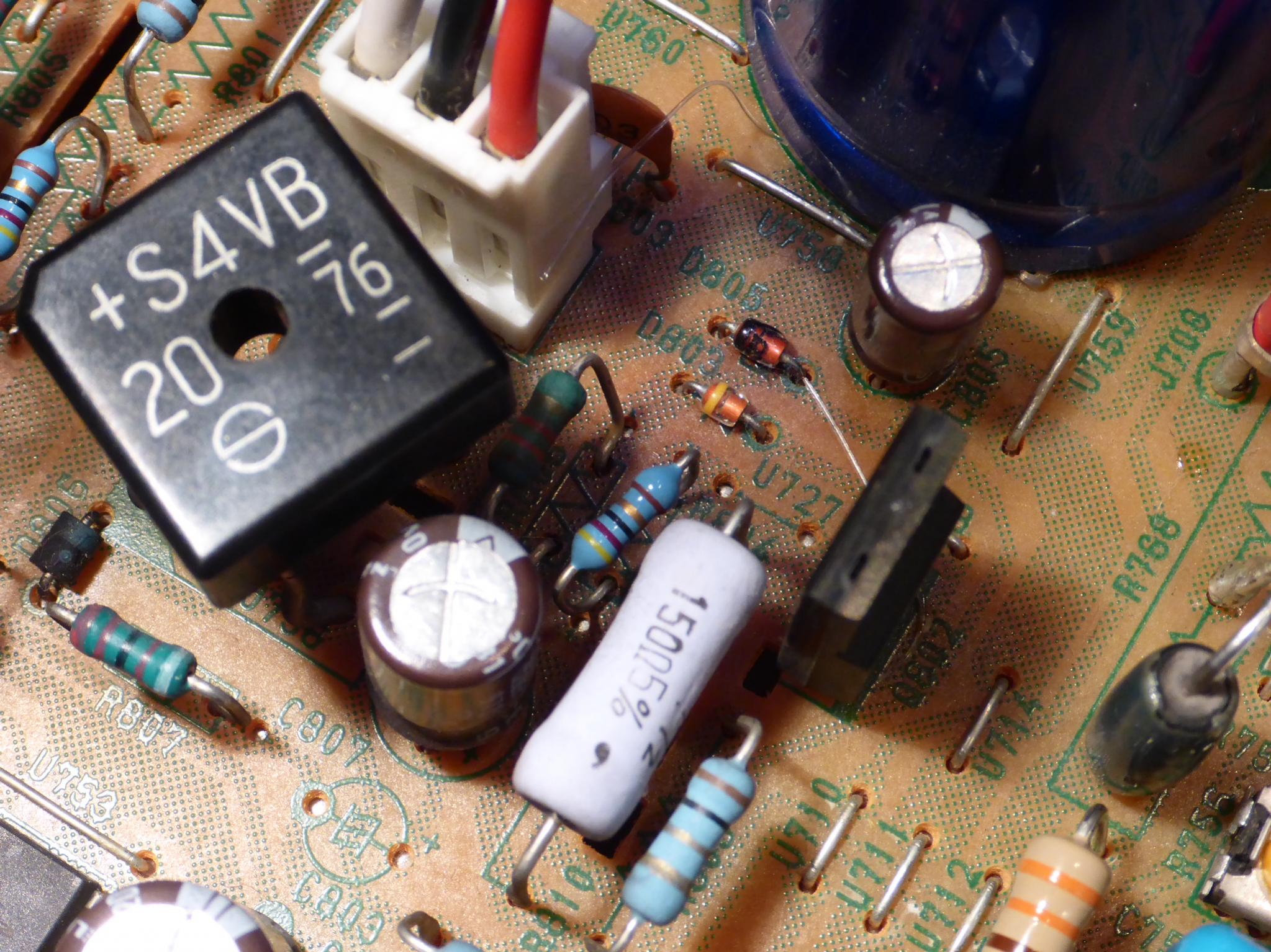

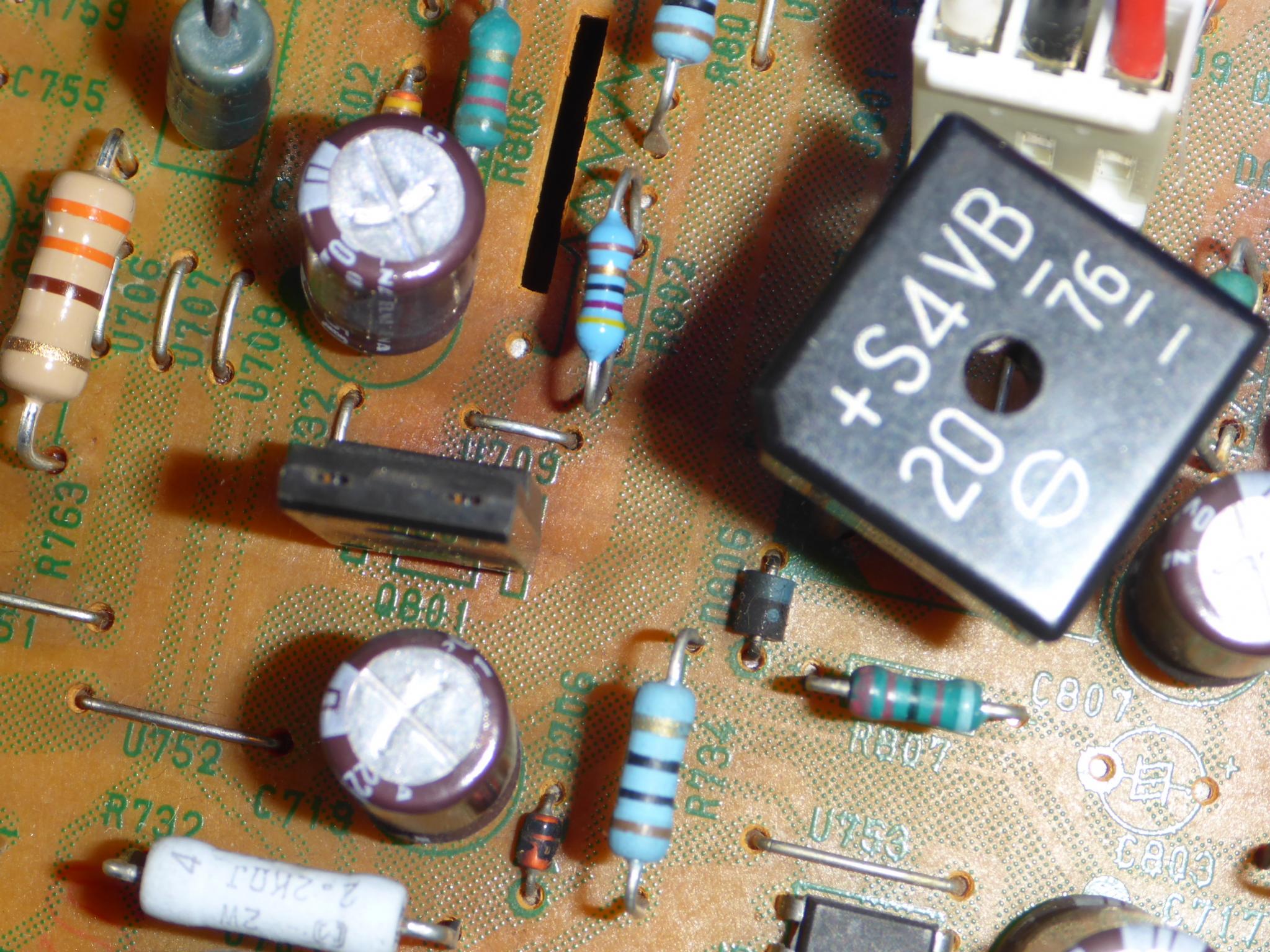

See attached photos, Q801 is to the left of S4VB. The board does look like it's got hot a round both of them. D806 looks a bit "dirty" in on of the photos. One of the photo shows a line coming from D805, it's actually a bit of "glue" from the main caps. Q801 & Q802 running about 45C, I'm surprised they are not on a heat sink.

That all looks fairly typical tbh. The brown paxolin type PCB material does discolour easily with heat. So that in itself is normal.
45C is OK too. It sounds hot but a rule of thumb is that if you can keep a finger pressed on it for at least 5 seconds without burning then its OK. If you look at the data sheets for any silicon transistor you will see typical max junction temperatures of around 150C. I've known transistors under fault conditions get so hot that they unsolder themselves and drop from the PCB, the transistor itself being OK still (although you wouldn't re-use it).
I would just make the comment that those parts that are running hot are the most likely to suffer from soldering problems. Typically you will try and resolder them and find the new solder doesn't "take" cleanly.
The only other possible question mark would be... is either Q801 or Q802 failing intermittent open circuit... which would remove a rail and cause big problems. If that happened both channels would be affected though.
