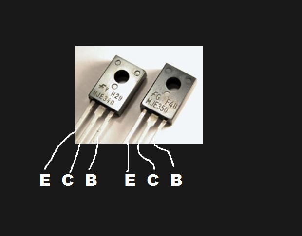

The writing should be on the side that I can't see... is it ?
Are saying that you should be able to see the metal back of Q759?
The left most pin of Q759 is "connected" to the right pin of r773. The left most pin of Q759 should be the emitter, if I understand correctly
And the further checks. Middle leads of all those three transistors on the heatsink do not read short circuit to the chassis... showing the insulating pads are correctly fitted.
Is it ? Its difficult trying to make it out without a board layout. So the white lines I drew actually go to the left pin of the transistor... if so you have it correct.
nope, the all measure between 99k to 2m ohms

OK, so on the digram the emitter of Q759 goto R773. And your picture of the 340 showed the left pin 3 as the emitter, I assumed the picture showed the frontside (writing side) of the component
so if those two facts are true, the measuring 00.4 ohm between the left pin Q759 and r773 should means that at least that one pin is in the correct place
Lets slow down, one thing at a time 🙂
You mean the three transistors on the heatsink read 99 to 2meg. That's correct if so, indicating they are not reading short circuit to the metalwork.
Correct, I'm don't think I implied they were in short circuit 🙂
That's correct. Emitter of Q759 to R773
That's correct too. The picture show the front of the device so you should see the writing

OK, some how I missed post #60 with the picture an the red arrow. The red arrow is pointing to the backside. And the side that you can see is the writing side. But the writing doesn't come out on the picture
So I think Q759 and Q757 are in the right places.
Ok, so R755 is turned up to the max, which is about 2200 ohms
Lets be sure and carry on tomorrow.
If you look at post #46 I drew the transistor symbols showing E,C and B, so you can draw those letters on the schematic if you want and then check the transistor orientation that way. The picture in post #68 shows the exact pin outs.
