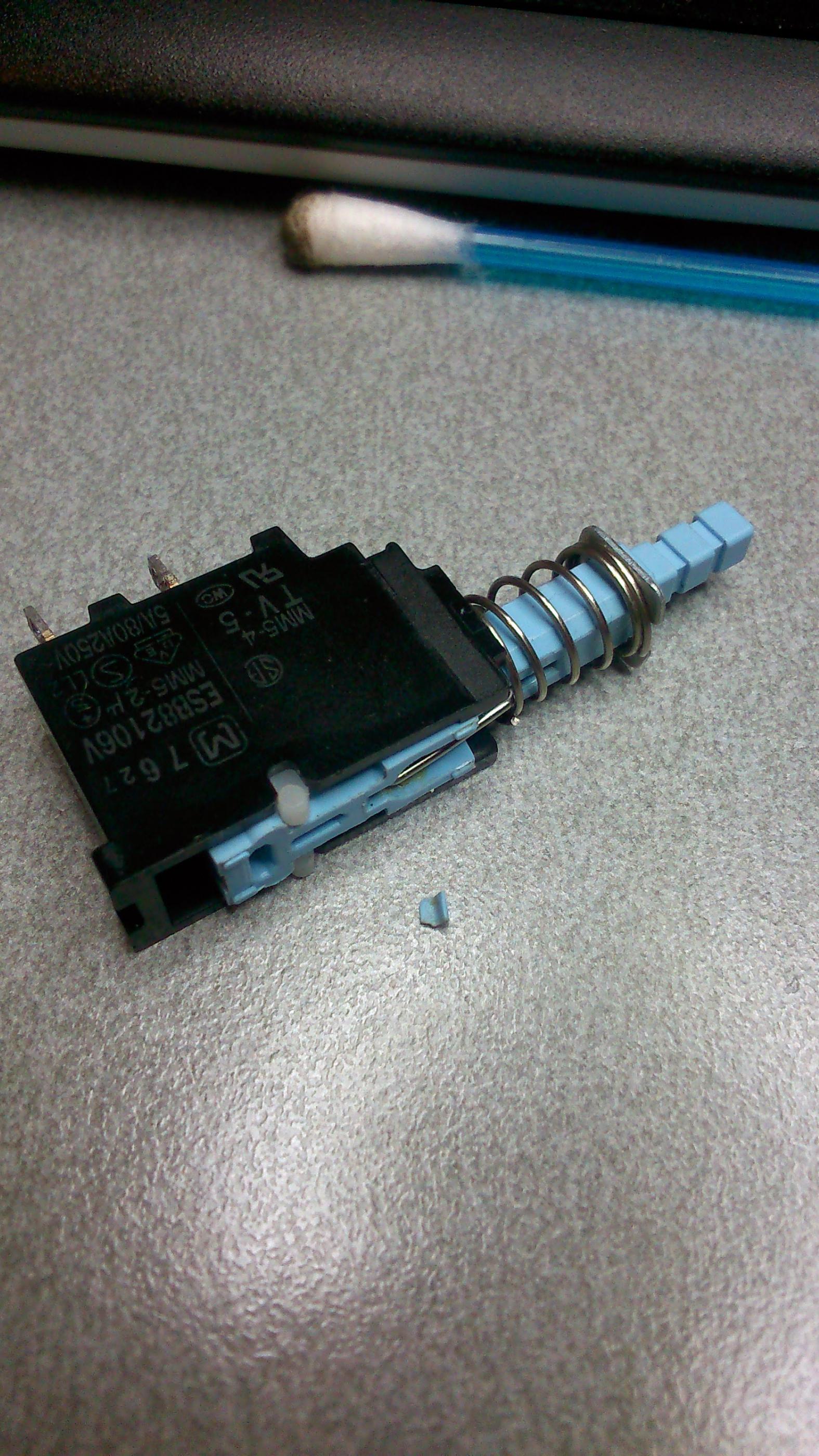

Just took a part again, yep it's the power switch.
That must be a one in a million fault on a unit like this... wonder if it could have been arcing or doing something strange and that is the cause of all the problems. I wonder how unique it is physically, to replace with an off the shelf item... although the days of such spares being readily available have rapidly declined.
Its easy enough to link the switch out of course to make sure it all works. So I dunno on that one, getting a replacement could be tricky although I haven't looked.

Right style, more like this
http://www.uxcell.com/250v-40a-self-locking-spst-push-button-power-switch-sw3-pcs-p-293761.html
the picture is of it but with the metal casing top removed, so see it the pin and become dislodged. but the was just a bit of loose blue plastic...
body H18mm x D 27 X 10
total length 44mm

thanks, looking at the data sheet that's exactly it.

BTW I think I've the found reason lost for the loss of channel. The ribbon cable going from the master volume knob board to connector was a bit dodgy, and the case top pushed it in such a way to lose a channel. It was fairly obvious as case off both channels case on one channel.
I think your theory about the switch arcing may have been correct, the internal contact were cover with black carbon deposit, but I couldn't see any pitting. All these type of switch might look like that inside, I'm in the habit of opening them up too often. So place a link in where the switch should be, while I try a reasonable way of sourcing another. I've got to say I can live with it.
Dodgy switches can certainly be a cause of problems, used to see it a lot in the earlier days of TV repair. The ribbon cable sounds another unusual problem (on a Marantz anyway), great you found the problem though.
the ribbon was Ok, but the connector on the supplementary volume board had a dry joint. which 90% time was ok, but if the ribbon pushed the connector in a certain way then it lost a channel.
