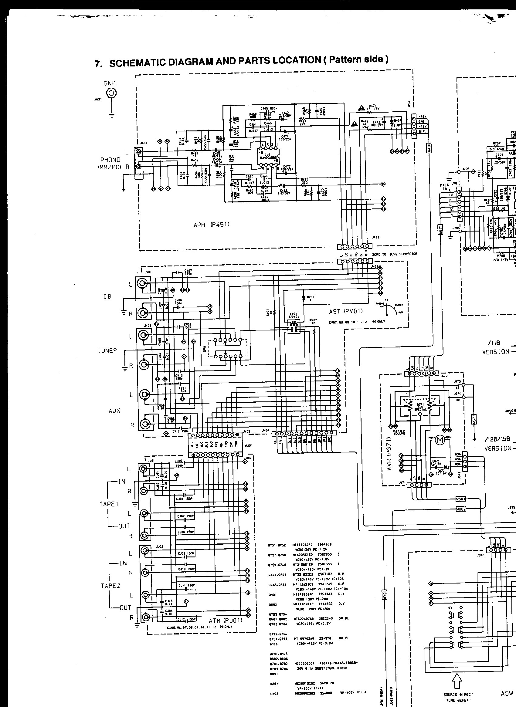

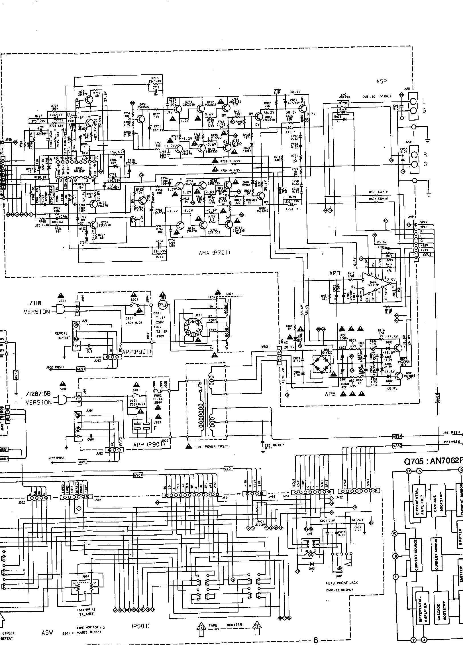

Biggest problem up to now is getting a correct diagram.
This might help, but I'm not sure it is the KI version (probably it uses some better quality components, same circuits)

No problem :) although I see its a .rar file. Can you post a .jpg of it ?
It will be tomorrow before I can take another look, but with the correct circuit all things are possible. Have a check of the low value resistors around the zapped transistors and we'll take it from there.
Administrator
Joined 2007
Thanks, got the full 8mb one too.
OK... so the resistors to check are,
R767 that's the dual 0.1 ohm.
R765 and R773. Both 2.2 ohm.
R763 a 330 ohm.
R757 and R759. Both 100 ohm
R761 a 1k
The transistors Q761 and Q763 are zapped. The driver transistors would be replaced anyway whether they read OK or not. That's Q757 and Q759. The pre drivers, Q753 and Q755 would also possibly be replaced.
Lets see what the damage is first.
