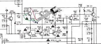

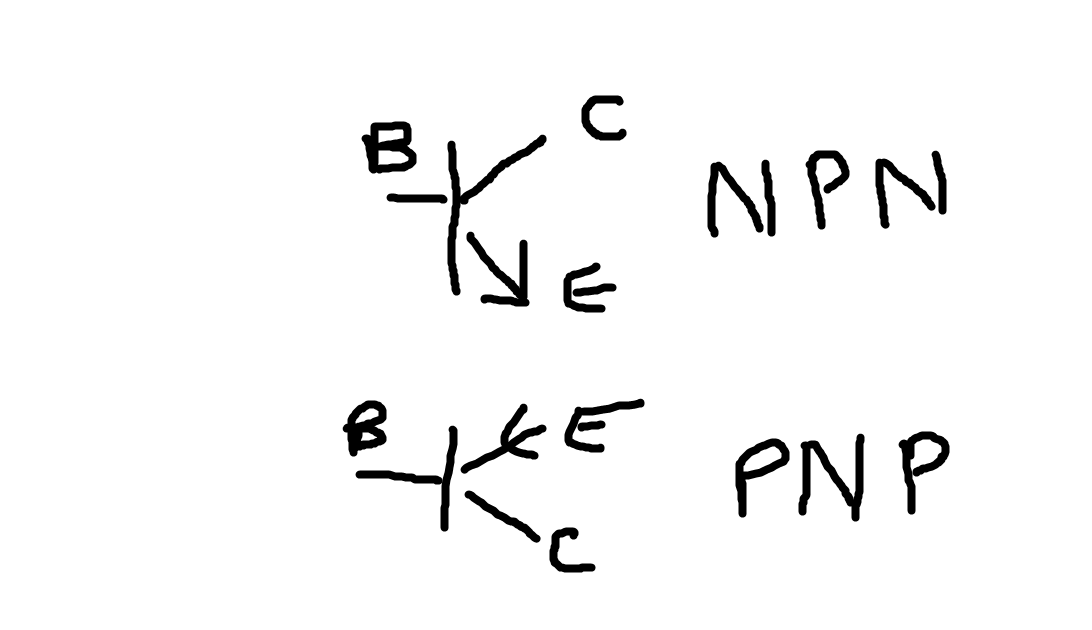

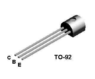

Q753 (originally 2SC2240) will be replaced with either a 2N5551 or an MPSA42. If you have the choice use the 2N devices. Notice how the arrow points outward. That means it is an NPN device.
The pinouts are the same for the MPSA and 2N devices but these are different to the originals. So you will have to neatly bend the leads so they fit correctly.
Q755 is replaced in the same way using either the 2N5401 or MPSA92.

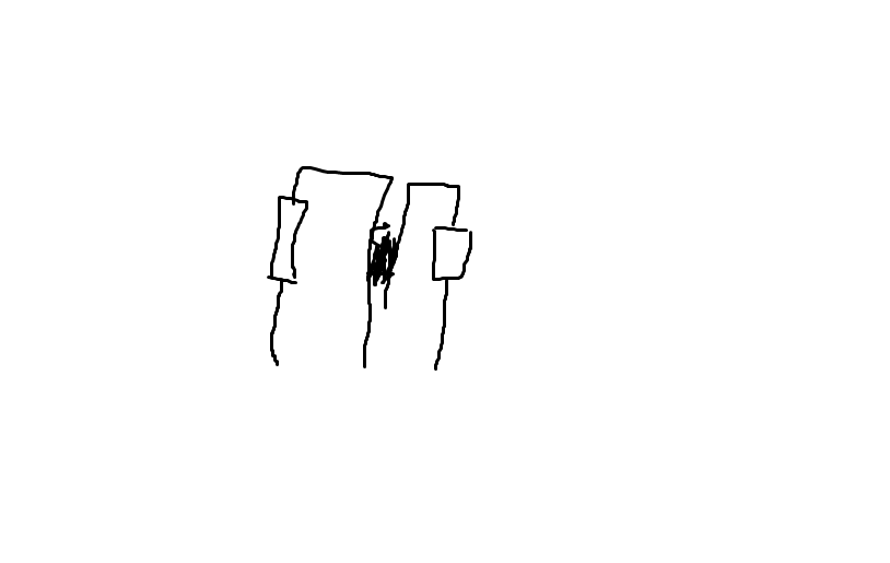

OK, I've done the resistors and put in Q753 Q755. but I just want to check I've place them right.
Originals = ECB
replacement = CBE
(when viewed from the roundside)
So if I insert the replacement 180 degree, with the base and collect pins swapped, then I should be good

That sounds OK but describing things is always difficult. I would measure and be sure. Use your meter on its lowest ohms range and confirm for Q753 that the base (middle leg of transistor) connects directly to one end of R757. Now look at the diagram in post #47 for transistor. Confirm that the lead marked C for collector connects directly to the positive rail and confirm that the emitter connects directly to R761.
Then double check that the device is correct, either the 2N5551 or the MPSA42.
Then repeat the process for Q755 confirming the middle leg of the transistor goes to R759 and that the collector goes to the negative rail. The emitter should go to the other end of R761. Now double check the device is the correct one, 2N5401 or MPSA92.

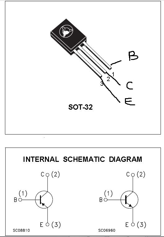

The next pair are easier because the base is at one end and not in the middle. Look at the diagram in post #47. This is looking down on the device (so you should see the markings).
The MJE340 replaces Q757. Makes sure the base connects directly to R761 and that the emitter goes to the 330 ohm and 2.2 ohm.
The MJE350 replaces Q759. As before, check the base goes to the other end of R761 and the emitter to the 330 and 2.2 ohms.
Keep referring to the circuit and checking and it will make more sense.

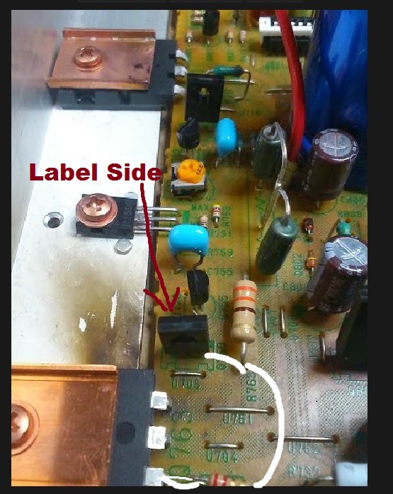

I've put in Q753, Q755 , Q757, Q759 on the board last night, but is it was late so I didn't snip the legs as I wanted to check this morning when I was wake.
Q757/9 seemed simple, it was Q753/5 I thought I may have got wrong. But I'll check these at lunchtime.

You have to be absolutely sure on these. If you want to post a picture of them then that might help with checking.
The outputs should be straightforward... but whatever you do don't attempt to power it up yet.
I'm pretty sure, if I ignore the original components datasheet and do it by empirical tests, using multimeters test and the circuit diagram it all looks good.
I'm looking at the picture. Q759 which should be an MJE350... I can't see the writing on the device which would identify whether its the right way round.
The writing should be on the side that I can't see... is it ?
