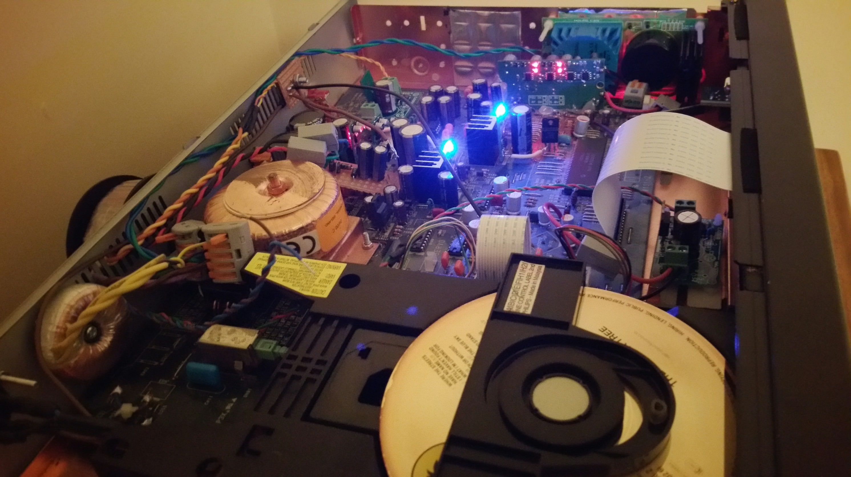

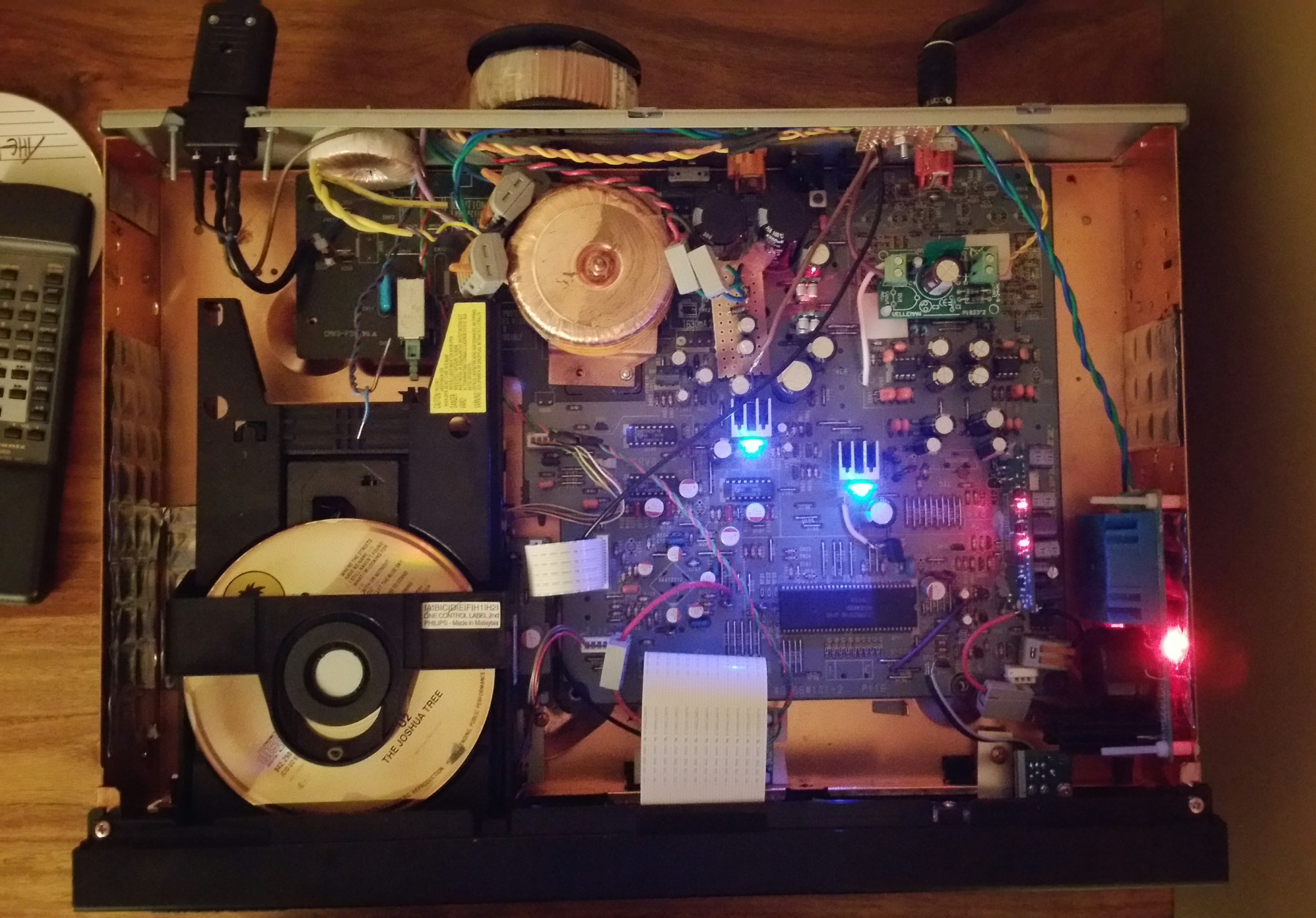

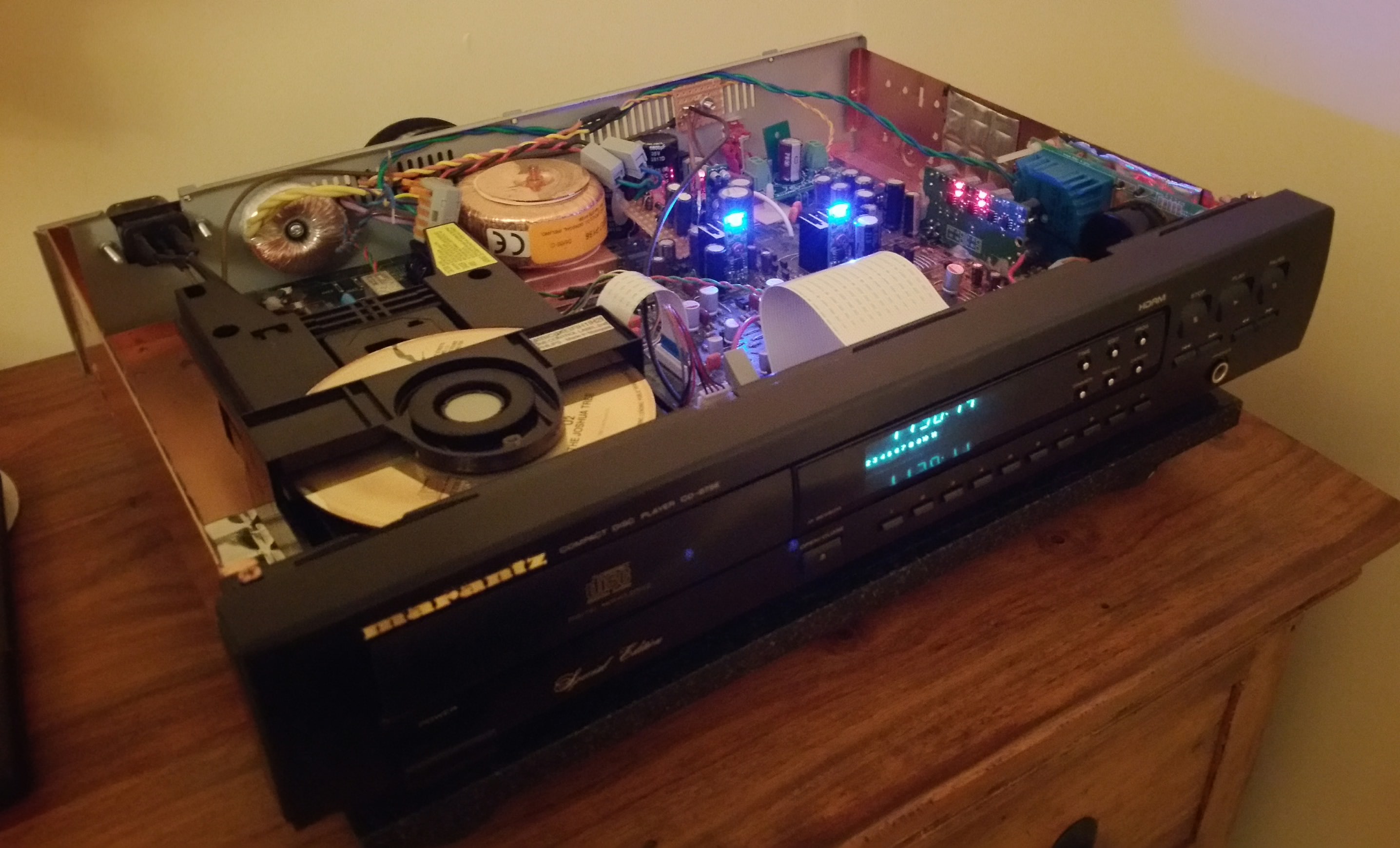

So I've fitted an external 2x9V Tx to the rear of the chassis now and used it to feed the servo and the Dac analogue on my CD67. I added a small AC-DC pcb where the fuses used to be and injected the new pre-reg DC voltage in to U264. This means that the 9.3V secondary of my KI Tx now only feeds Q811 (which in turn is feeding DAC digital and the decoder) and an added 7805 feeding the U-com and display (via U156...I think).
I have one more very small 2 x 9V to add for the decoder analogue and digital, then I was going to add another regulator for the HF amp (still fed via the Ki Tx). This should leave Q811 to feed only the DAC digital.

Here's some pics from today. Added my small 2x9V and hooked up one of the secondaries to a dedicated decoder PSU just behind the display panel. I'll be adding a second here to further divide the decoder in analogue and digital.

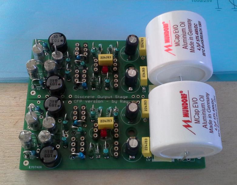

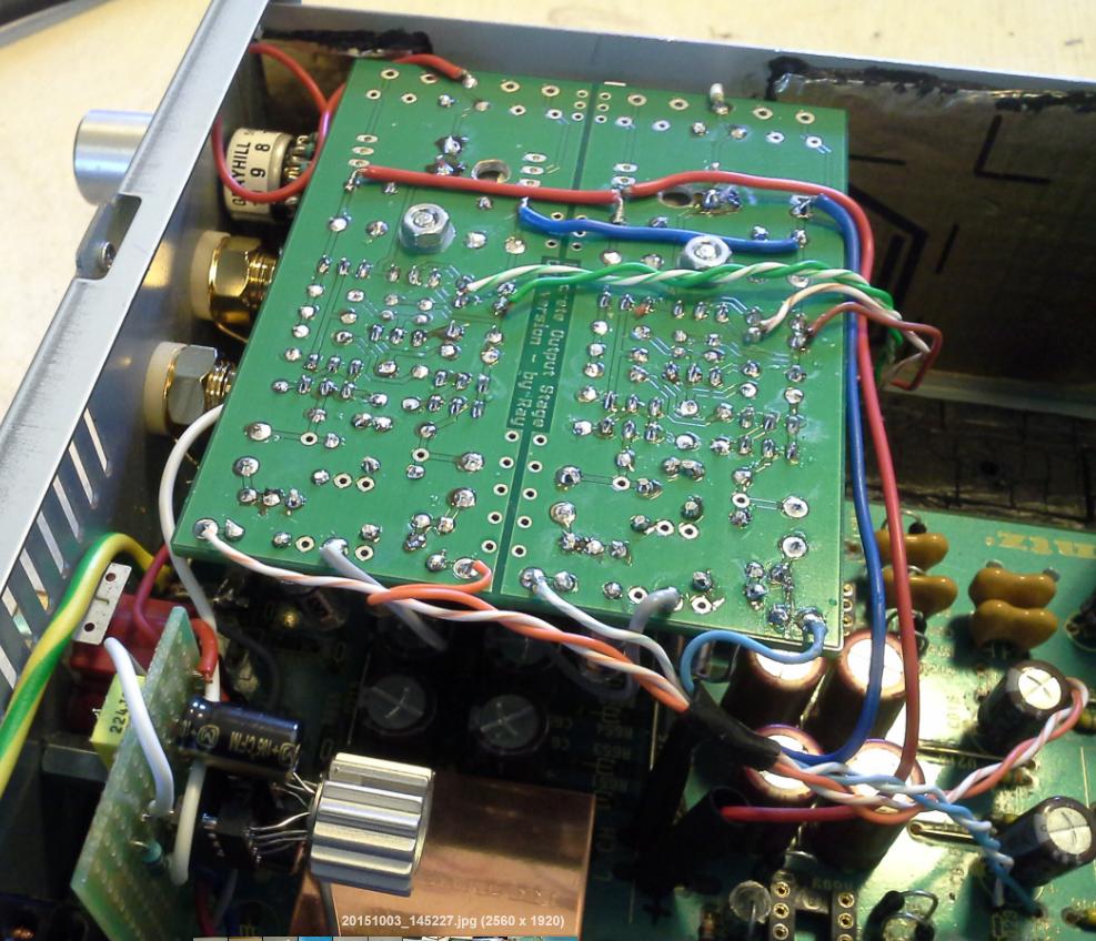

OK, some pics of the DOS and "DOS-corner" of my player (the board on the picture is without transistors).
The opamp buffer to drive a 6m cable is on the left.
On the middle picture the attenuator for adjusting R14 value (between 10R and 50R) is visible.

Those caps seem a little over-sized? 450VDC...how much offset you do you have?? :p
Most probably less than 15V ;)
These are the Mundorf MCap EVO Oil ones (decide to try out the "audiophilic feeling" ;-) ) - I don't think they come in much less voltage in this capacity range...
And they look nice ...
Nichicon Muse bipolar electrolytics are remarkably smaller.
