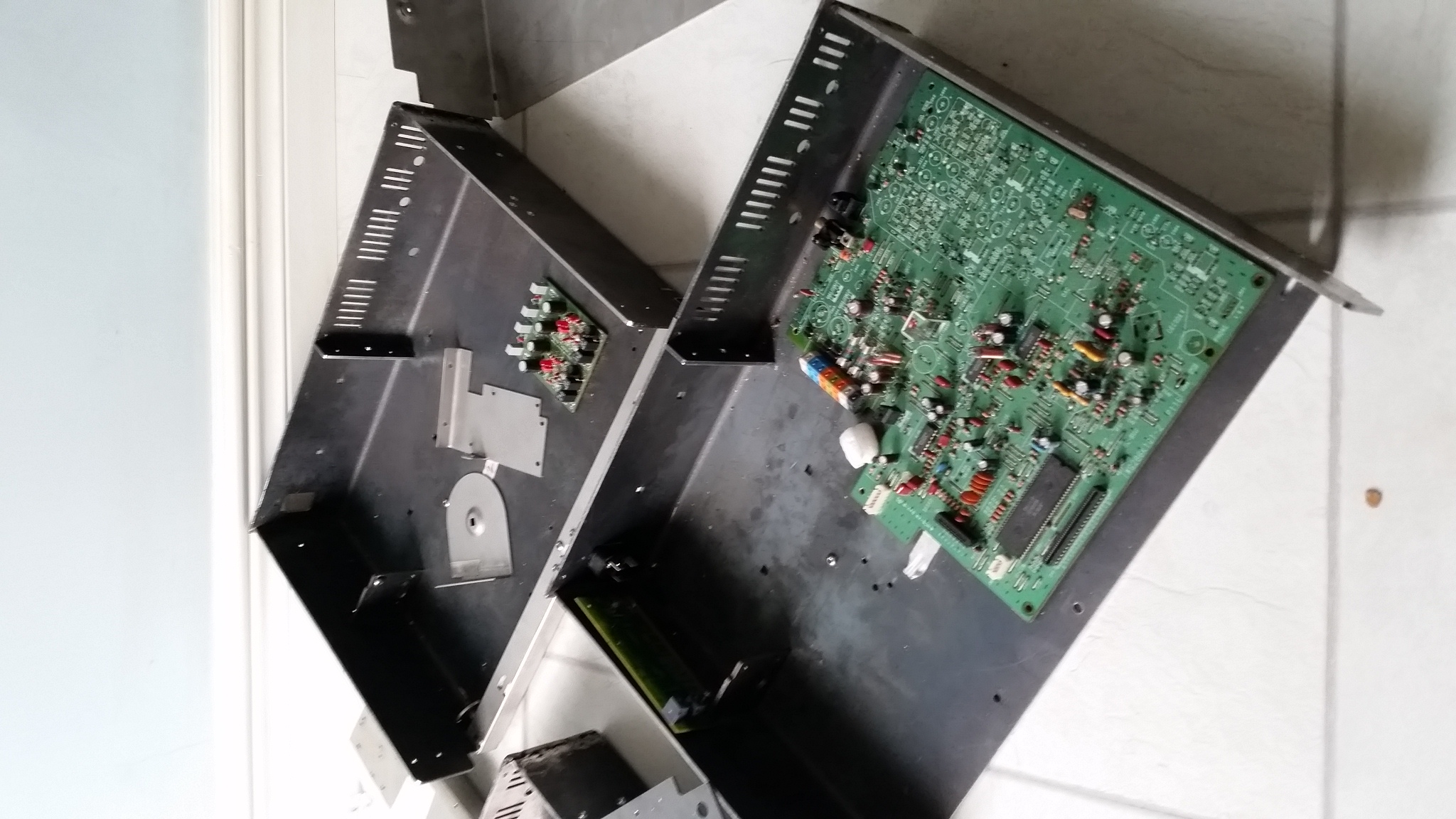

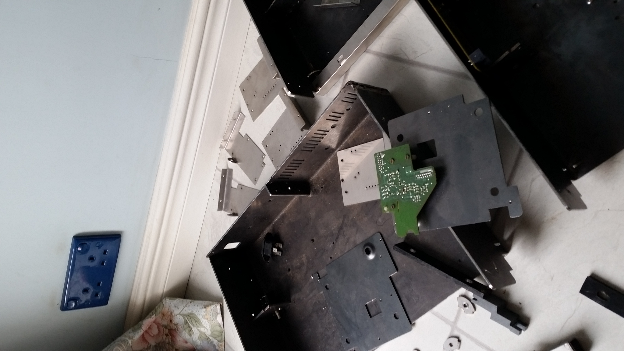

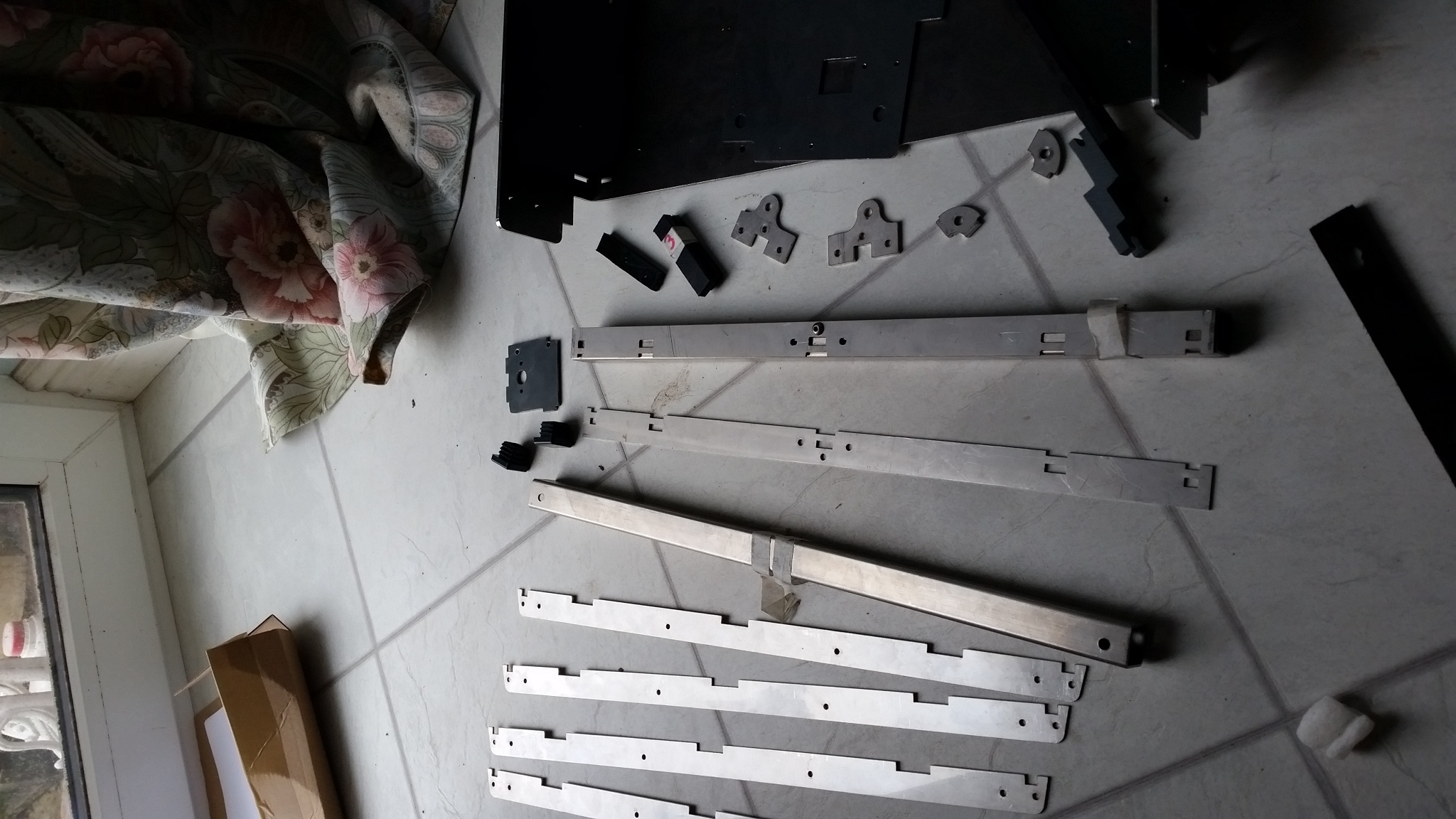

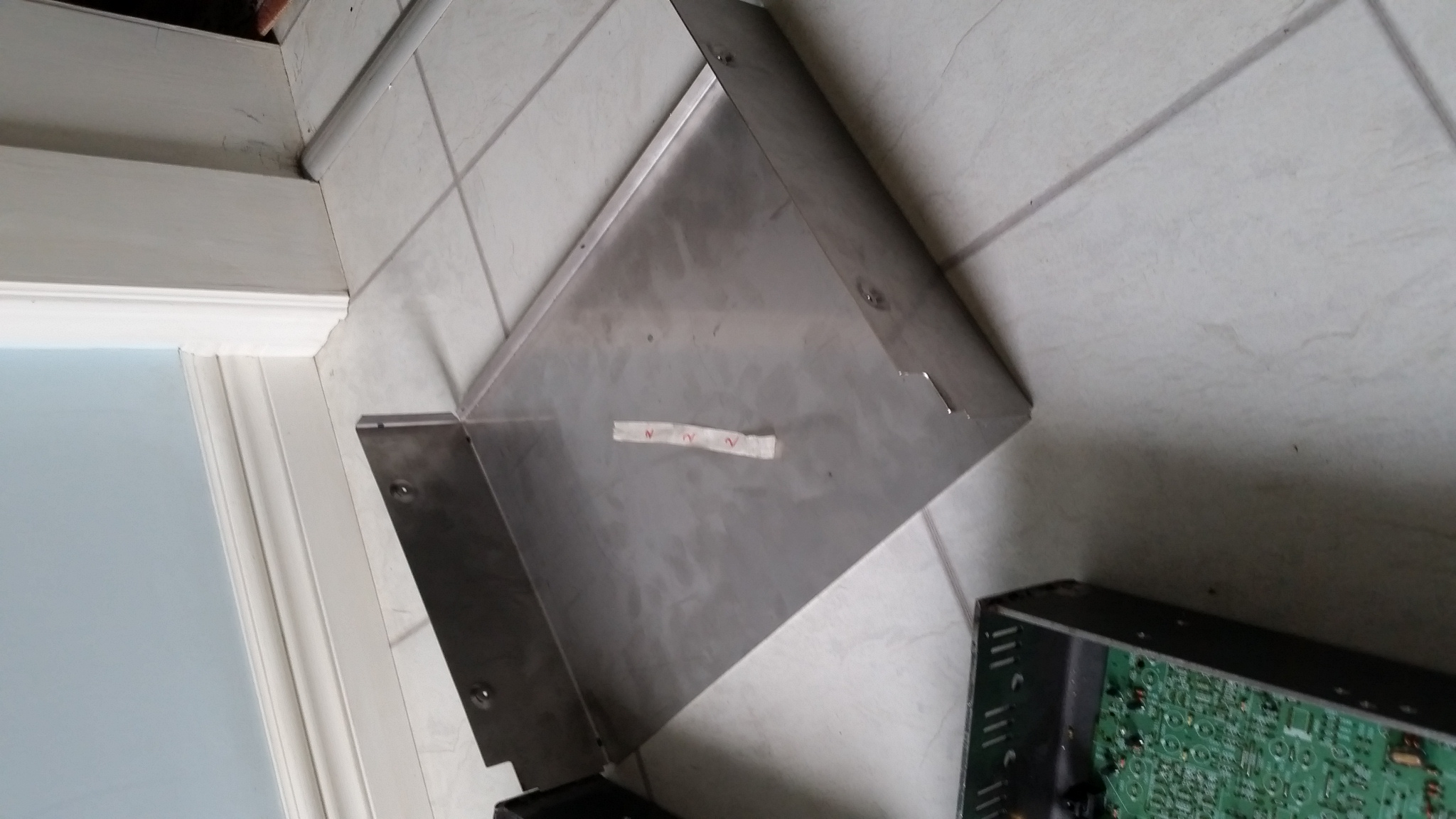

RCruz The project is still ongoing, it ground to a halt over 12 months ago, I have had just too many other things to do, hope to get things going again soon.
Firstly I had to figure out how to use the software for creating DXF files for laser cutting, the main chassis was cut and folded by someone in Ireland. Most of the rest of the pieces I had cut by Laser Cutting & Engraving Services | Home | Cutting Technologies Ltd , I then had to become reacquainted with metalwork, the main chassis' I had made needed a little tweaking, I also folded the smaller parts myself in a large vice with these Vice Brake - Adjustable Vice Jaw Bender Sheet Metal Bending.
The lids were folded by a small company in Birmingham.
the recesses in the lids where the screws go were also done with the aid of my vice. The welding was done by myself(never previously done any) Here are some pictures of some of the parts I have gathering dust.

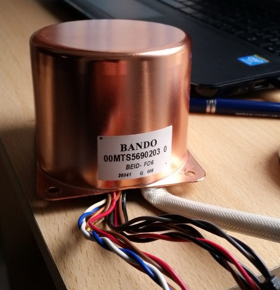

Transformers
I have two of these SA11 transformers bought on Ebay off Brent,
I am planning on fitting one plus two other transformers, I also intend fitting a headphone amplifier(the wire).
Intend fitting as follows
SA11 transformer
Blue/White = 8.2v to Dac supply flea(clock)
Yel/Org = 13.2v to analogue supply dos(left)
Red/Brn = 13.2v to analogue supply dos(right)
Brn/blk = 17.7v to Display / muting unused
Red/Blk = 13.3v to Servo 12v / 8v supply (motors etc) headphone amp
Gry/Blk = 7.8v to Servo 5v supply (for servo digital) flea(servo)
additional transformers
50va 12v to u308 u310
smaller 12v to u305 u311 u312
(possibly a separate 6v transformer for u312)
I was wondering if anyone could suggest a use for the 17.7v supply.
