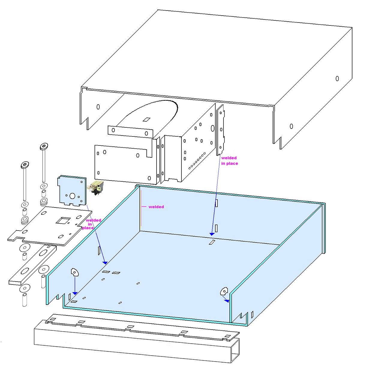

As things seem to have gone quiet thought I would post a partially complete drawing of a larger chassis I have been working on for the CD63.
The largest piece being 3mm steel which I have yet to get copper plated and the lid 1.2mm stainless steel.
I would rather have a one box player than a separate box for transformers.
not sure I have uploaded the picture correctly till I post.

Good job.
Would you share with us your box provider ?
