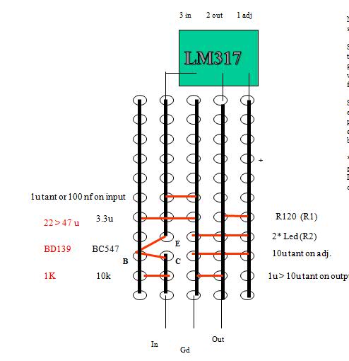

Thanks Ray and Pete for confirming the pin layouts on the regs. Ray, that circuit diagram is what I've been using to build these regs, just want to double check the diode layout - cathode of IN4148 to ground, anode to anode of LED/Zener, cathode of LED/Zener to adj pin, correct? I'll double check my circuit layout; if I can't find any errors it may be that I've fried the BC547 as I soldered this in the wrong position originally, then had to desolder and re-solder correctly - may have got it too hot for too long...
Thanks again - I will get this sorted, then there will be a proliferation of super-Raygulators in my 63🙂
That's almost right! The LED needs to be connected with it's cathode towards ground. A zener goes with the anode towards ground.
It seems a bit odd, but that's because a zener is actually working in reverse mode and then breaks down to it's zener-voltage. A normal diode and an LED work in forward conducting mode.
Brilliant - thanks Ray! I've got the LED backwards at the moment, then, no wonder it doesn't work! I'll swap it round and re-test, there may be life in the BC547 yet😉

If it helps, this is how I build my 5v regs. 2*led are in series, combination of leds selected to give near 3.75v.
Red is for if you need more current (> 50ma)

My Super-Raygulator lives! I've turned the LED round 😱 and now get 4.82V out - is this sufficient for the DAC and other 5V circuits? I know why its a bit under - I was expecting the IN4148 to drop 0.7V but having read the datasheet it actually drops 1.0V. I can easily get some different LED's if needed.
Great!
The output voltage is a bit low though. You can combine different colors of LEDs and diodes to get the desired voltage of 3.75V. I can take a bit of experimenting to get it right.
Easier fix, reduce the value of the resistor feeding the LEDs - drop it to something like 220ohms or even 100, to push more current through the LEDs. The voltage will rise because the LED dynamic reistance is not zero but a very few tens of ohms (reducing slightly as you pour more curent through them.)
But to answer your question - yes 4.8x volts is enough for '5v' elements. 5v logic levels require a +/-5% tolerance, so 4.75-5.25v is all ok.
