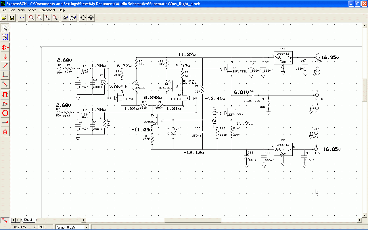

Okay, I've attached a pic of the one of the channels in my DOS. The voltages that matter the most are the ones on each side of R9 and R10. In this channel they are 0.03v different. The other channel is 0.05v different. You want the voltages within a few hundredth's of a volt. You do NOT want the voltages varying by a couple of tenth's
Also take not that I have exactly the same voltages entering the differential. This is the same in both channels.
My voltage readings are not quite perfect, but they are pretty close. I think this is a target to go for.
BTW, my DOS is in my SA-8260 player and not a CD-63/67. It's not really the numbers that matter, it is the relation to each other than matters.

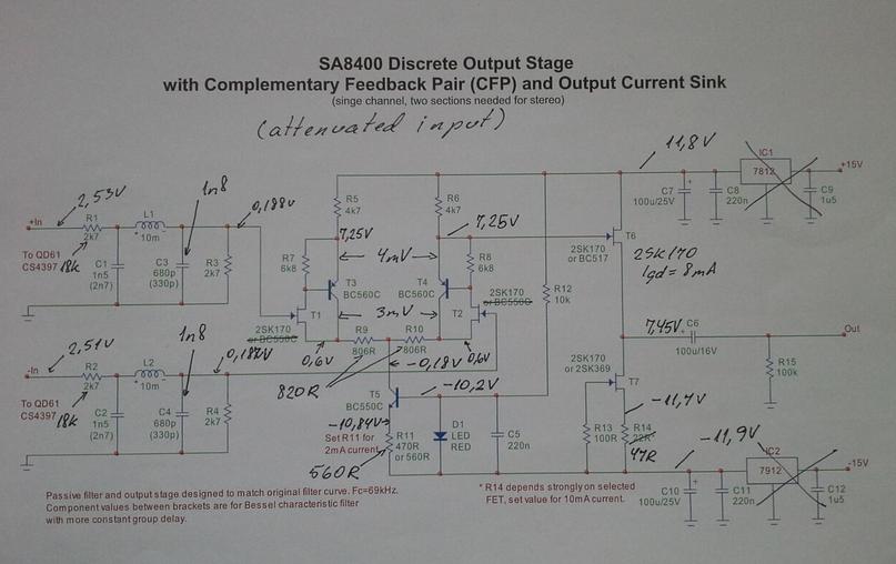

When I assembled my (first) DOS board then Ray was kind enough to run a simulation on its schematics when I asked him about what voltages I should be going after (e.g. in the output stage I seem to be running on 8 mA instead of recommended 10 mA - but today it does not hurt my ears one tiny leetle bit ;-) ).
So attached it is.
Next time when I open my player I will perhaps measure what I have got there and post it - just for comparison sake.
So attached it is.

Simulations are always perfect. Actual operating voltages are less so. How close the actual is to the sim determines how well it is operating.
OK, I had some spare time in the weekend so - out of curiocity - I measured the voltages on my active DOS board (see attachment).
Regarding symmetry of the input stage branches - eliminating the difference of 3...4 mV seems kind of serious effort taking into account resistor and transistor manufacturing tolerances etc (all resistors I used are 1%).

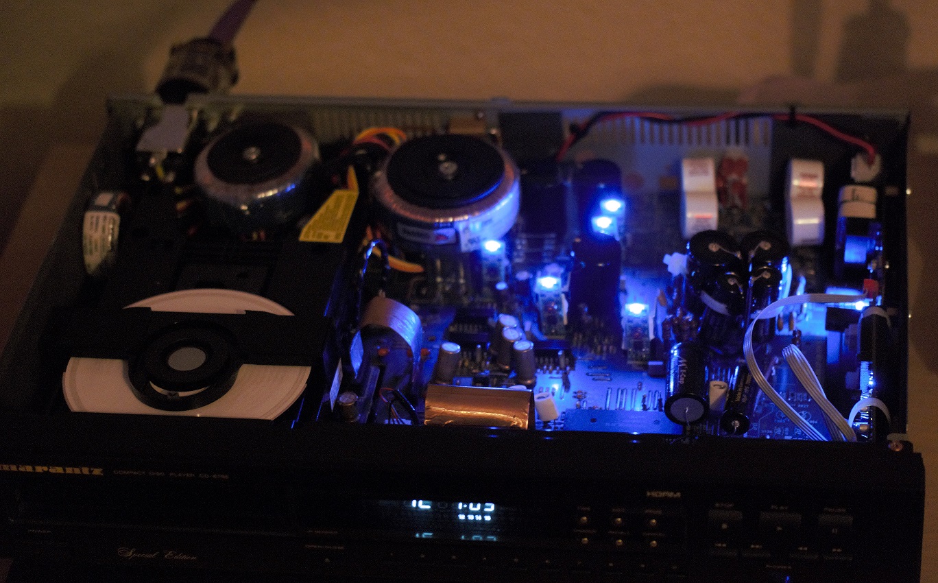

Just finished putting dexa NEUTRON with dedicated psu inside my cd67se
and all i can say it wouldn`t be possible without help of this thread.
Before i started modding my cd i didn`t know how to solder...but now i managed to fit 3 transaformers into this cd and it is all because of wast knowledge here.
Few pictures of my poorly done cd after my work 😀
THANKS for this thread guys. Stay awesome.

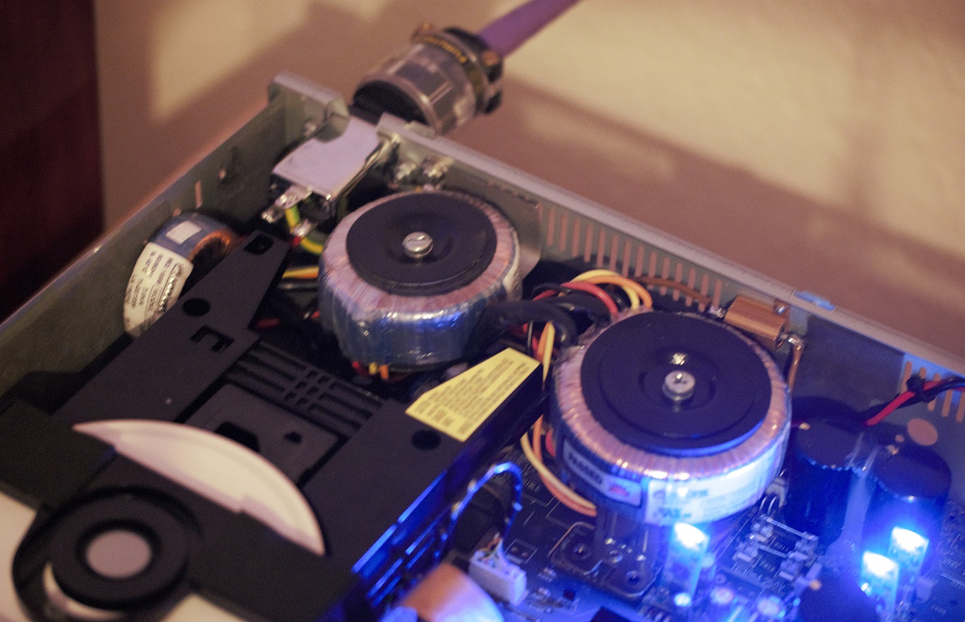

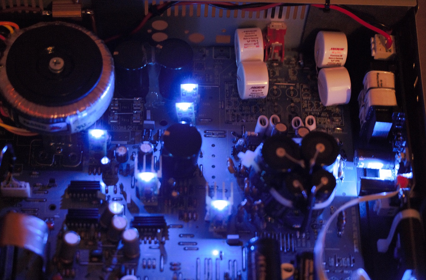

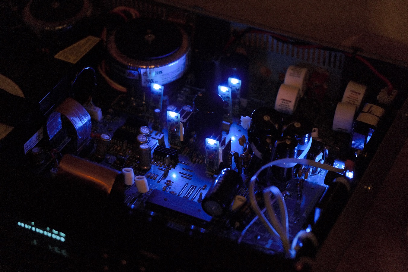

It looks great in there.
