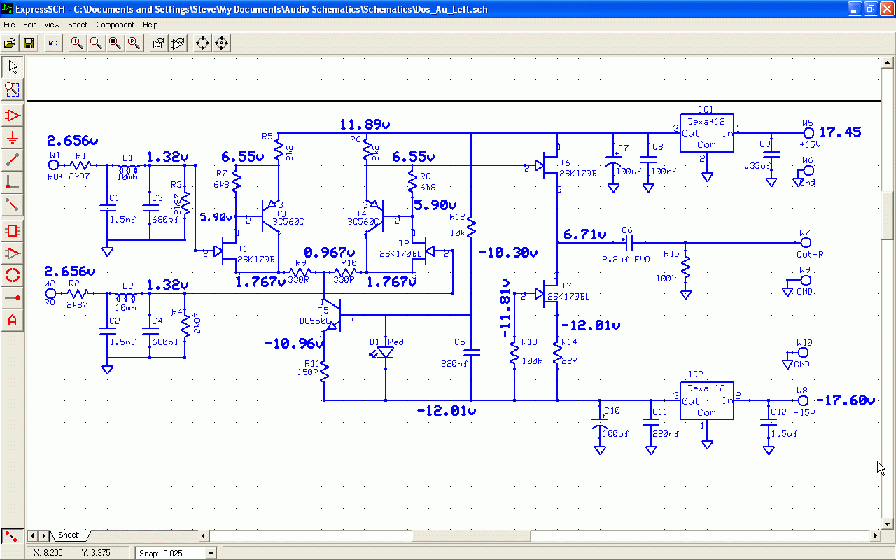

OK, I had some spare time in the weekend so - out of curiocity - I measured the voltages on my active DOS board (see attachment).
Regarding symmetry of the input stage branches - eliminating the difference of 3...4 mV seems kind of serious effort taking into account resistor and transistor manufacturing tolerances etc (all resistors I used are 1%).
I have now measured the DOS voltages another one of my SA-8260 players and have posted this below. In this DOS I used matched 2SK170's that Ray sent me. I was astounded to see the voltage matches at the gain stage resistors. The other channel in this DOS was not quite as good, but close.

You wouldn't be kind enough to upload here the ExpressSCH schematics file?
Perhaps ExpressSCH/PCB is a bit easier to learn than Eagle.
Nice 🙂
You can just download it yourself from the expresspcb.com website.
It a simple easy to use program for simple schematics. It's designed to link to their proprietary board software, which I used to use when I first started making boards.
I meant the DOS schematics file, not the Express software ...
I used Ray's schematic for the 8400 Dos. You can use that as a reference.
I was just hoping for a free ride ...😉
I couldn't attach my schematic. But it's rather easy to make one up as it's a rather simple circuit.
