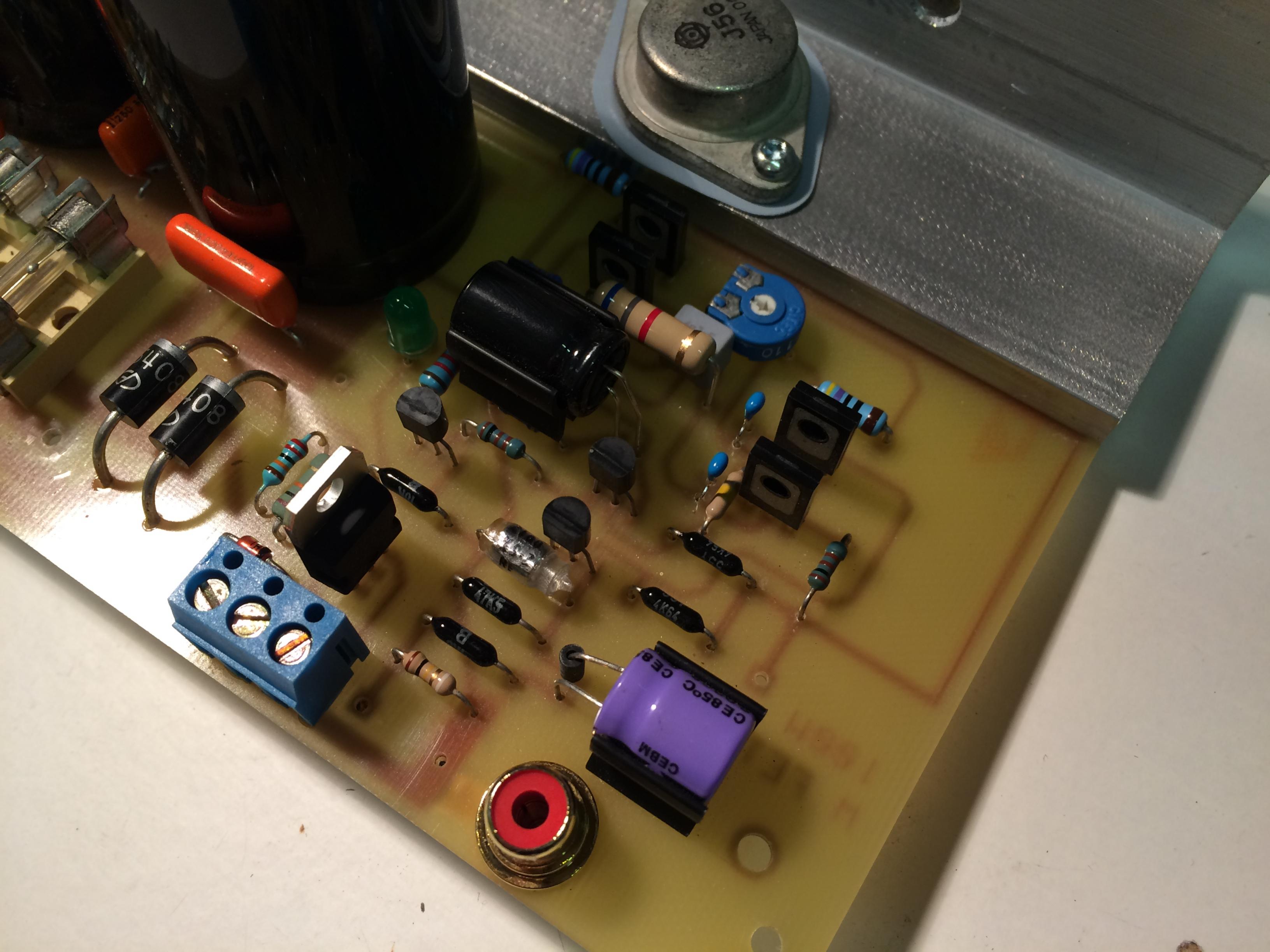

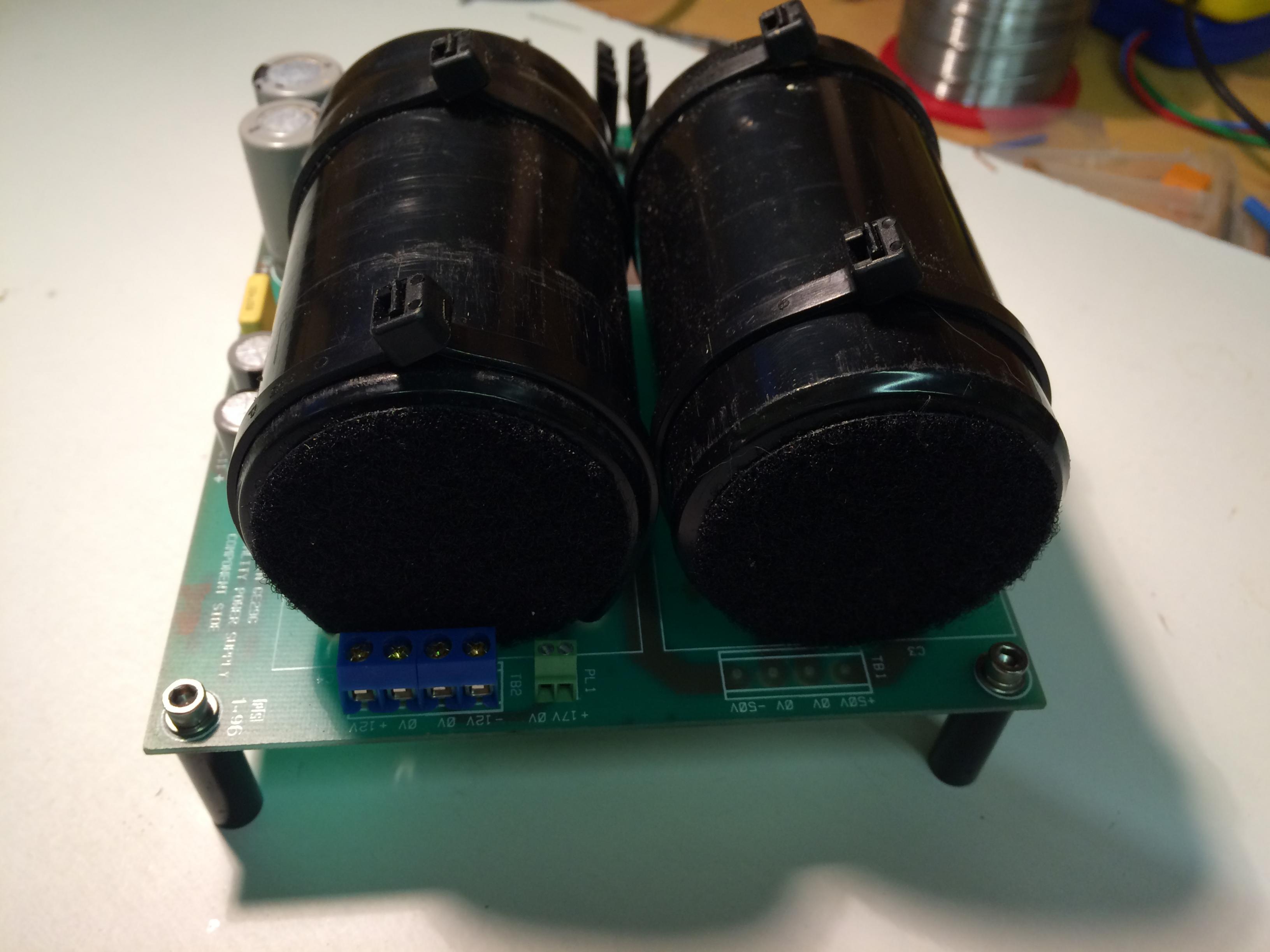

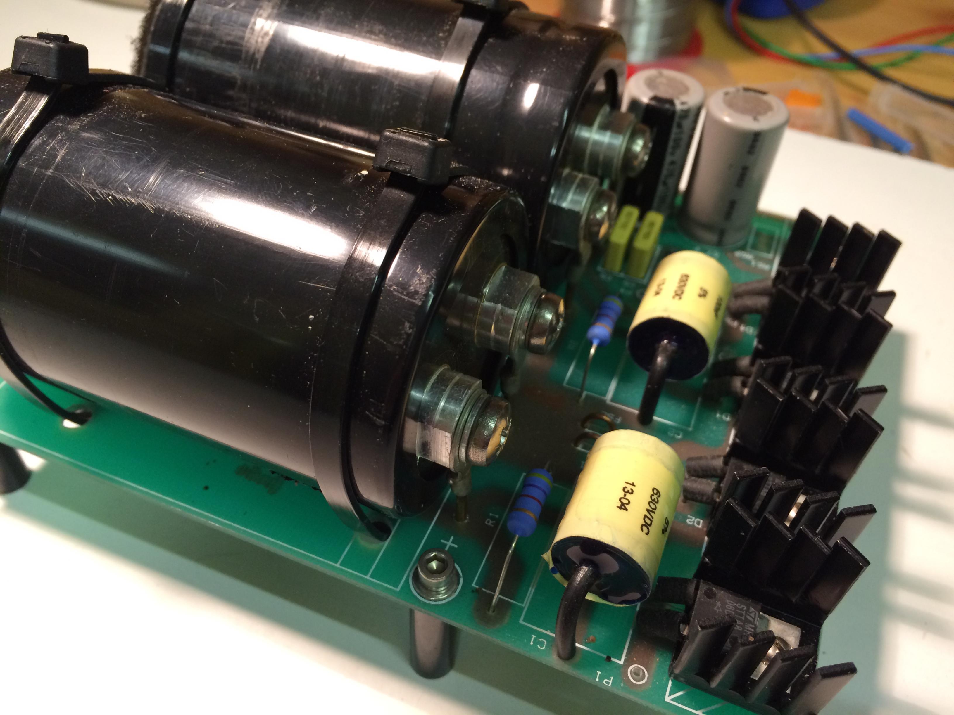

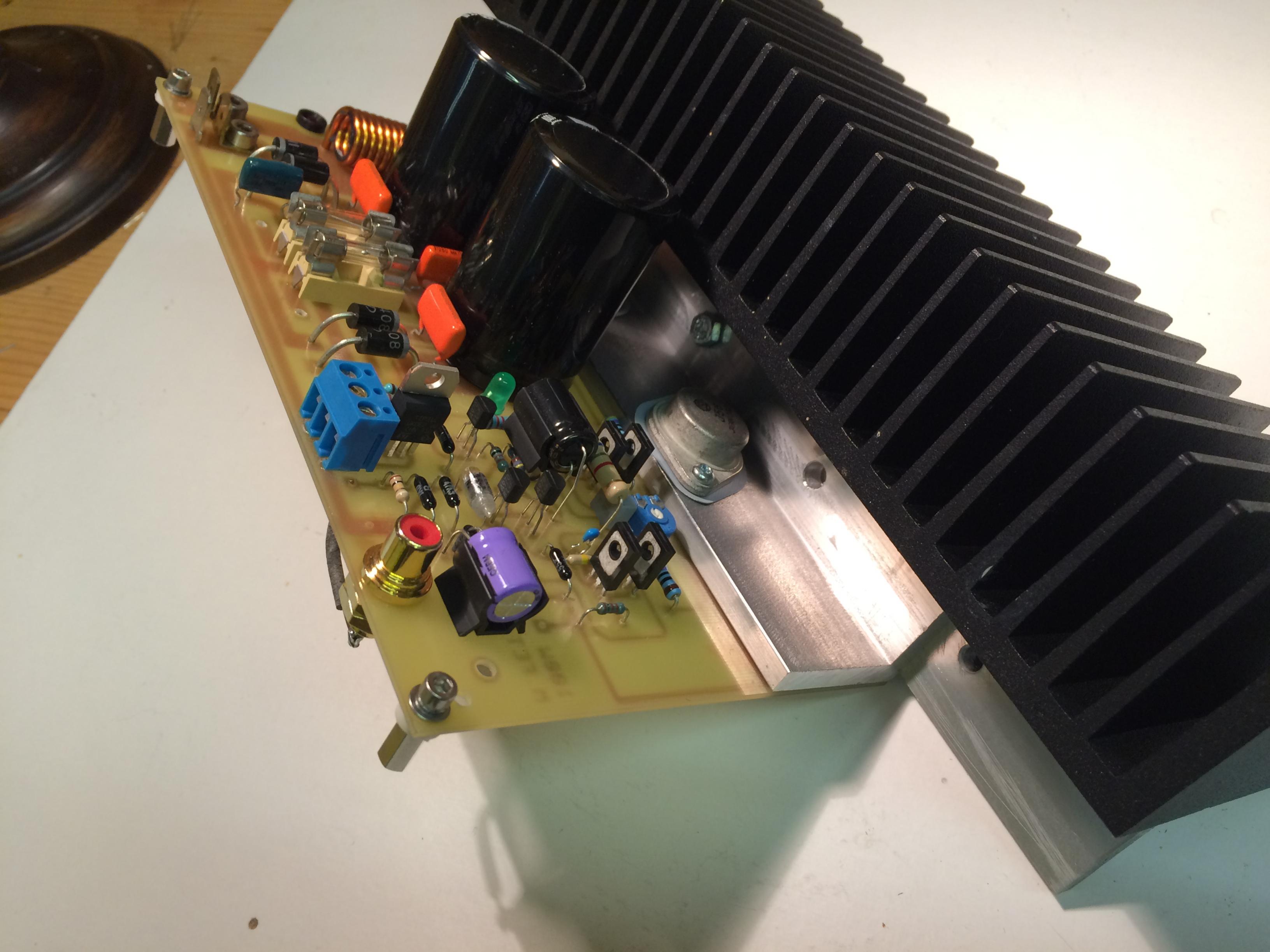

This is another version of the maplin mosfet amp I have been working on, basically the same circuit but with LED current source at the front end , and with BF470 / 469 driver transistors.

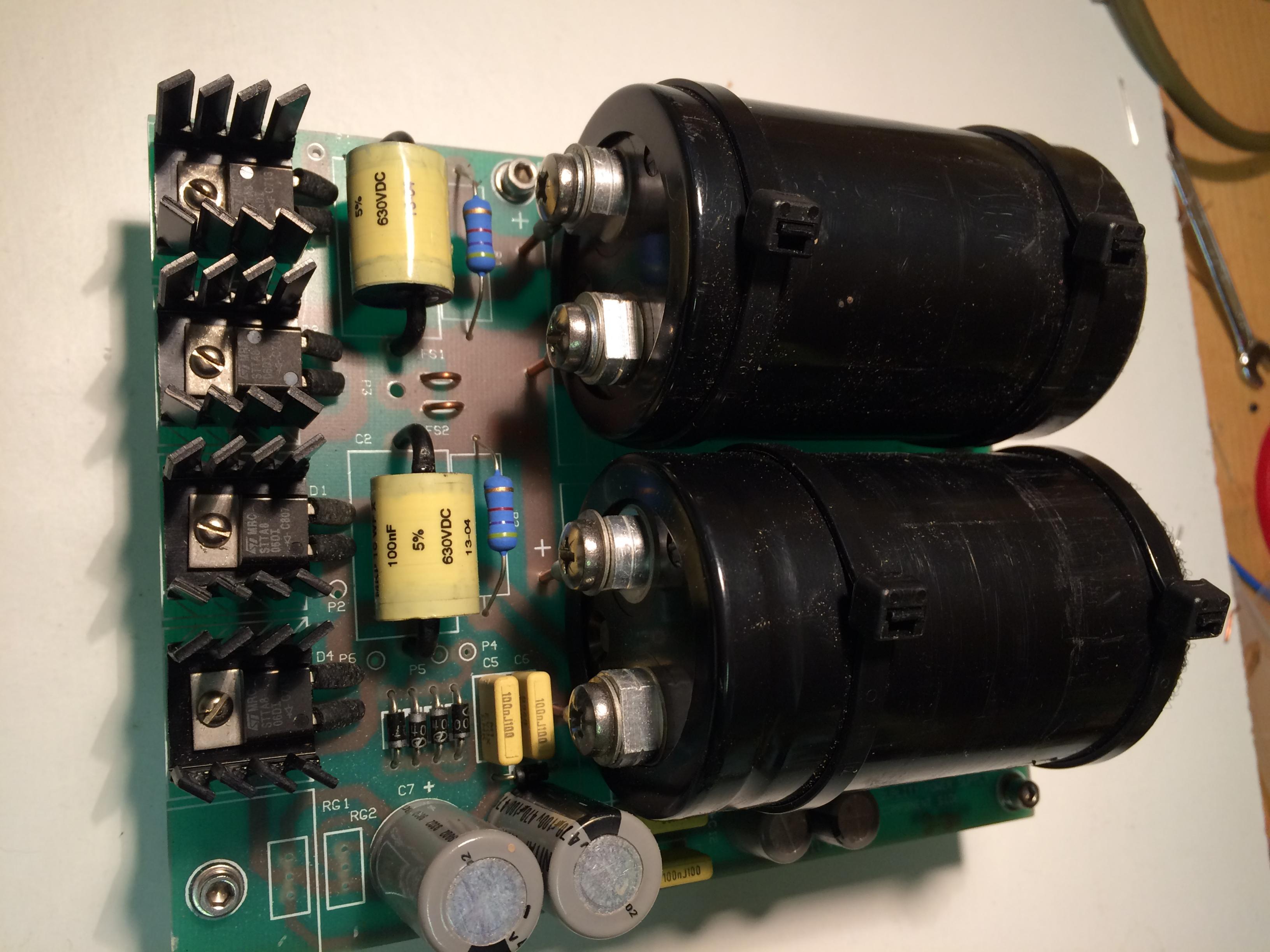

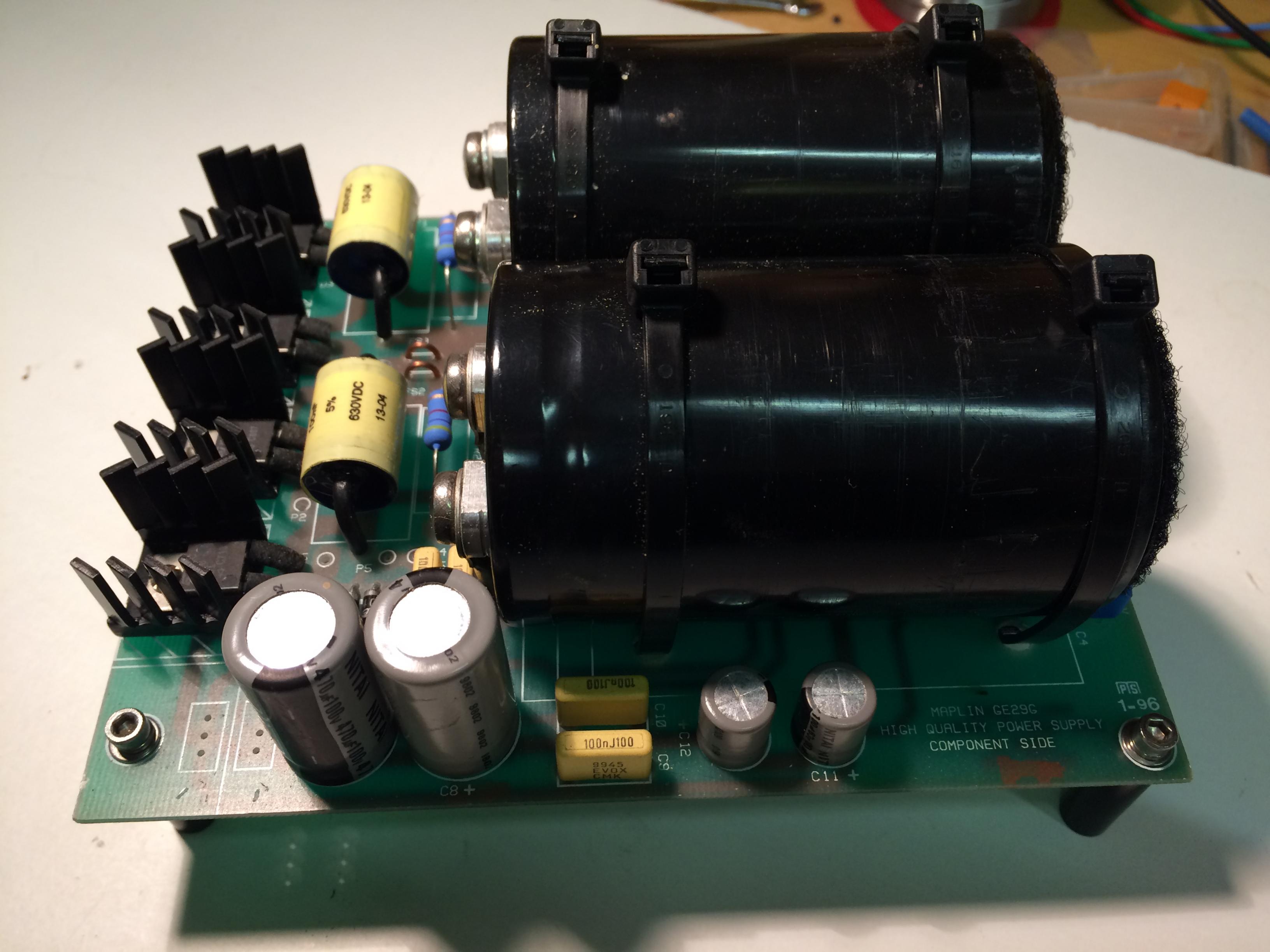

The power supply is mounted all on the same board with heavy duty spade connections and PCB tracks .. works well with no hum etc

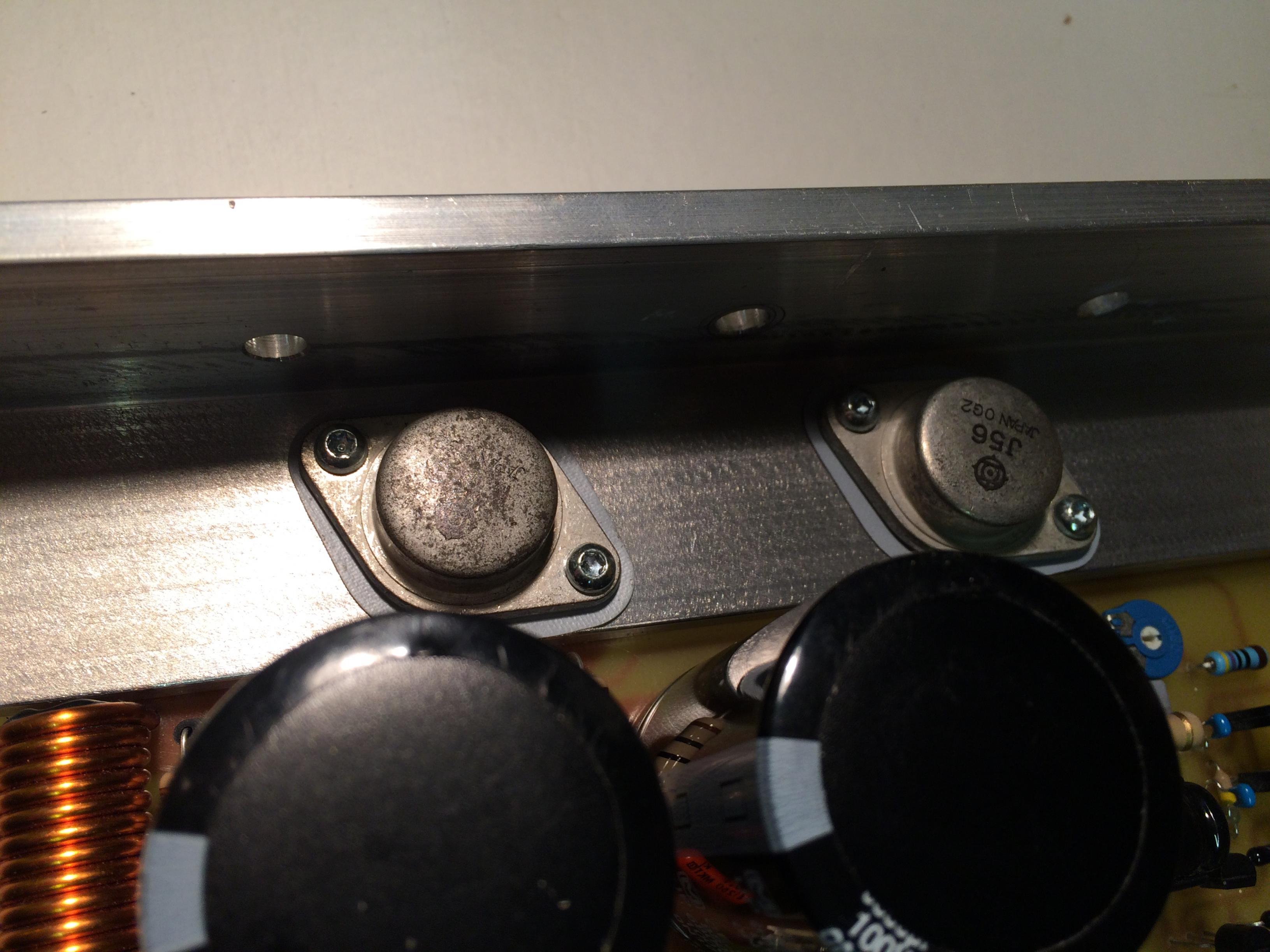

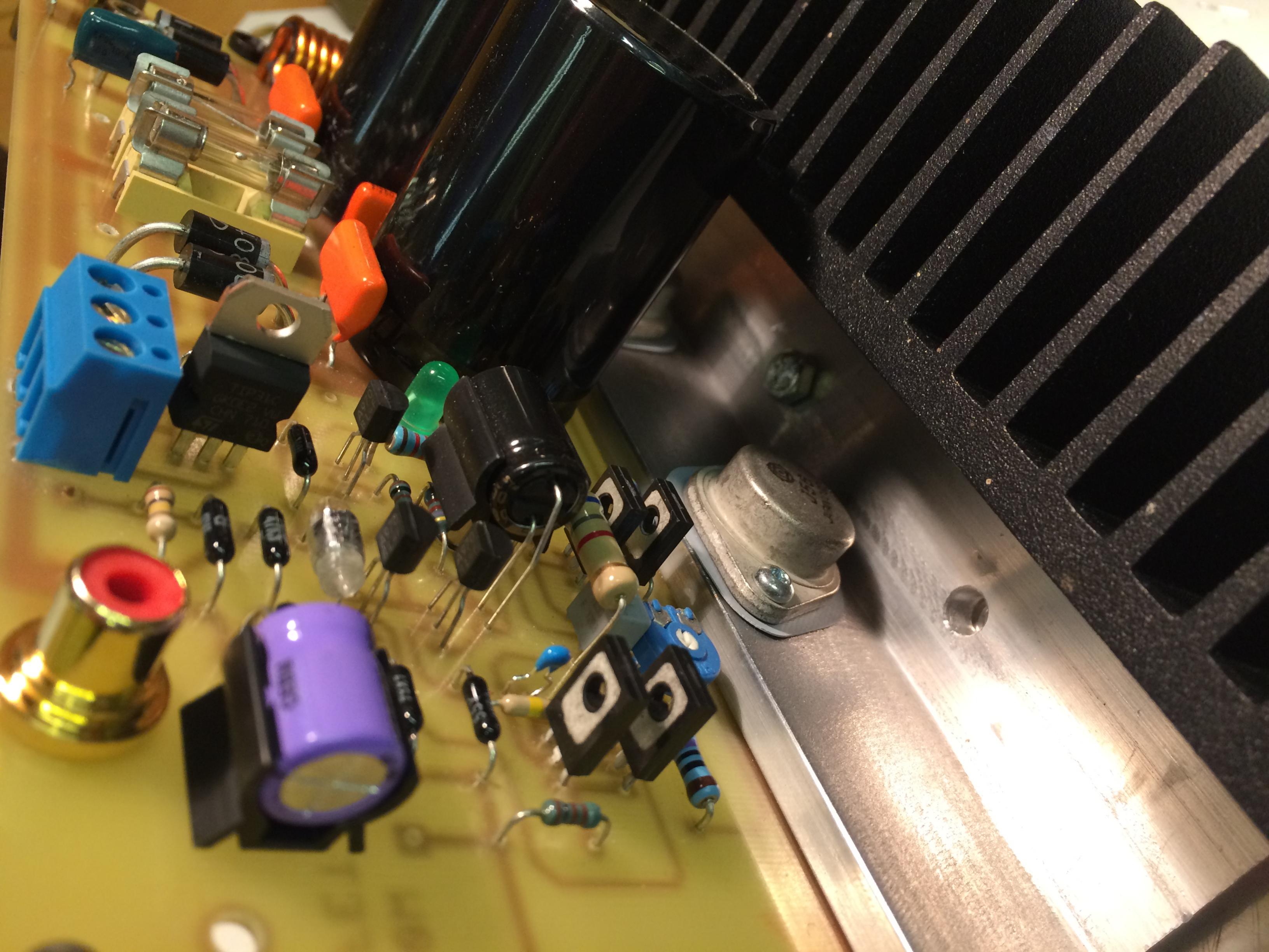

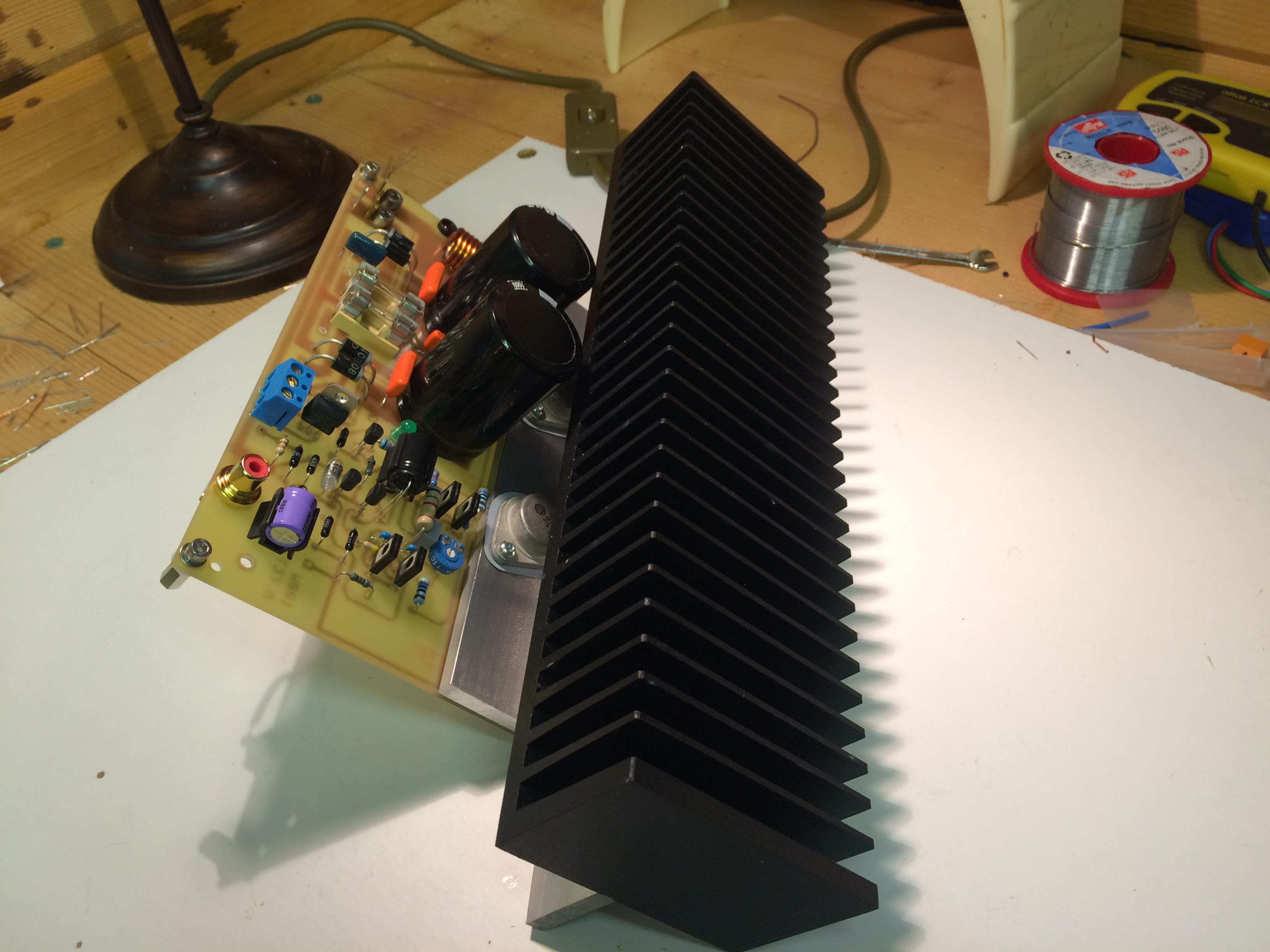

now with the heat sink mounted .. please note this has not been finally completed so the heat sink is just a trail fitment exercise .. but will most probably go with this set up

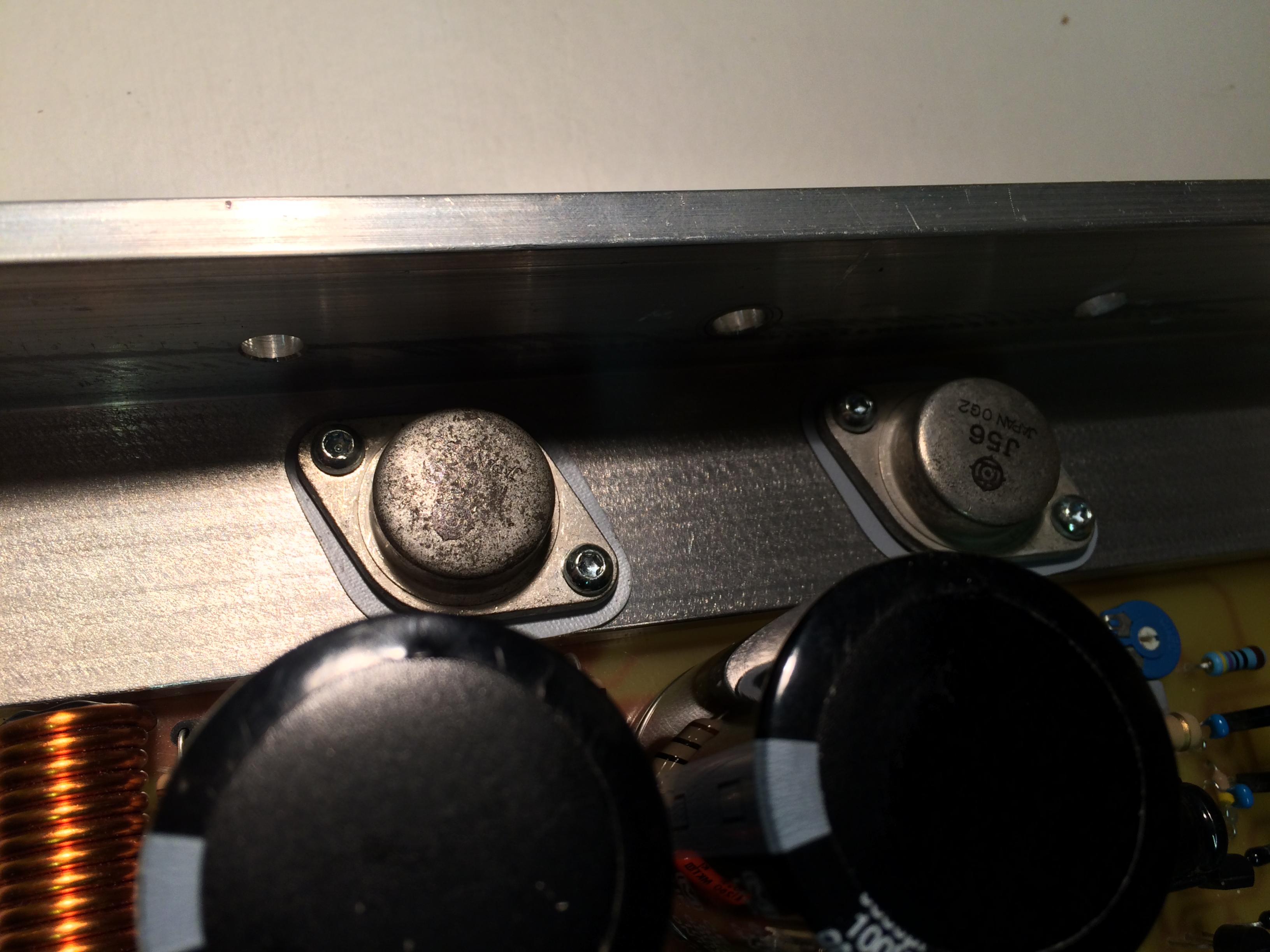

Nice, I attached a phono socket directly to the original amp boards, I don't know why it isn't done more often. Have you tried using Belleville washers for transistor mounting? Belleville washer - Wikipedia
well done .. never knew there was such a thing as a Belleville washer ? thanks for the head up

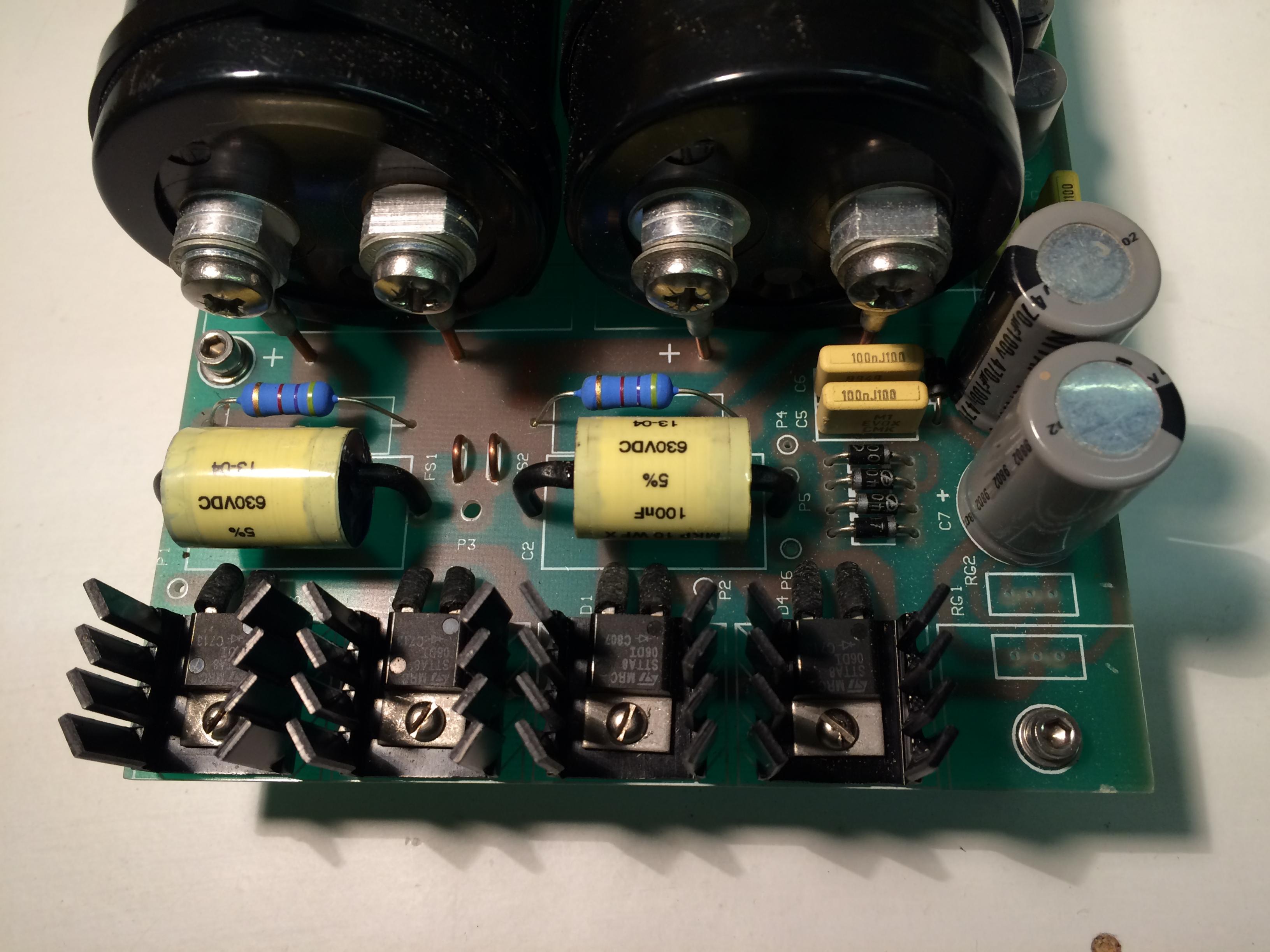

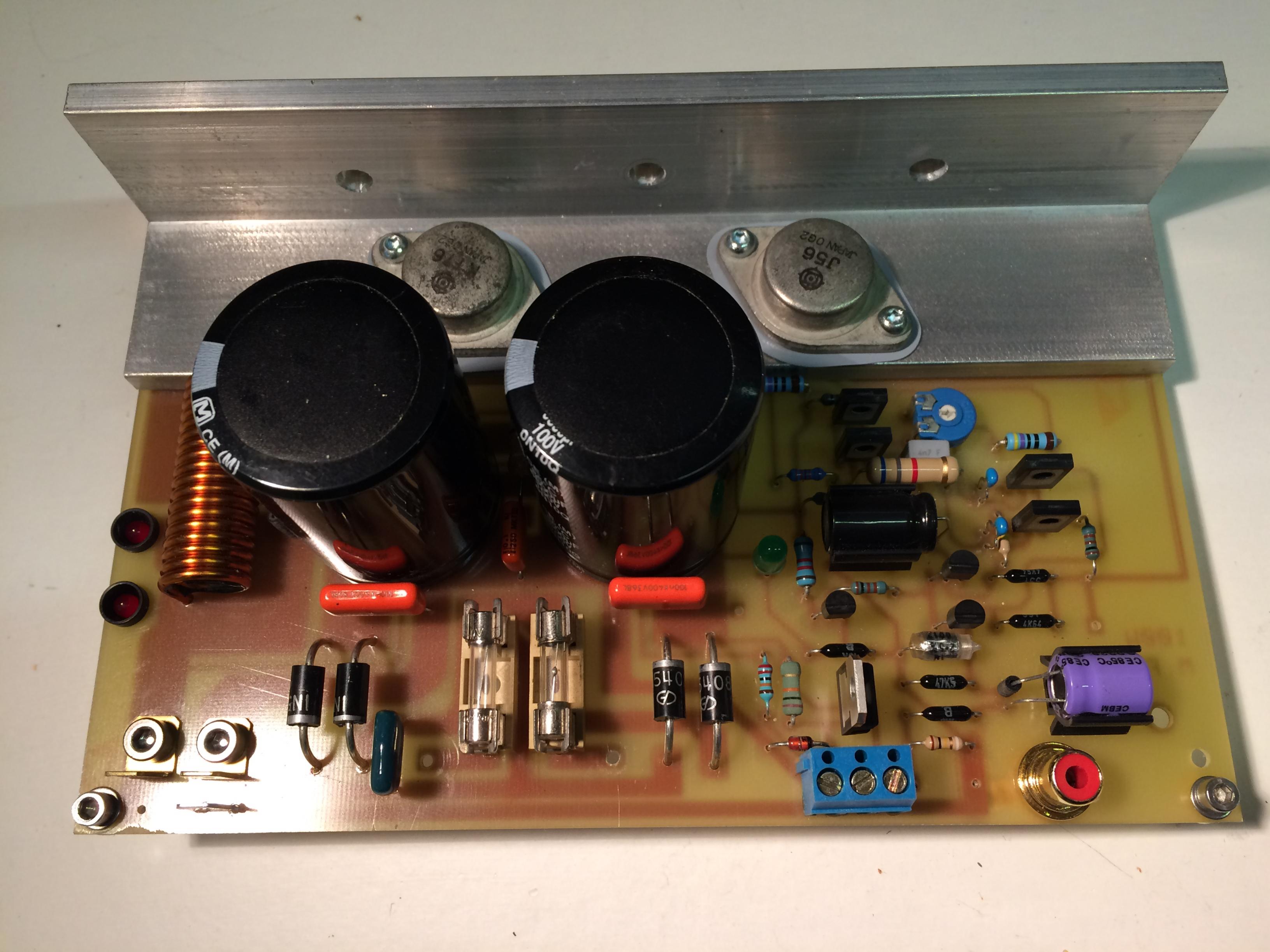

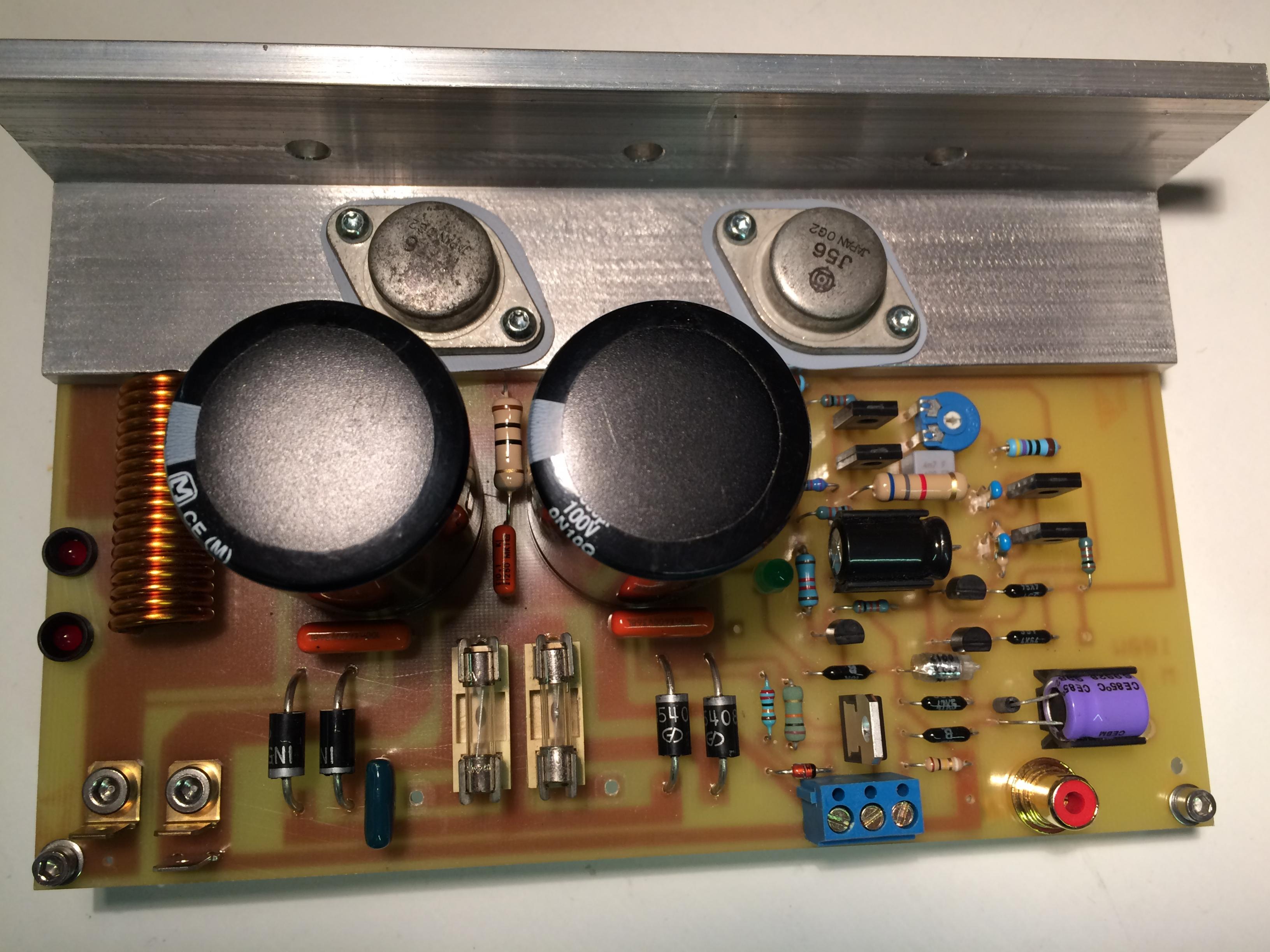

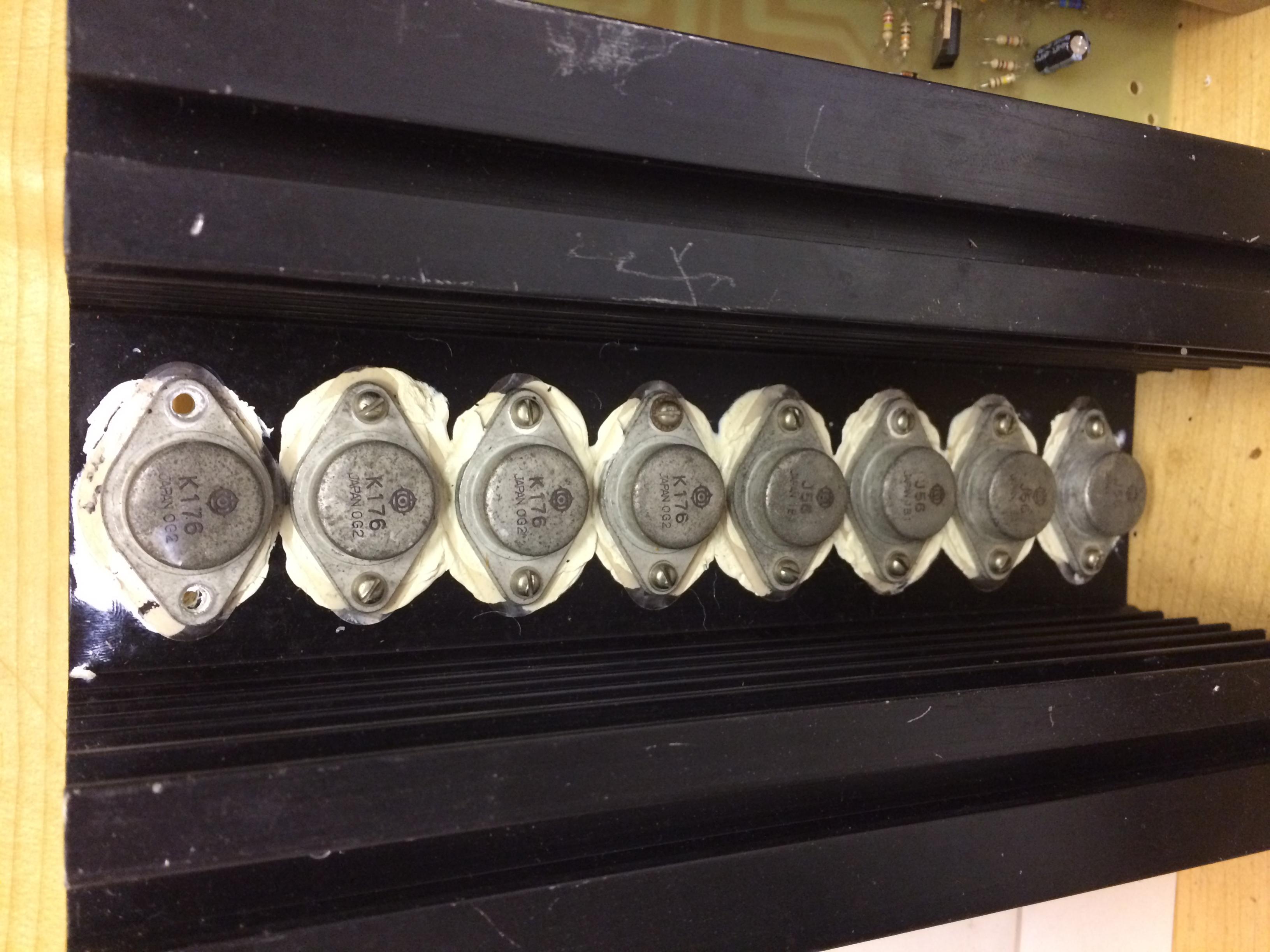

Hello .. have not been around for a while as have been very ill .. but on the road to recovery, any way while at home I got bored so decided to develop the gerber files for the maplin mosfet amplifier as really fond of the design and sound quality .. retro years etc in my youth
I imagine from the layout and heatsink sizes, that there was no pretence that this version would still deliver 100W reliably .This thread reminded me, I reworked the Maplin amp using a custom smaller PCB .....

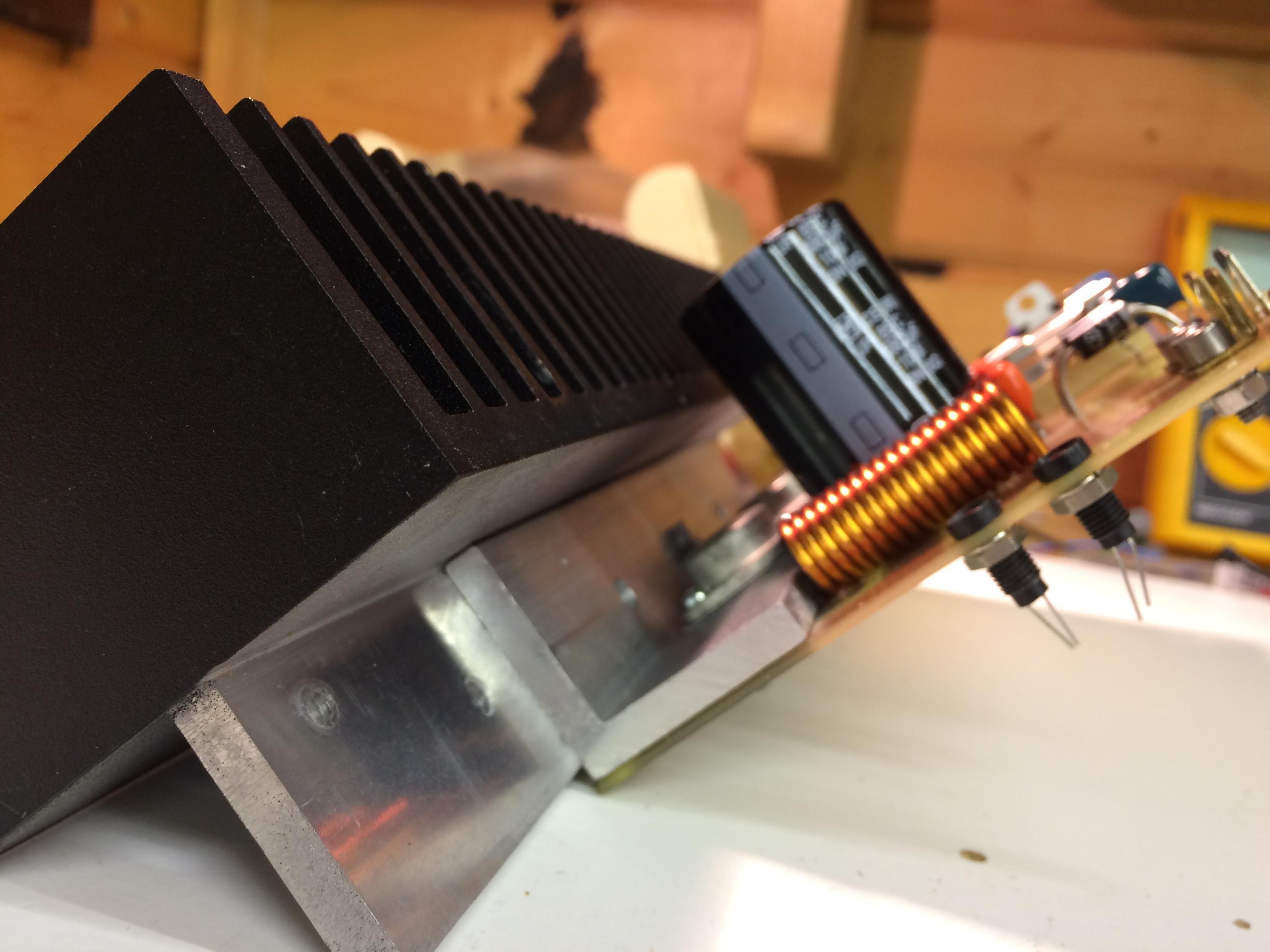

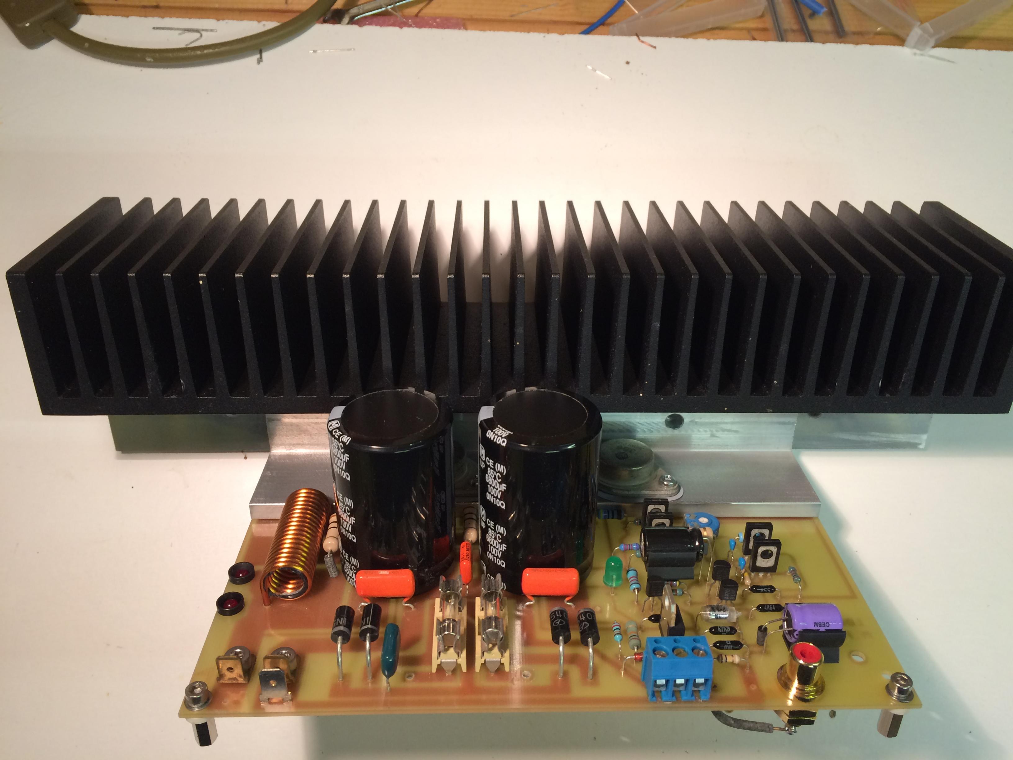

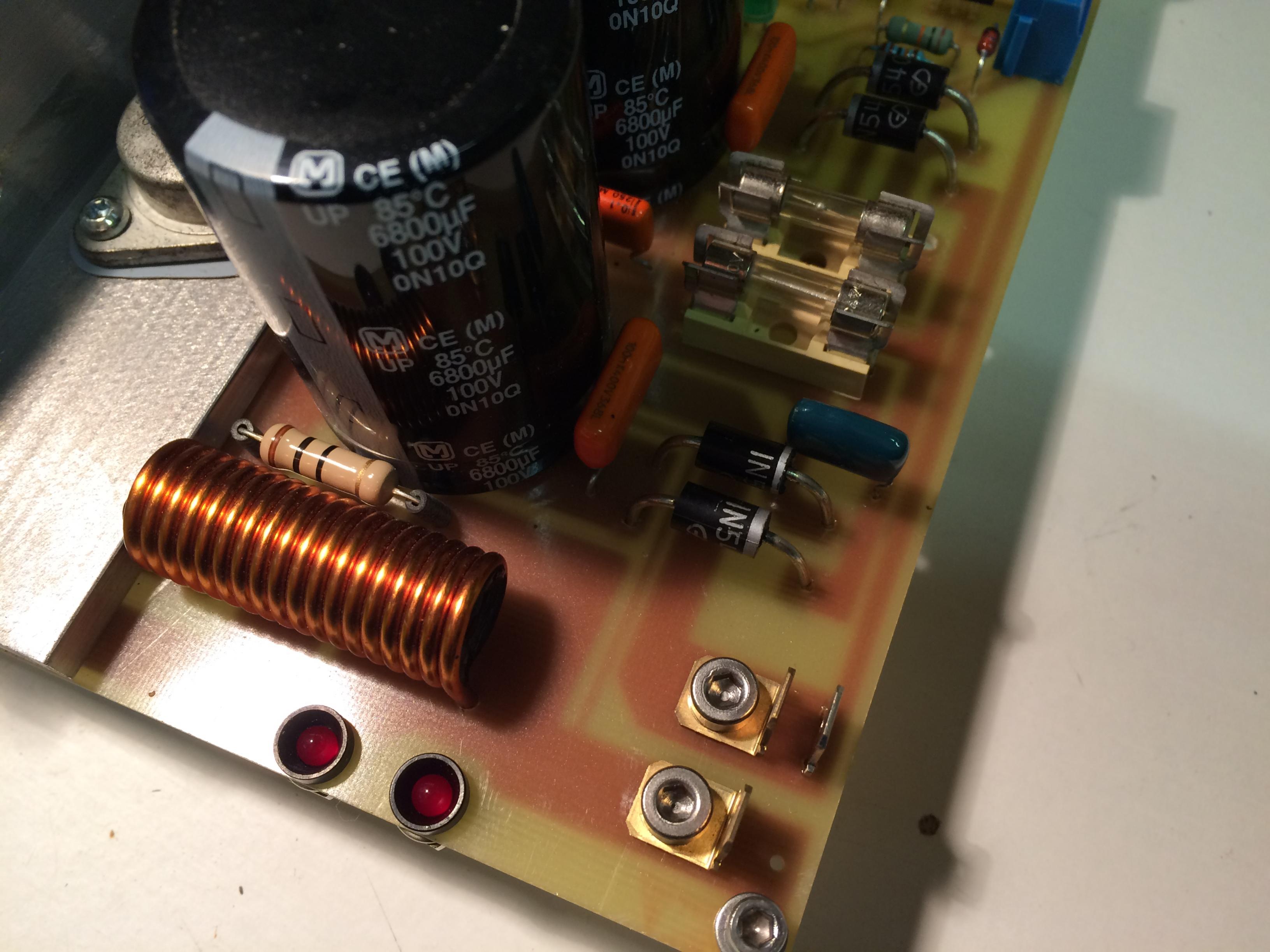

This thread reminded me, I reworked the Maplin amp using a custom smaller PCB - I had a stock of a few pairs of 2SK135/2SJ50's and the small signal transistors from way back to find a use:
The output inductor is under the board as are the gate protection diodes & zeners.
Hello Mark ... that is indeed small, did your newly designed PCB work all OK? just out of interest did you make any changes to the design and component values? or transistor types? just curious to know
Best regards
100W continuous, no I suspect not, but its adequate for normal use I think, I tend not to listen to pure sine waves at 100% level (dub reggae perhaps being an exception!). The boards were tested to 100W briefly to check stability, and are awaiting a nice case plus preamp.
