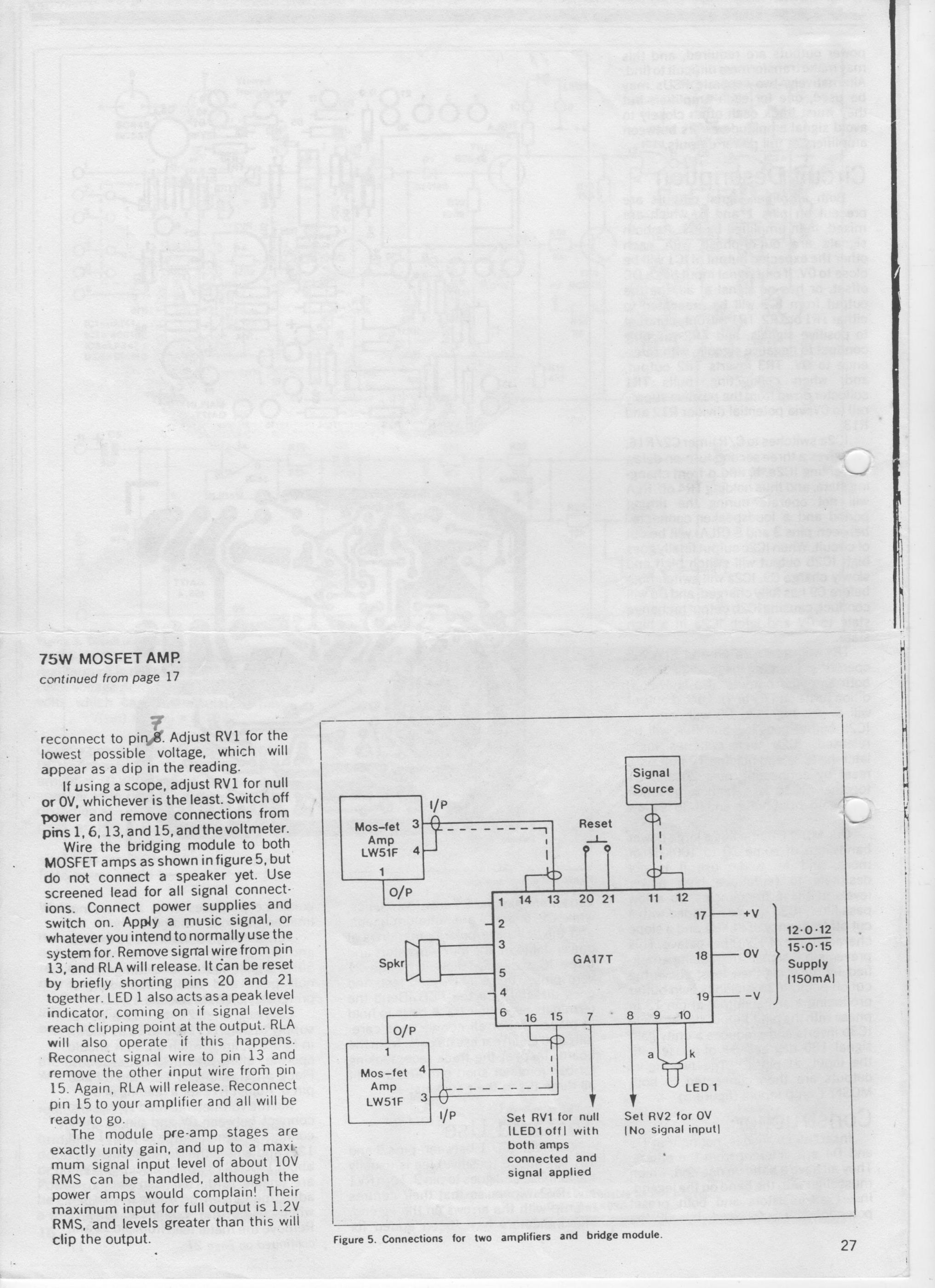

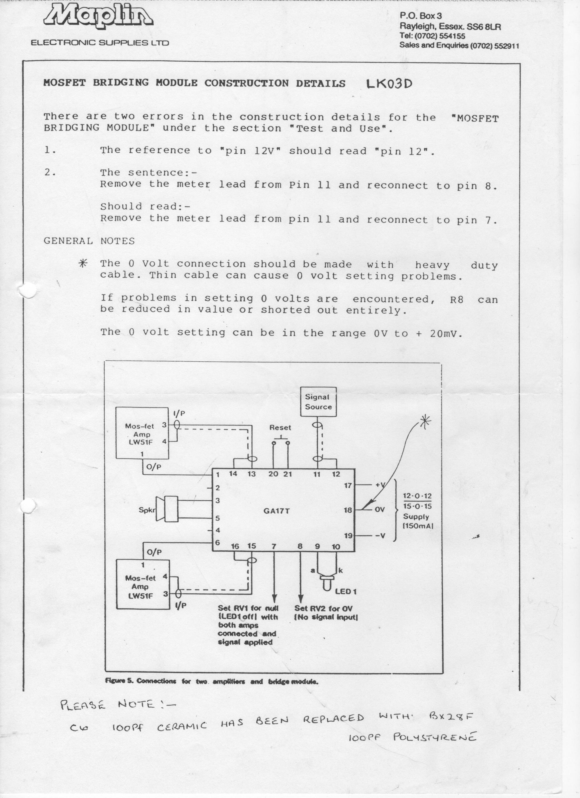

The bridging module is fine, the problem was that most people did not set up the module correctly in the 1st place .. I use a scope with mine and is all OK, plus there are other bridging modules that can be used these days

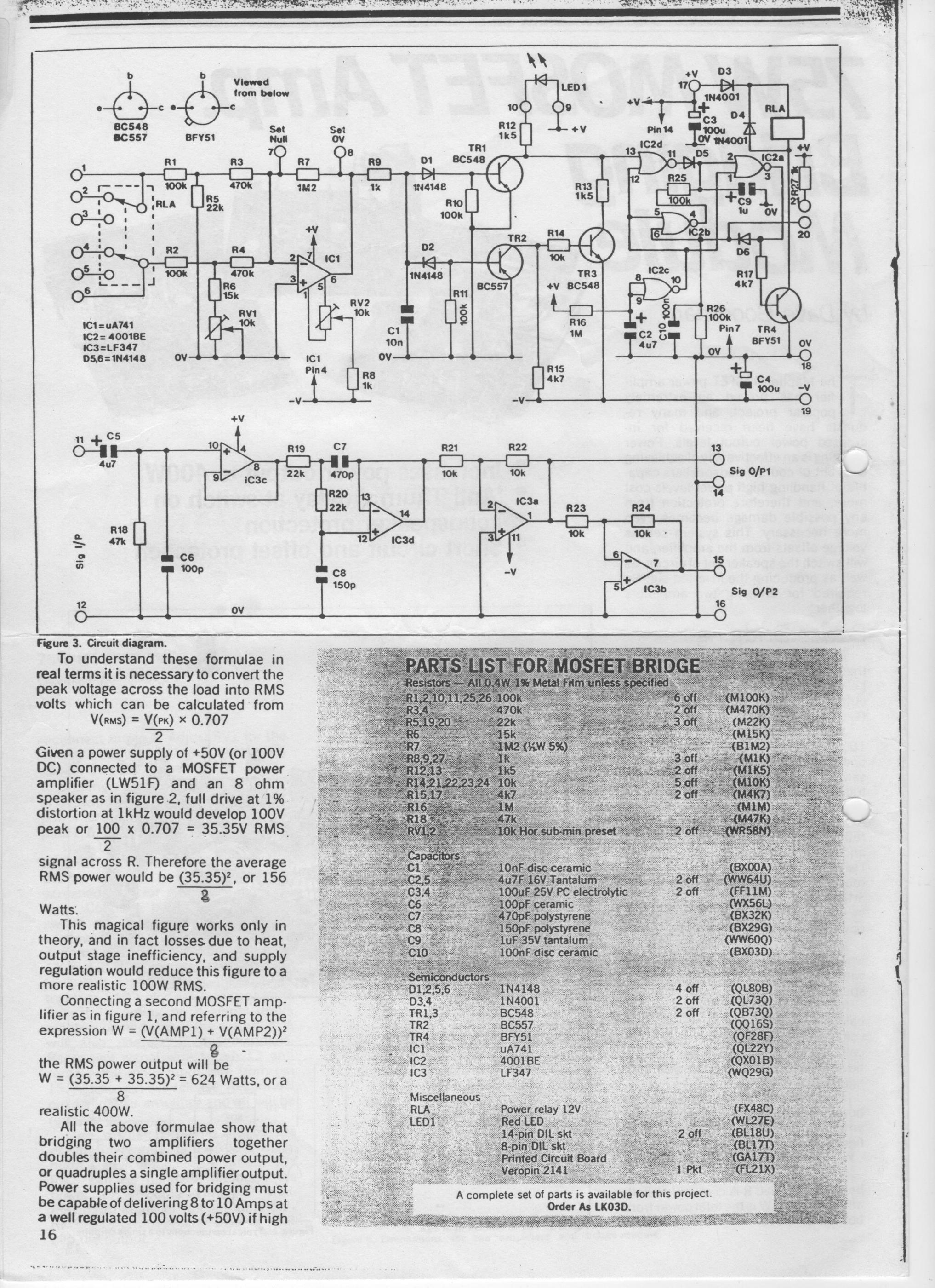

It is possible to bridge a pair of these amplifiers with a single resistor.
Link the output of the first amp to the base of TR2 on the second amplifier with a resistor equivalent to the upper arm of the feedback network (R7 -33k on the schematic) & ground the amp 2 input.🙂
IIRC the bridging module was fine in the fact that it provided the anti-phase signals to the amps for bridged operation but it was very prone to tripping the relay.

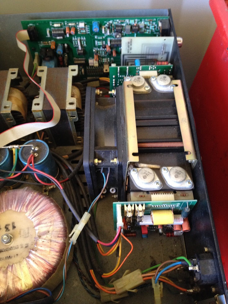

I have 2 amps with this configuration.
They are not identical to the Maplin module but very similar.
Kevin

The 400 watts is on a very good day without a long test into perhaps into 6R with rails at +/- 57 V rails.
300 W 8R is realistic. I have seem 28 Vrms at 8R if single amp. Double output devices in bridge might see 56 Vrms into 8 R. You might see 600watts 4 R if so. If you push for a long period clipping is seen and 21 V 6R is the single output possibility. As Andrew says a 75 W amp. Music being different the power figures are realistic. Hypex suggest 10 to 1 peaks to true RMS. Techno music 3 to 1. 6 to 1 a good figure.
