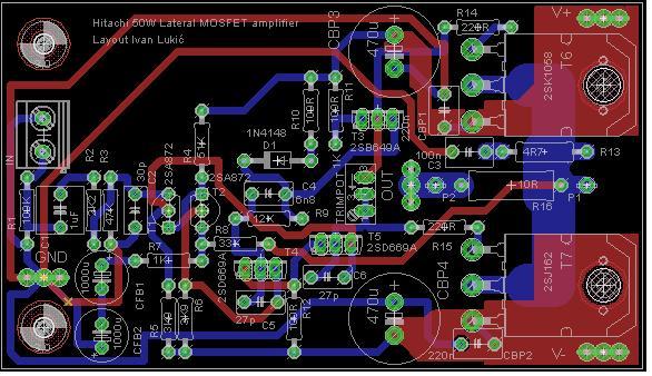

The added trim pot at the tail is handy for zeroing the output. Using mpsa92/ mpsa42 within vas stage I've not tried that yet as I use mje340 and mje350 here.
The trim pot probably isn't required and is just another thing to go wrong but I added it in case required. It can be linked out if you don't want it.
The mpsa42/92 are just high voltage general purpose transistors that I have lots of.
With the MJE340/350 you could drive multiple pairs of output transistors.

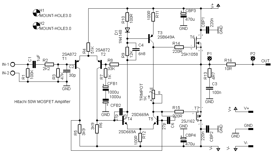

I designed double sided PCB for Hitachi app. note amp and added a few details from Maplin kit PCB, gate resistors and another 27pF cap. The PCB is star grounded and bypass caps are very close to output transistors which are TO3P packages so that the board can be piggy back mounted to the heatsink. Dimensions are 100 x 55 mm. P1 and P2 are solder pads for output coil. Feedback caps are two elcos connected in series to function as a bipolar cap.
But now I am curious to design another PCB version with ground plane on one or both sides. Any comments why that could be bad idea?

10 ohm resistor is in parallel with coil. Coil is reperesented in the sch and pcb as P1 and P2 solderpads. When the coil is soldered output will go through it, not through 10 ohm resistor that is in parallel with the coil. I did not find the coil footprint in the libraries so I used solderpads. Coil will be on the top of big 10 ohm resistor. It's only not represented on the sch and pcb.
Speaker return will go to the main star ground on the chassis or to the ground plane of the PSU pcb.
