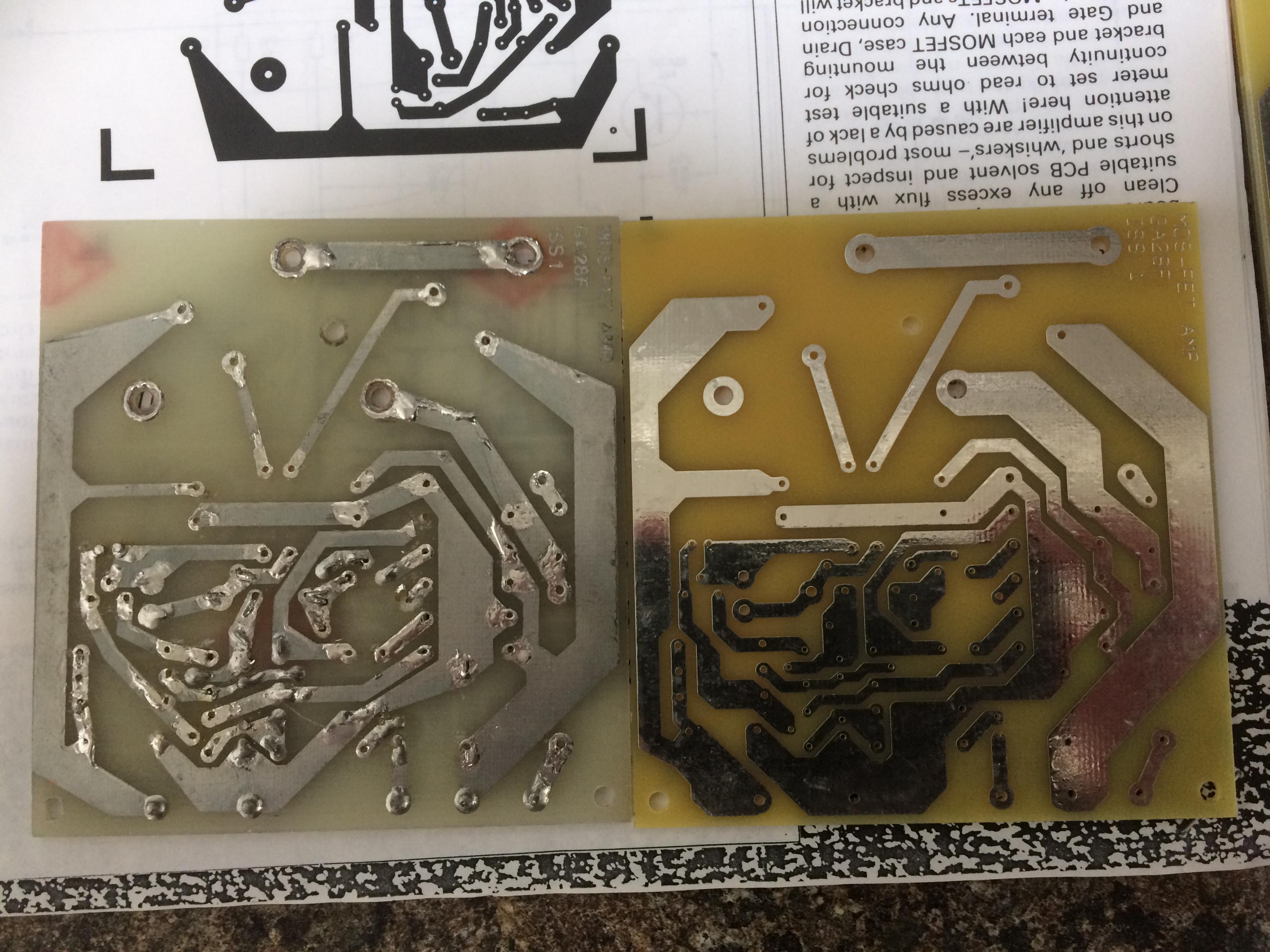

What a great layout and nice and clean .. very impressed
thanks for posting, assuming it still works all ok ?

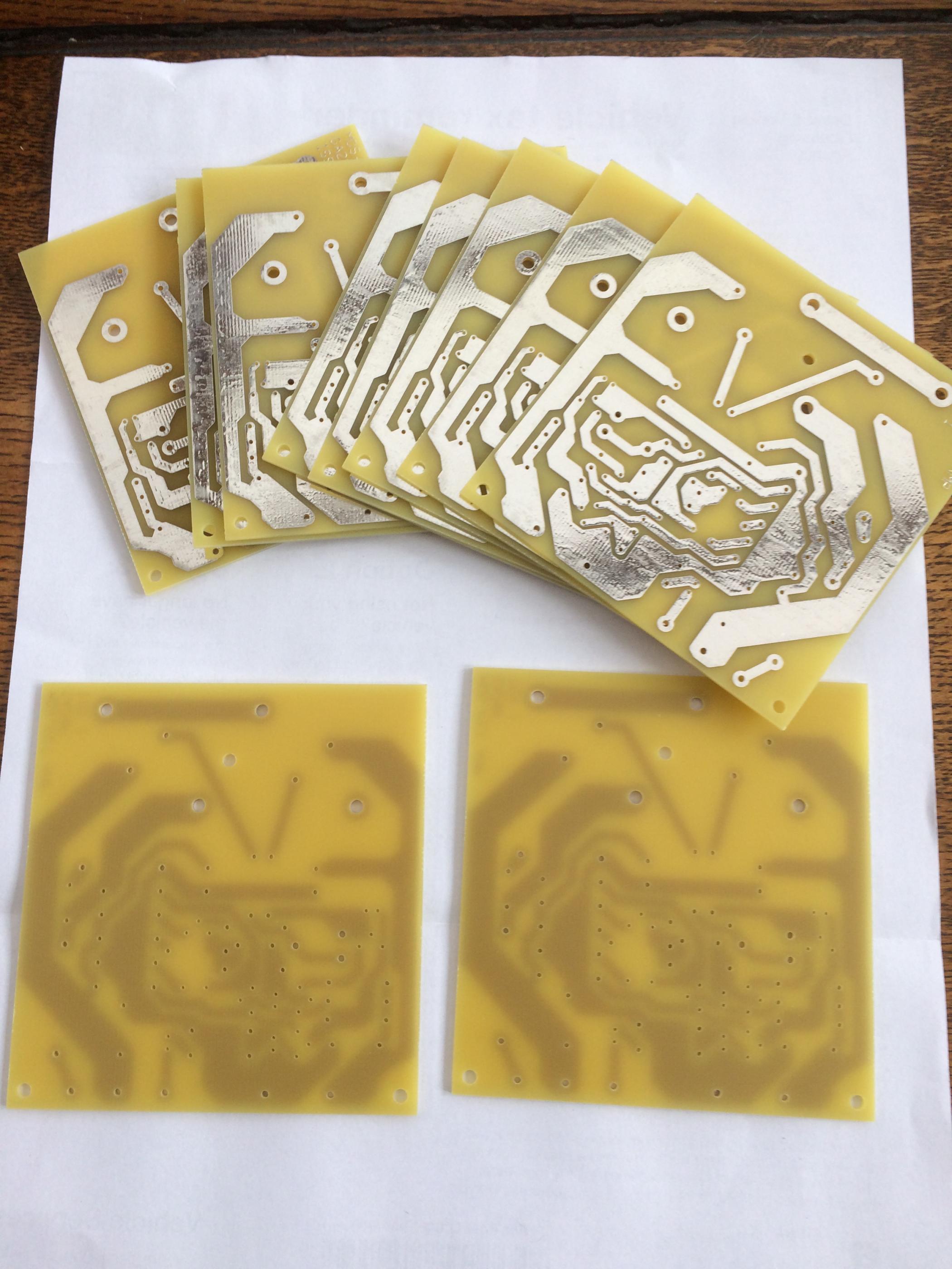

You could have got 10 pcb's from JLCPCB or PCBWAY for $5 + p+p.
They would have had solder resist and silk screen too.
Hello Nigel
To be honest not bothered about solder resist or silk screening .. plus I have my own PCB fabricator at min cost
but thanks for the heads up

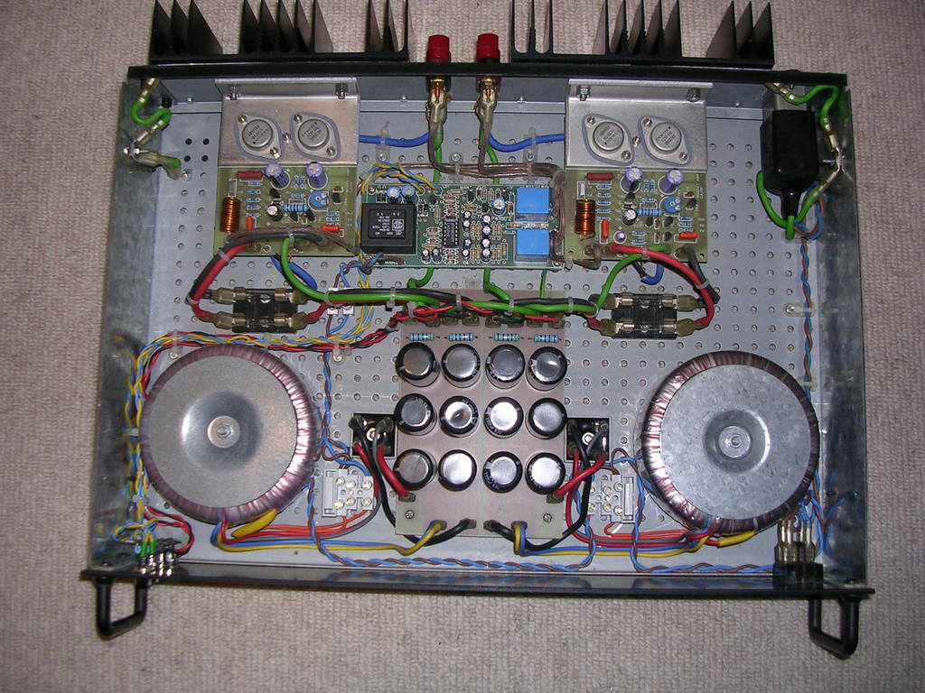

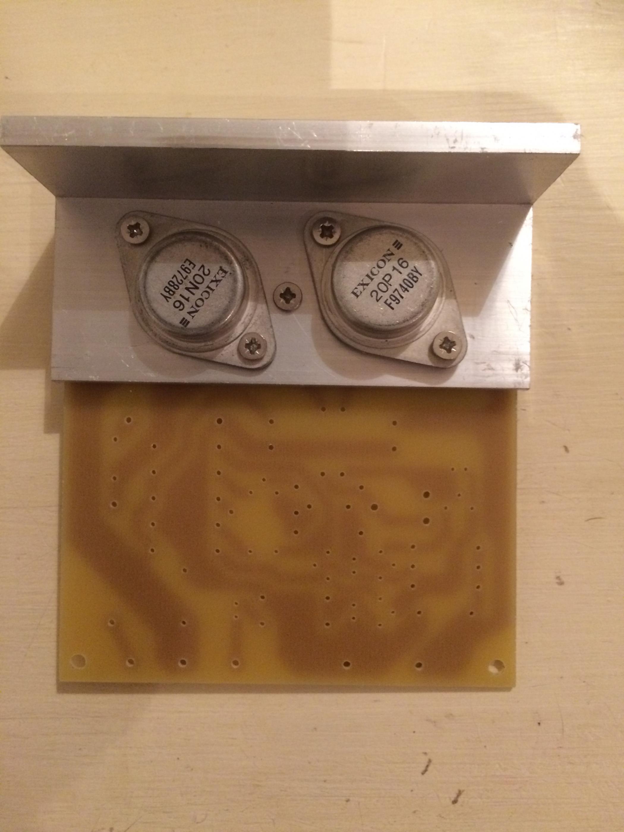

I did an update pcb to the Maplin mosfet amp a couple of years back.
I changed the transistors for easy to get modern types.
The original sometimes had problems with hum so I decoupled the front end.
I added CCS on front end and made current mirror two transistors instead of transistor and diode.
It sounded very good.
Here's mine. Must have made it getting on for 20 years ago.
I made my first Maplin mosfet amp in 1981.
It was built for a mobile disco but wasn't loud enough.
So I bought the Maplin disco amplifier which was 225WRMS into 4 ohms.
A couple of years back I spotted a Maplin mosfet kit on ebay which hadn't been built. So I bought it and built it up, worked great. I maybe should have kept it unbuilt for the rarity ?
Fired up my amp pictured in post #101 and it still works fine. I think I still have a few unbuilt kits in the depths of my workshop, maybe I'll make them up. It never fails to surprise me that such a simple circuit gives such good performance with pretty low distortion.

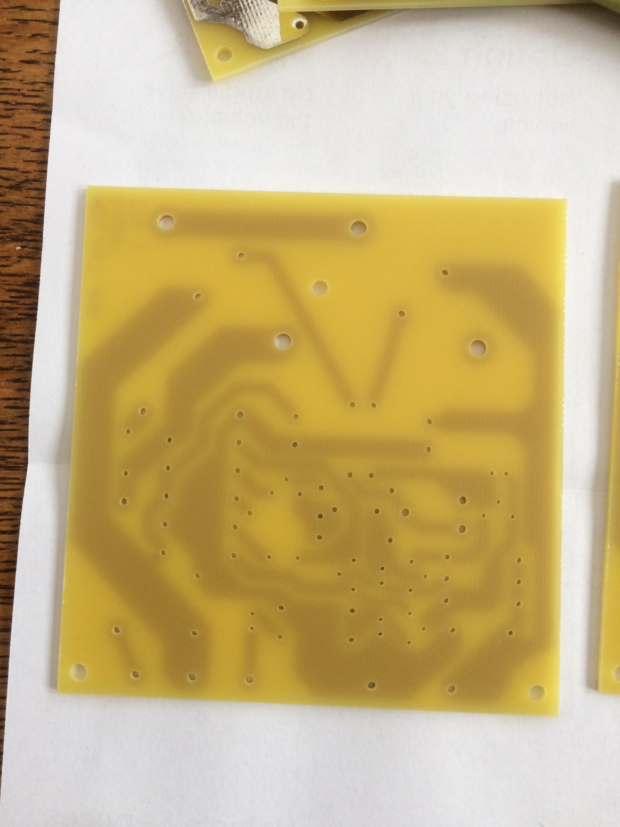

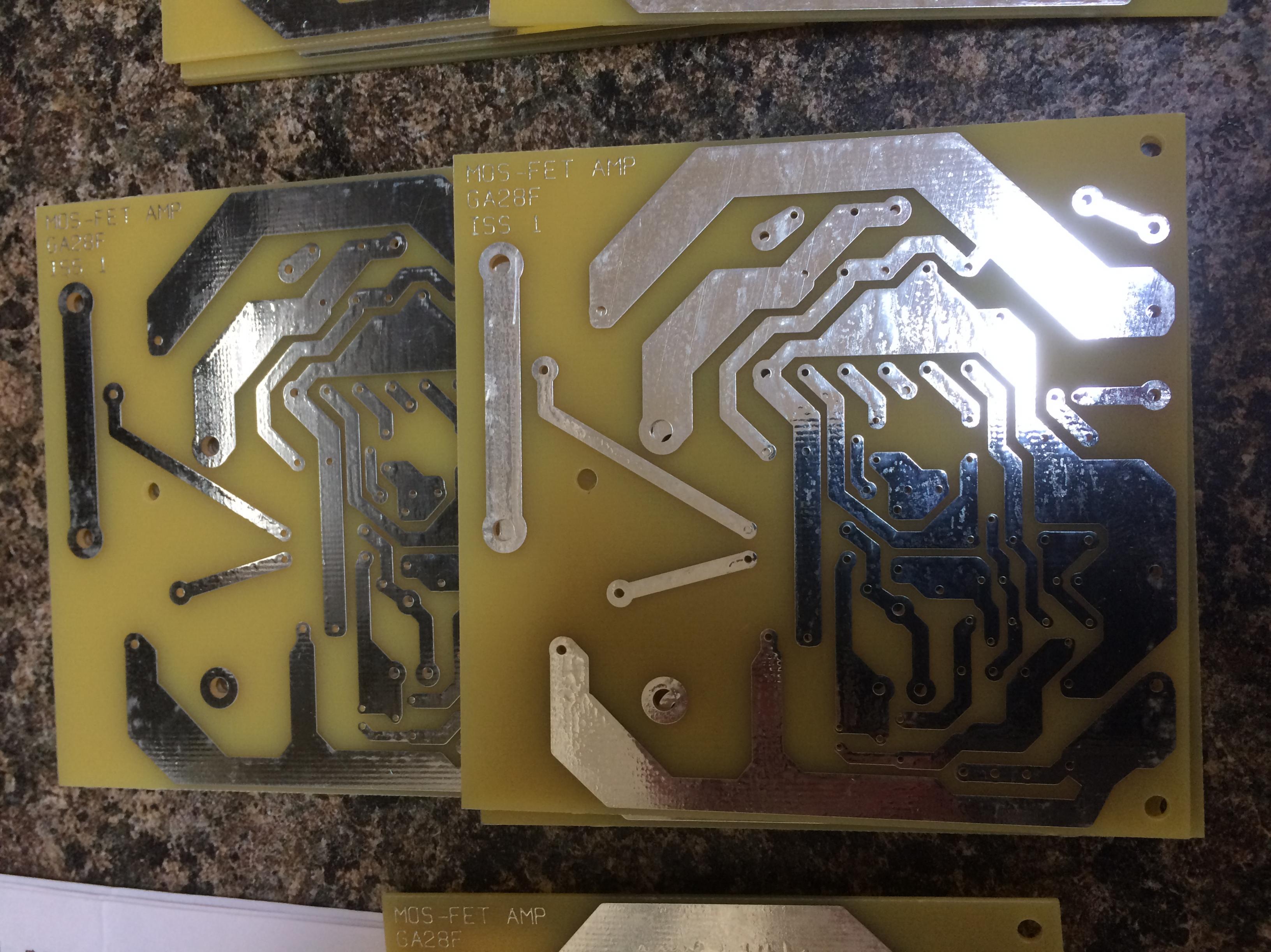

Also do I keep tinned the tracks or keep bare copper .. just wondered forum members thoughts
as bare copper you could use any solder that you are happy with ?

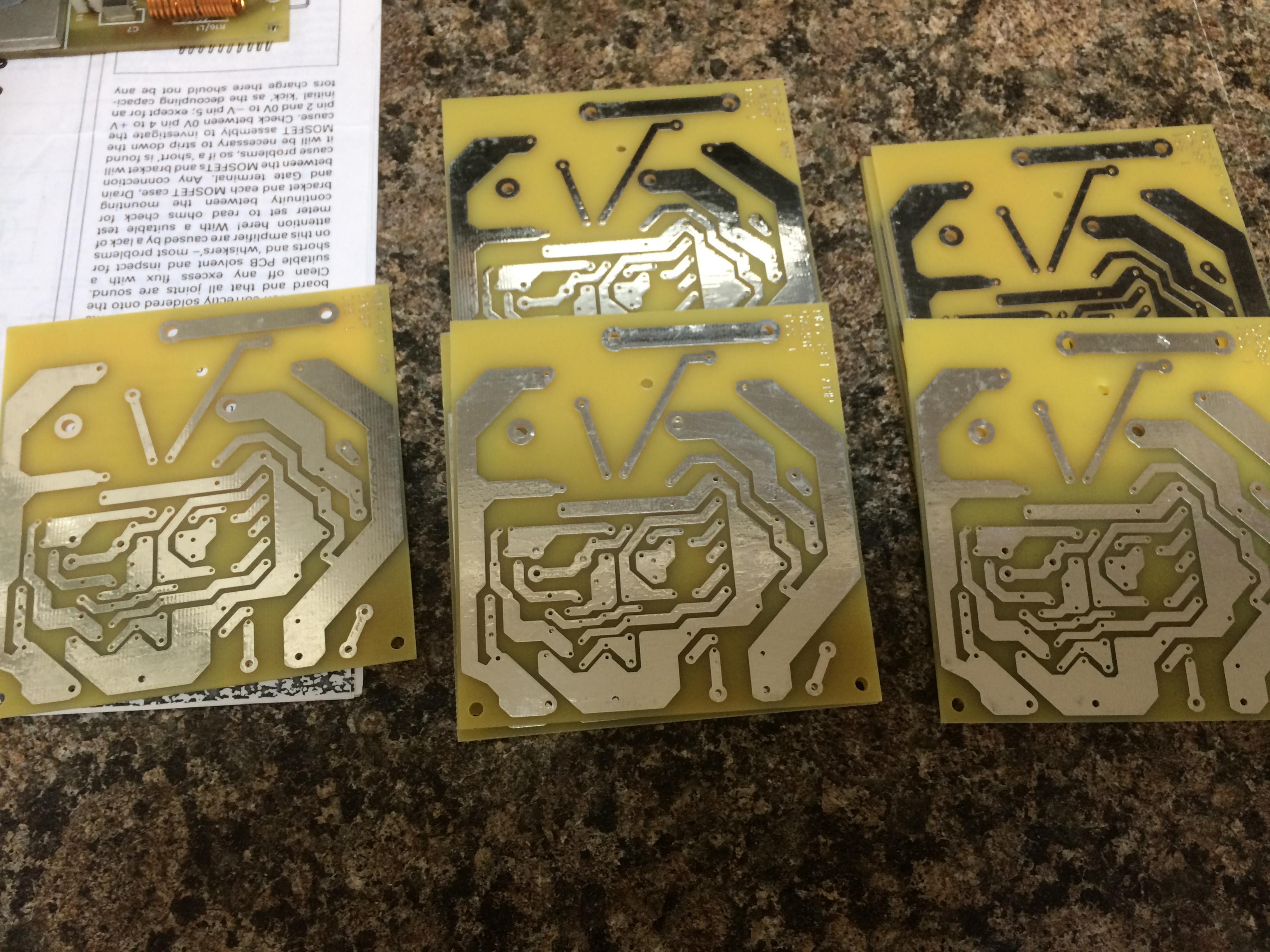

Nigel .. do you still sell the PCB's ?😕
Copper shows up fingerprints after a few months, tinned doesn't. Soldermask will also prevent these cosmetic issues and help protect from oxidation over the years. Commercial PCBs are always tinned/wave soldered or gold-plated in my experience, and only the cheapest avoid soldermask.Also do I keep tinned the tracks or keep bare copper .. just wondered forum members thoughts
best regards
With very fine tin layer the tracks change from silver coloured to brick-red over the years as the tin atoms diffuse into the copper track. Hot dipped tin (or wave-soldered) will stay silver (well, greyish)
I just made 10, sold 9 on and kept one for myself.
HASL is common now (hot air solder levelling.)
