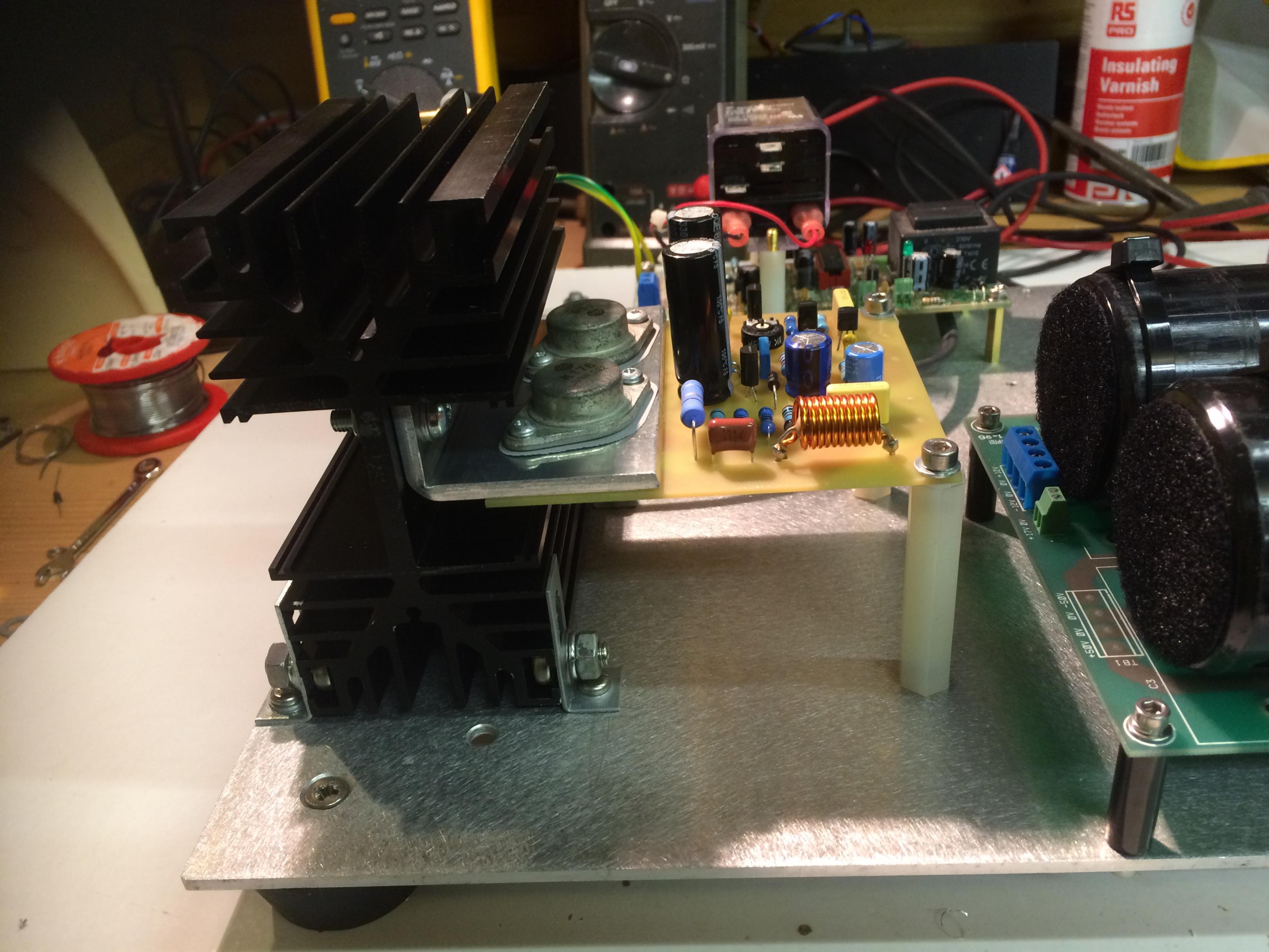

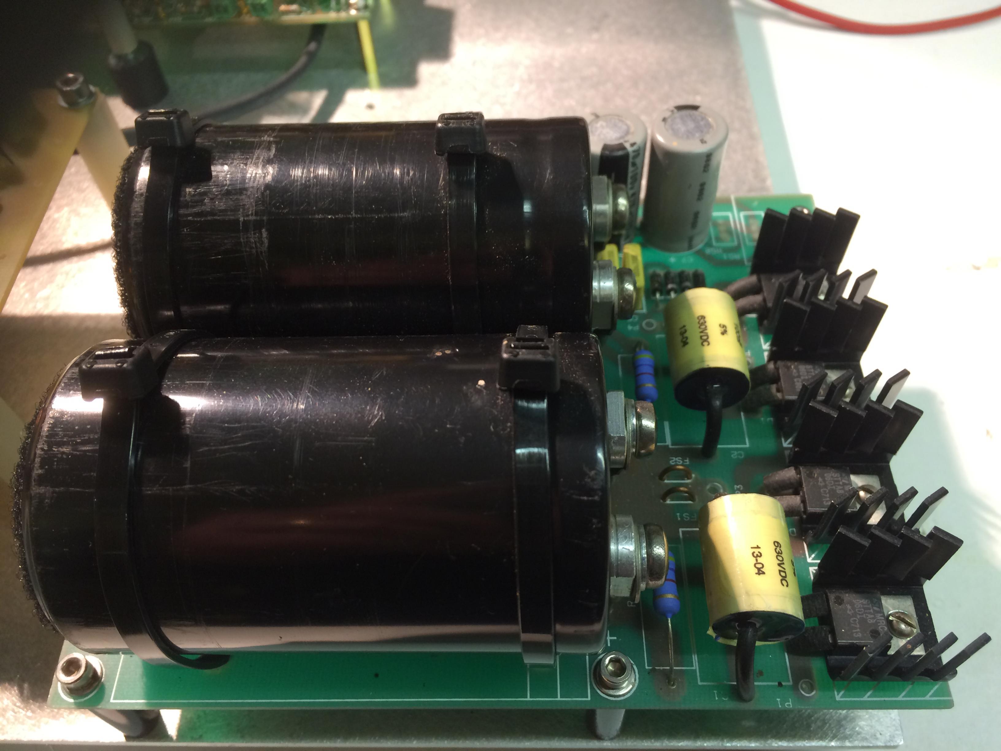

Hello happy forum members ... I have a soft spot for this amp as this is how I started out in electronics going to my local Maplin store . then made this lovely mosfet amp and nearly shook my parents house to bits, just love the 80's when I started making these amps

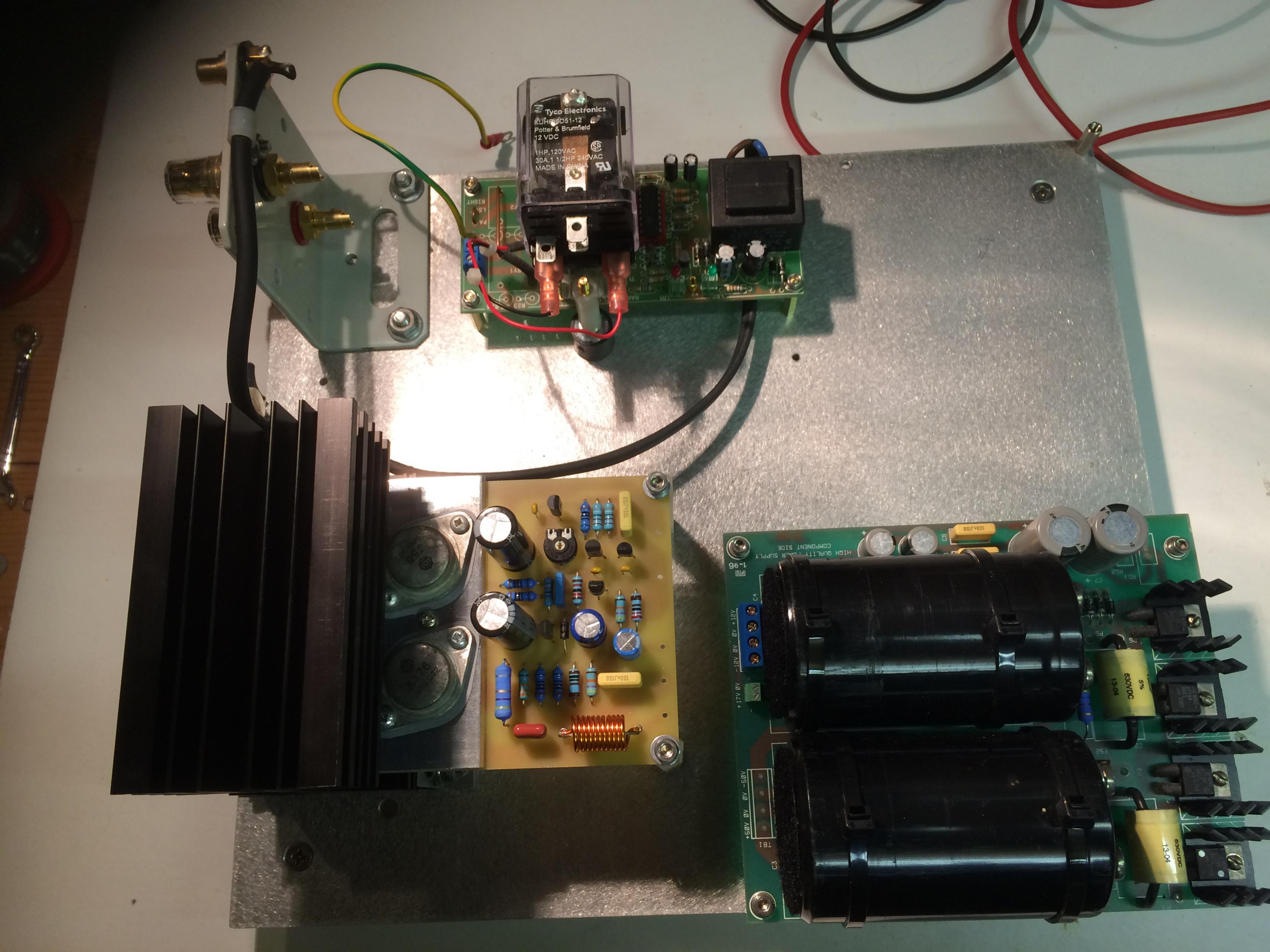

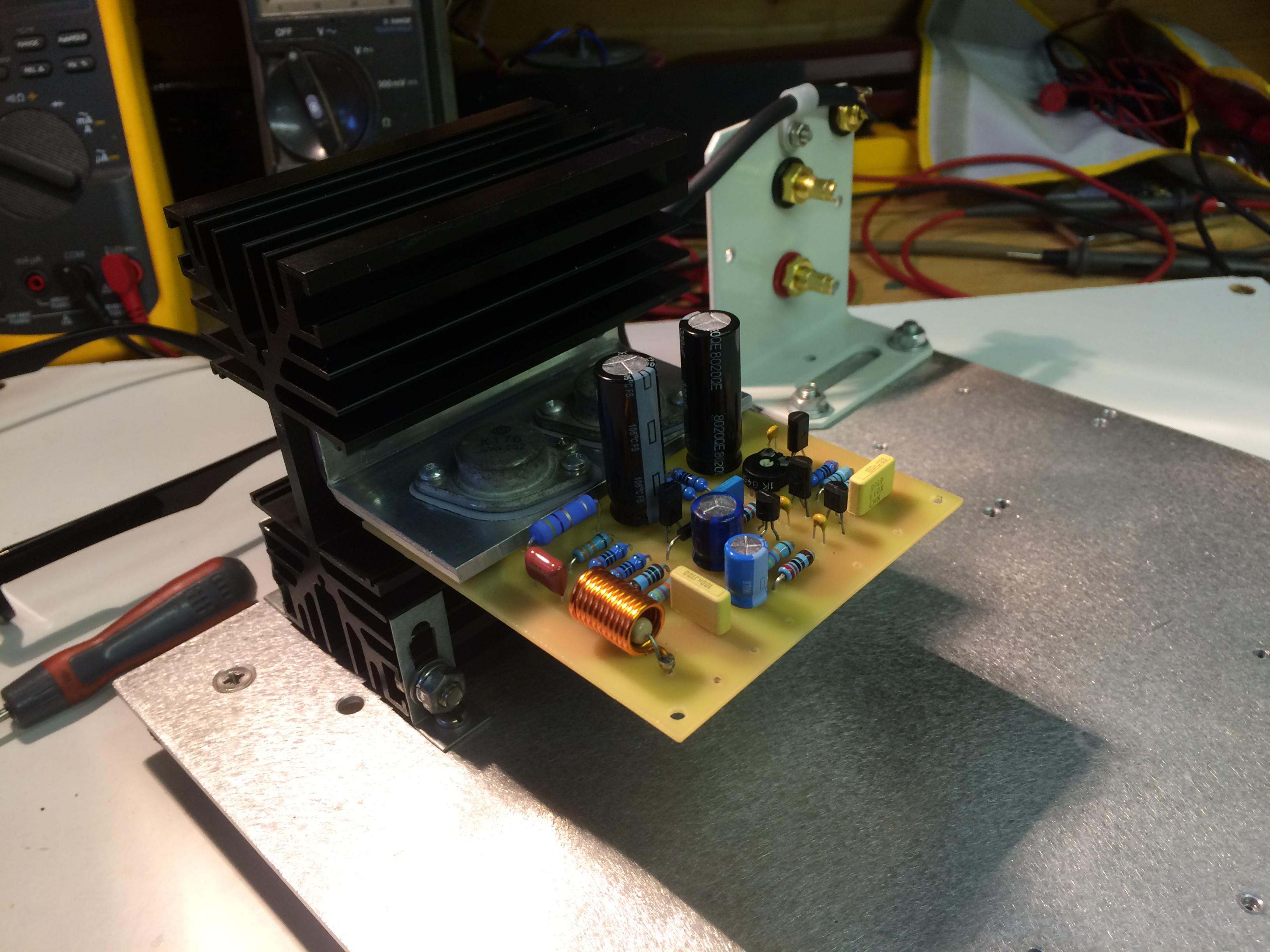

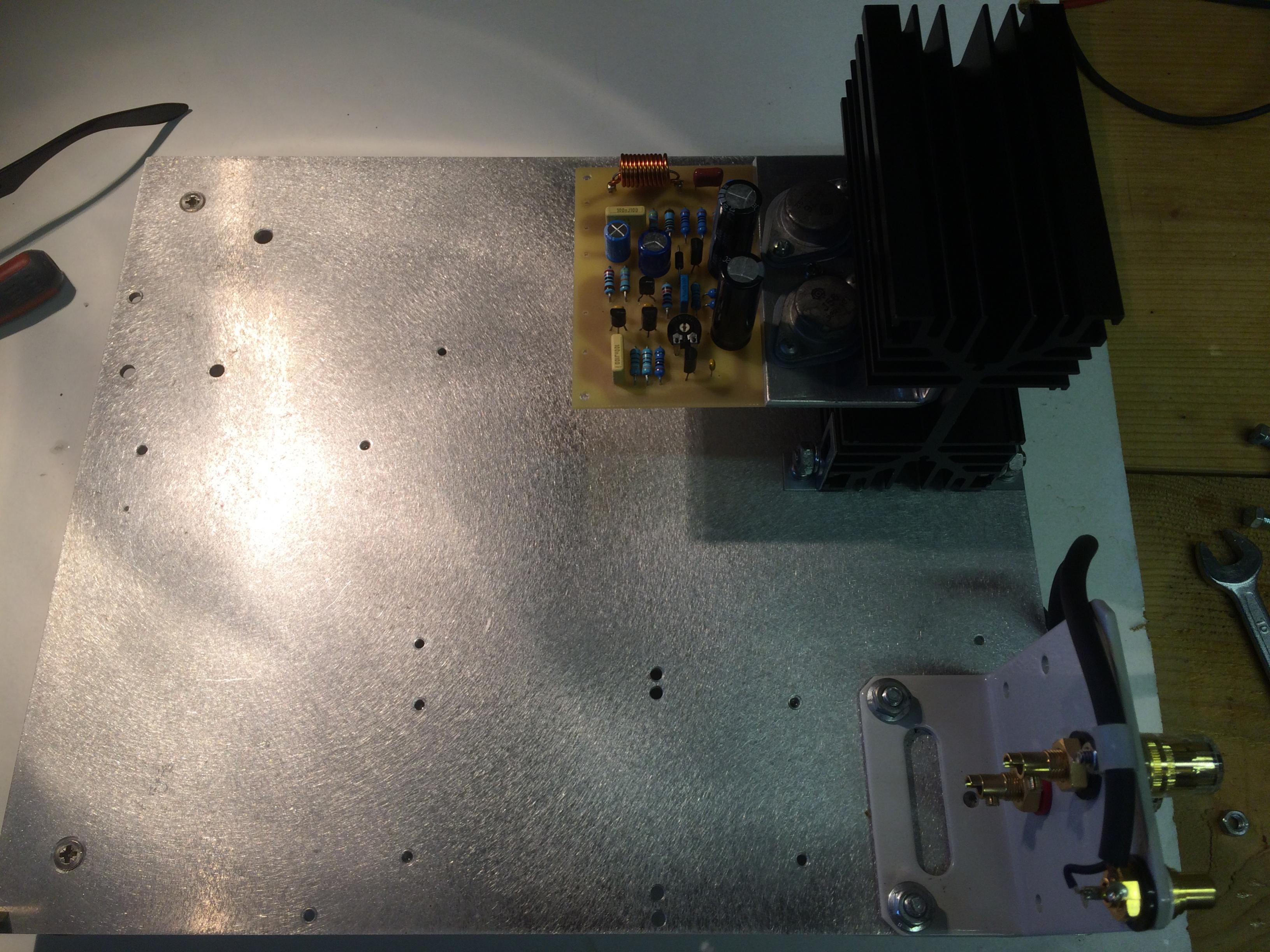

so now that I have my new PCB have decided to make a test bench to make sure all is ok with the amp before I commit to a pair of expensive cases etc

Hello Nigel ... happy days indeed 🙂

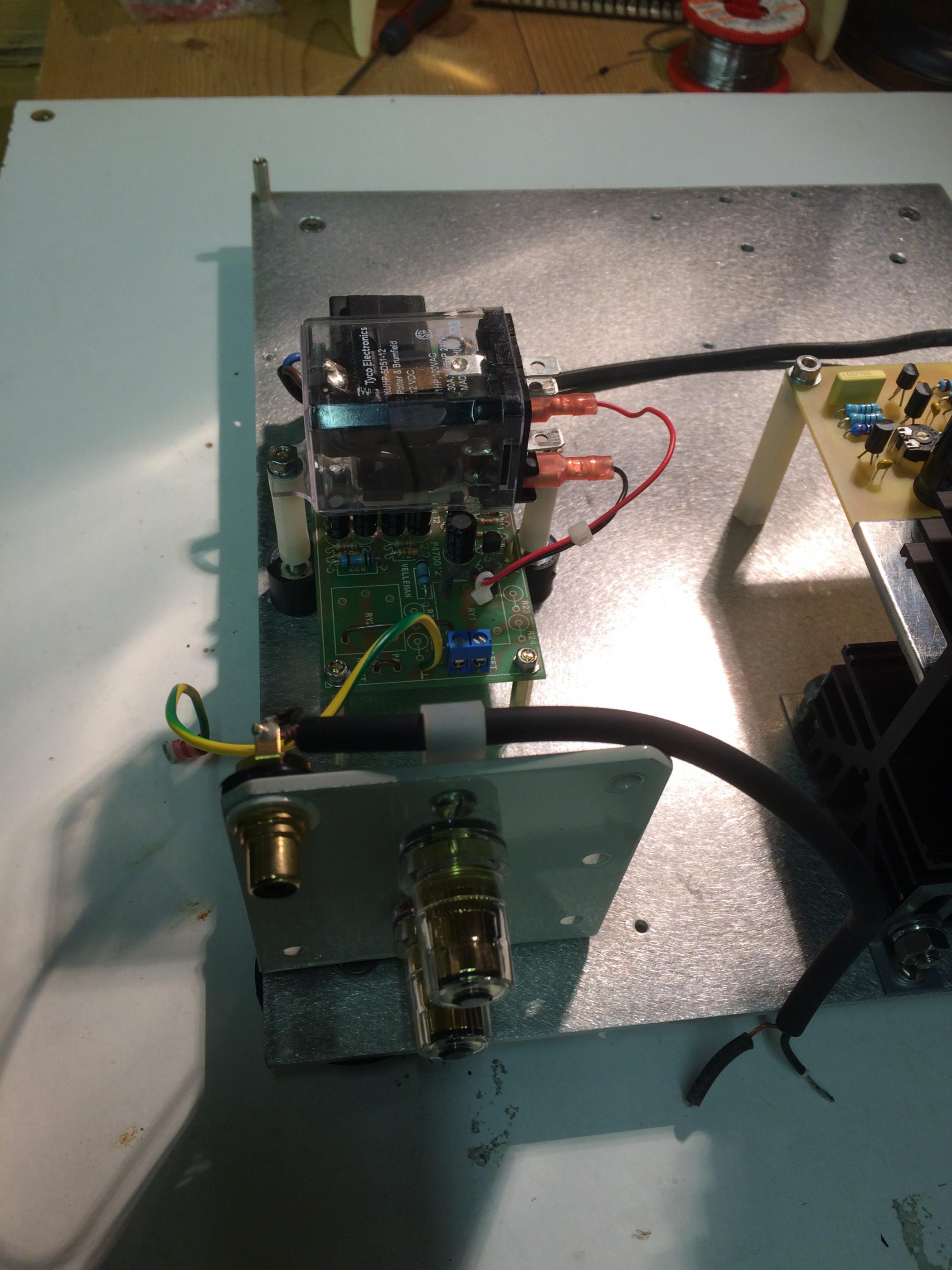

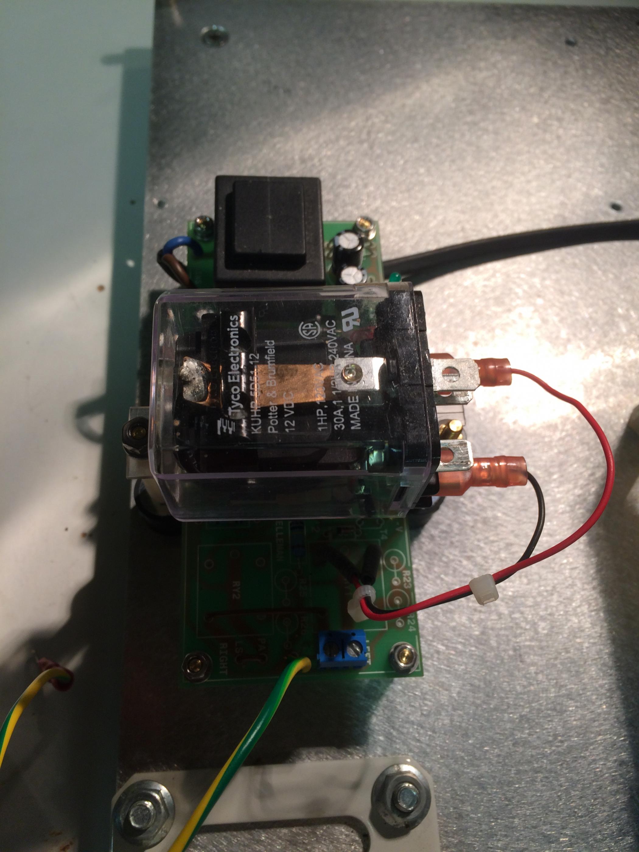

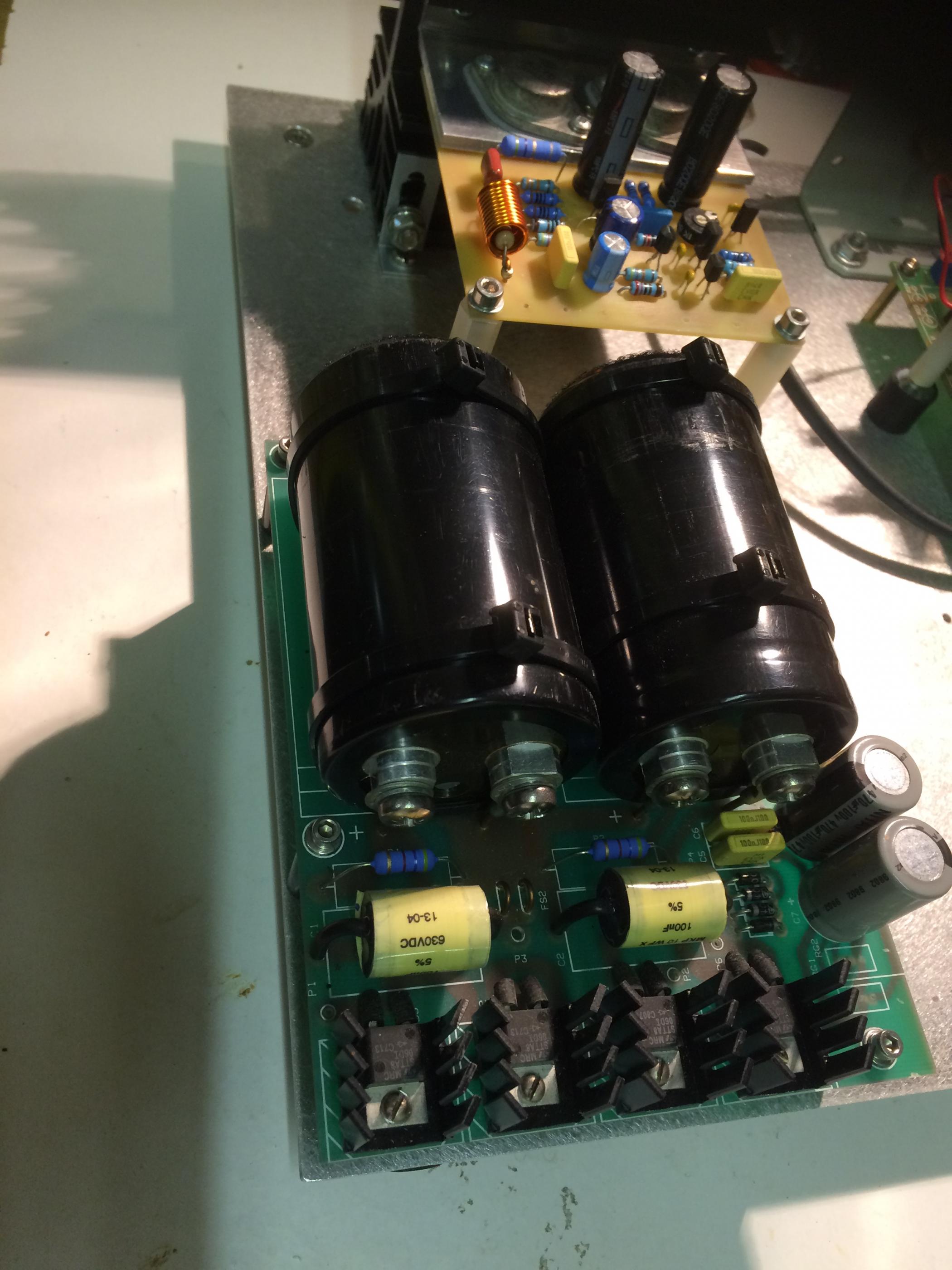

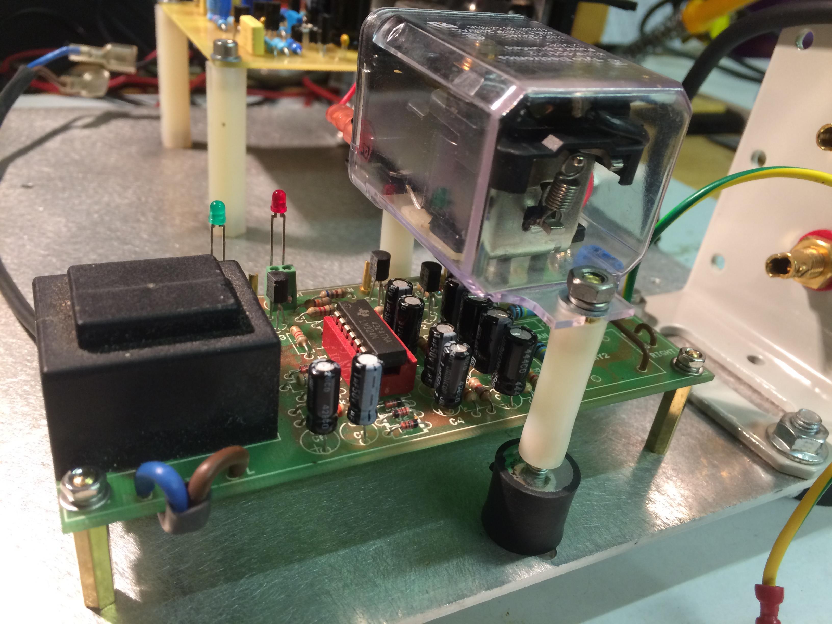

few more pics .. I have used a Velleman speaker protection module but have made a few mods
Like one heavy duty relay, and modded to PCB so both input channels can be used for a mono amplifier (dual redundancy)
plus played around with the timing capacitor for power up start up etc

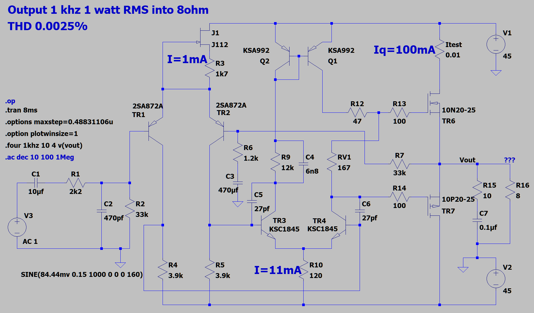

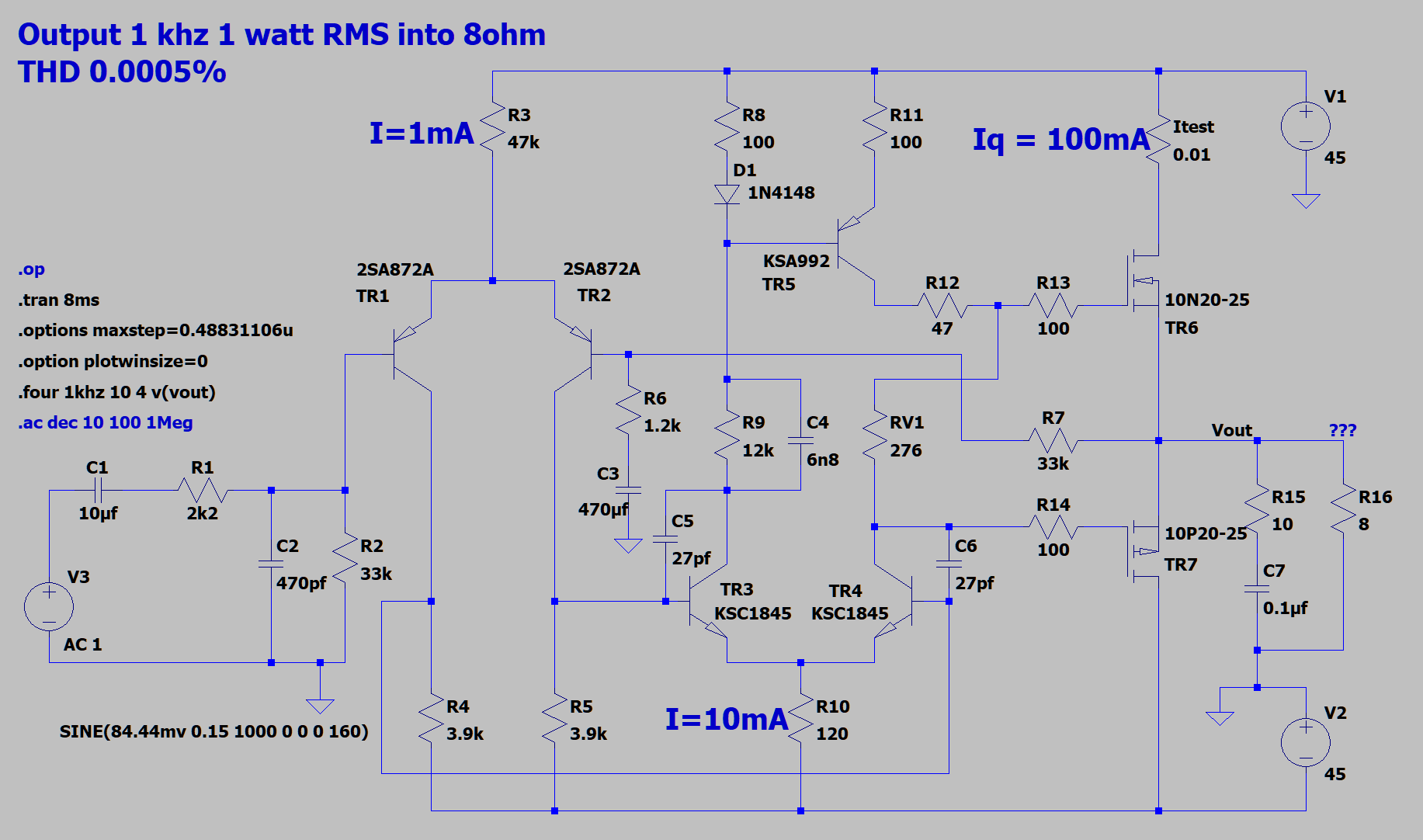

Hi Guys,
Before starting a build of the famous Maplin 100W Mosfet amp, I have been experimenting with LTspice (original file by Mooly?).
I have 2SA872A trannies for the LTP and Exicon 10P20/10N20 latfets for the outputs.
I cannot find the original 2SB716/2SD756 but have plenty of KSC992/1845 instead which look pretty similar (120V, high hFE, low Cob).
Some have used MPSA42/92 but the ones in my stash have pretty low hFE <100.
The simulation is very promising with a 0.0005% THD @1W.
I have tried next to add a J112 CCS and a current mirror, keeping the LTP/VAS/output current values nominal.
In these conditions the predicted THD is 0.0025%.
Is it expected to have a higher THD with CCS and CM? Do I miss something?

No degeneration resistors in the current mirror.
I only see a very marginal improvement.
Yes needs 100r in each leg.
I just used off the shelf cheapo transistors on my updated version.
MPSA92 and MPSA42 high voltage general purpose transistors.
LTspice does not seem to like degeneration resistors: if I remove the two 100R resistors from the original Maplin CM, THD goes from .0005 to .0003 (while keeping output bias constant).
Wierd.

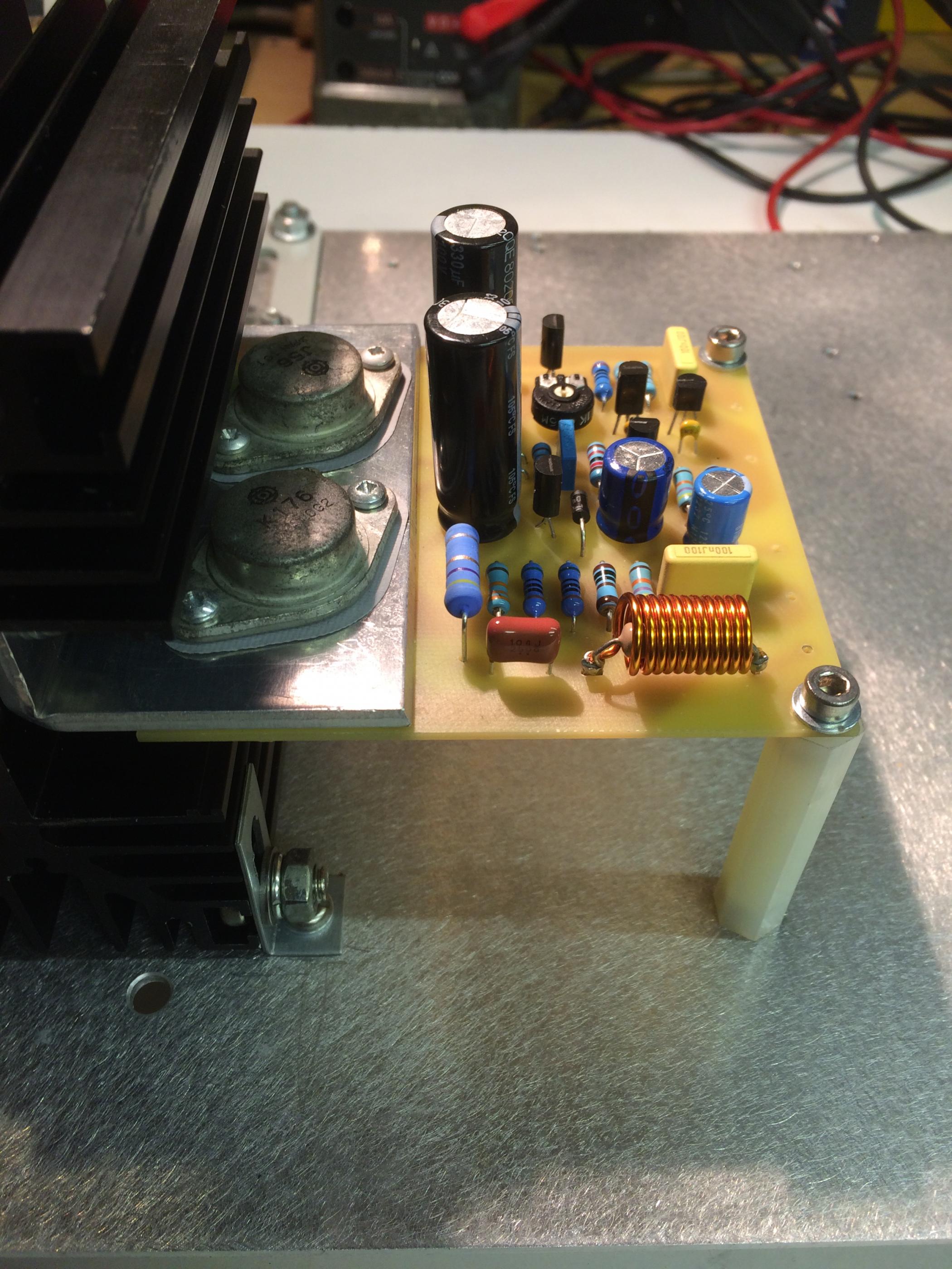

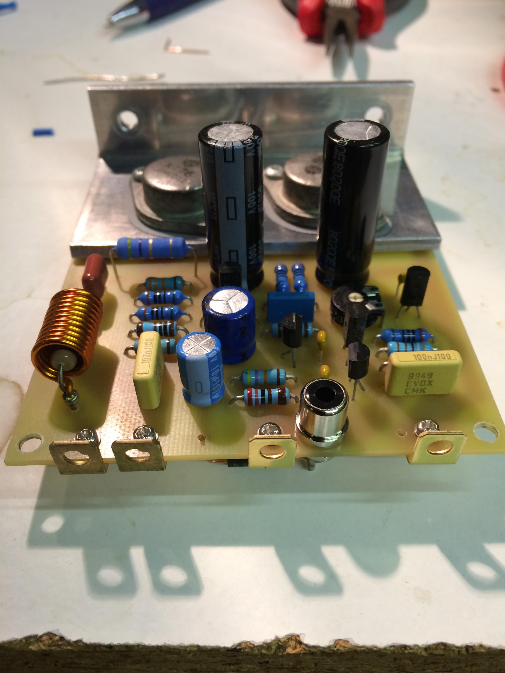

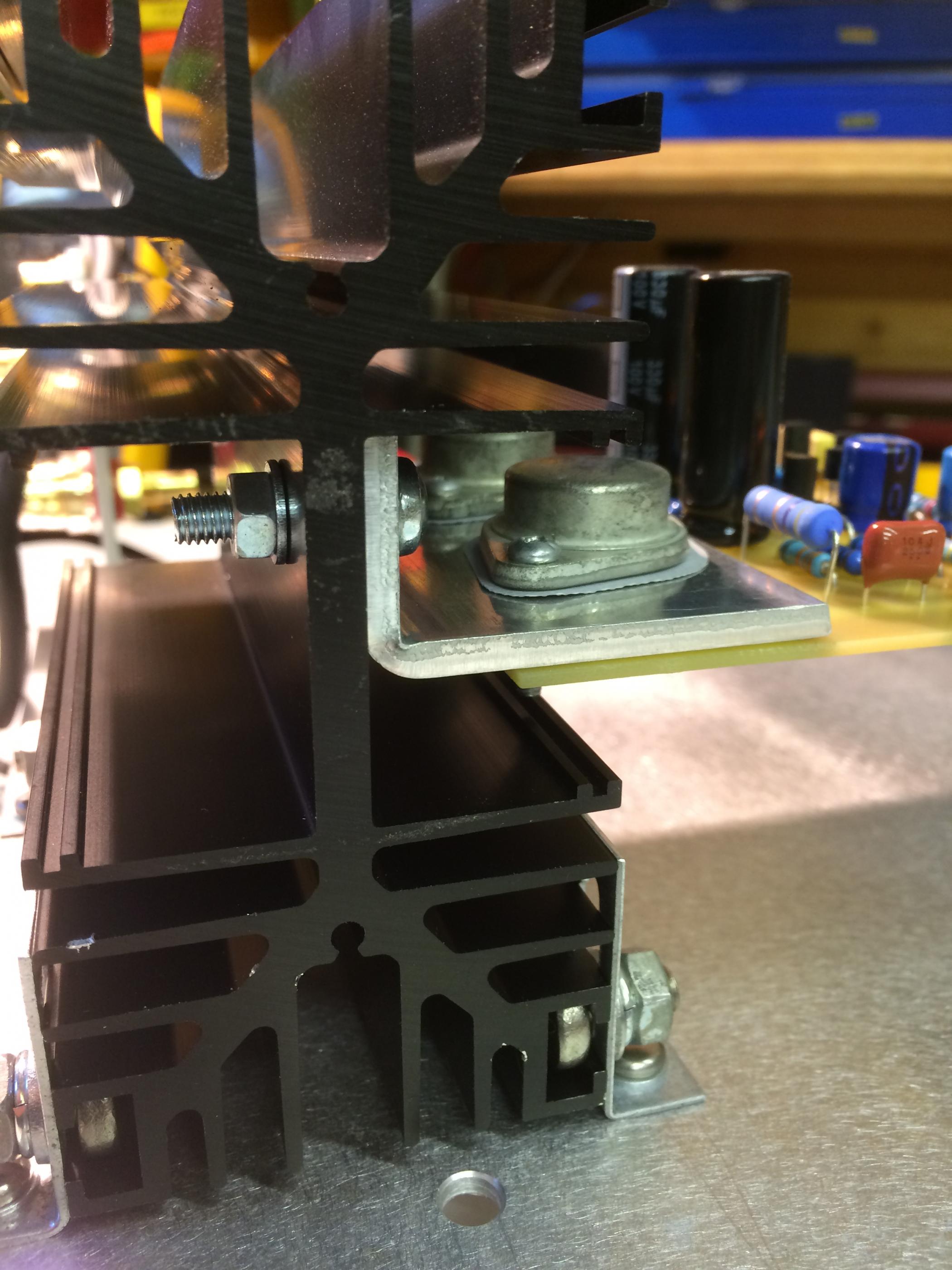

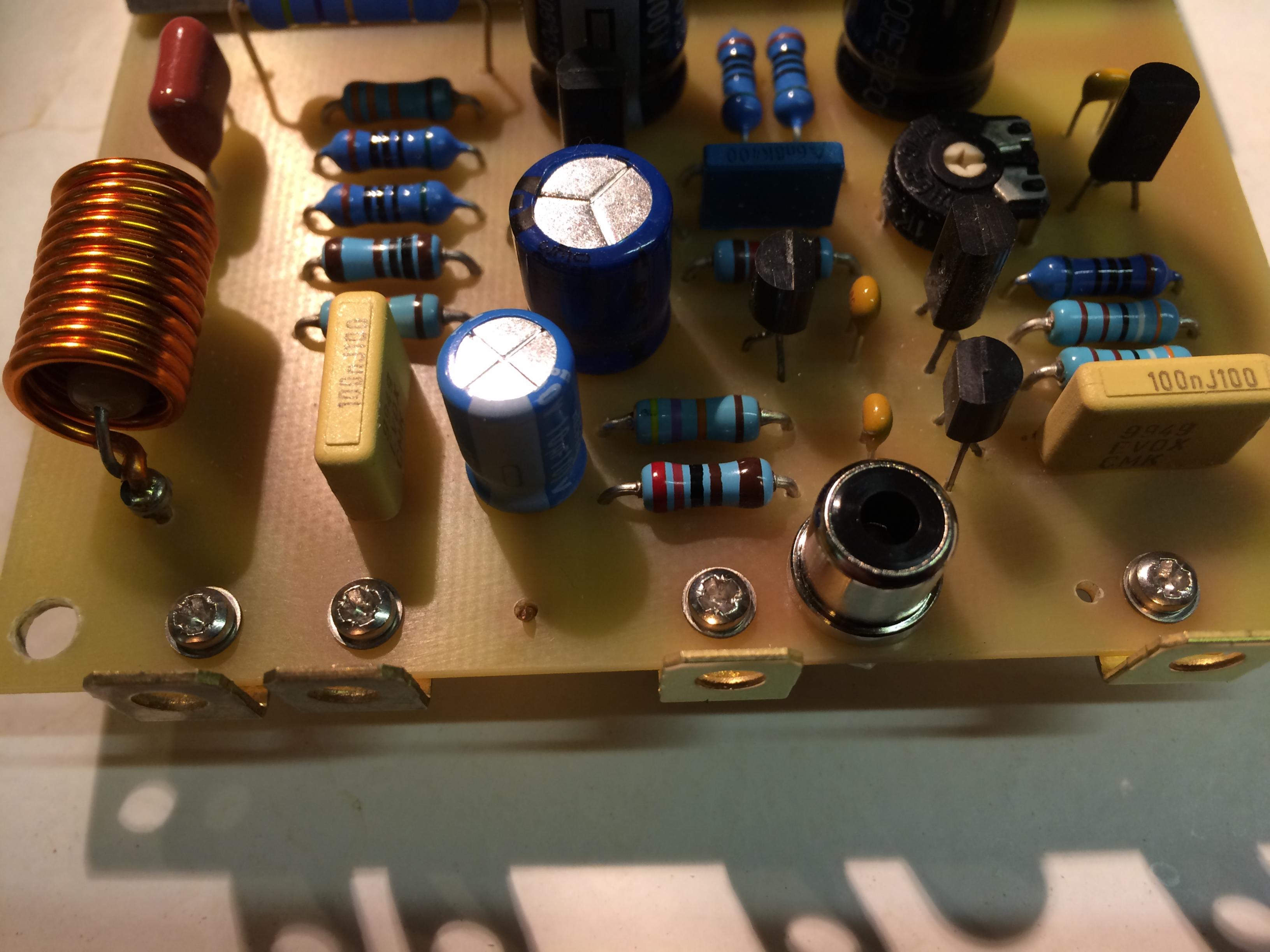

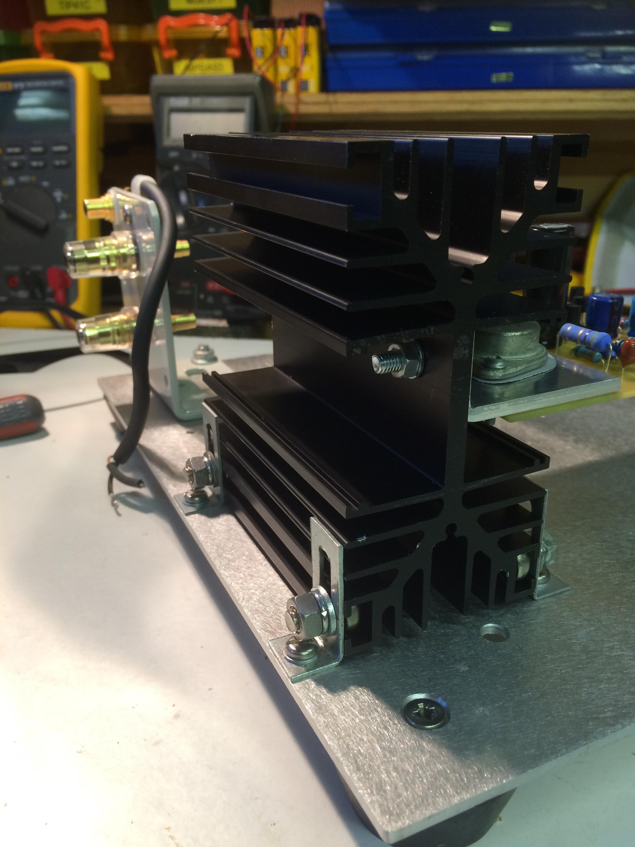

Hello

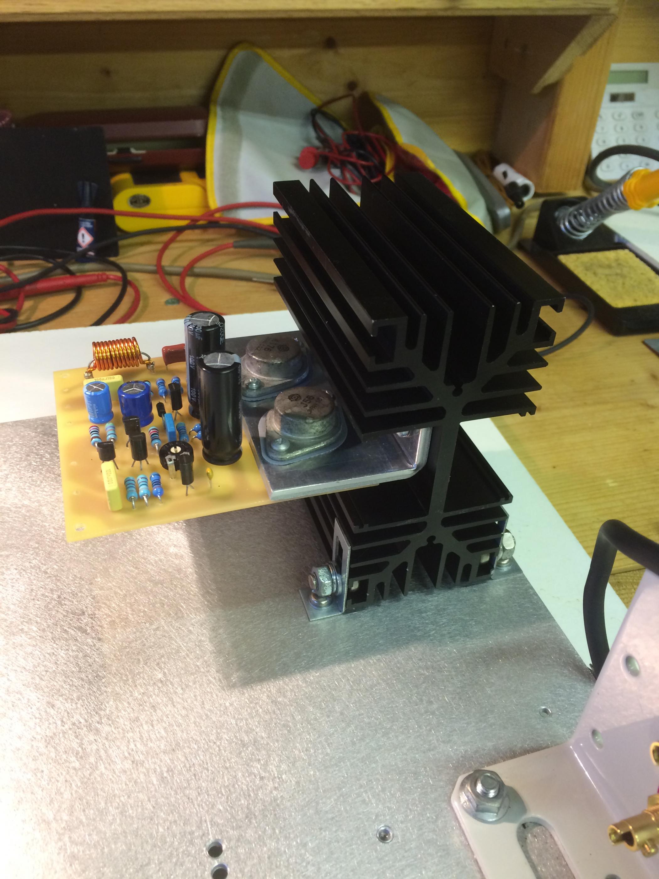

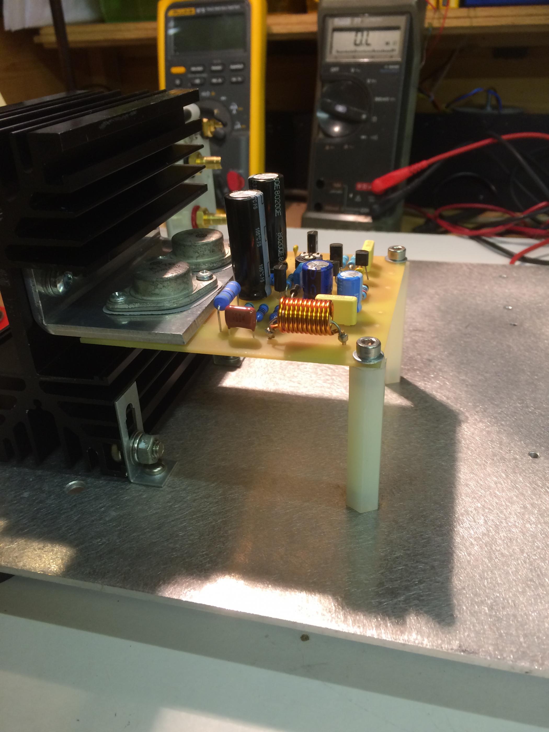

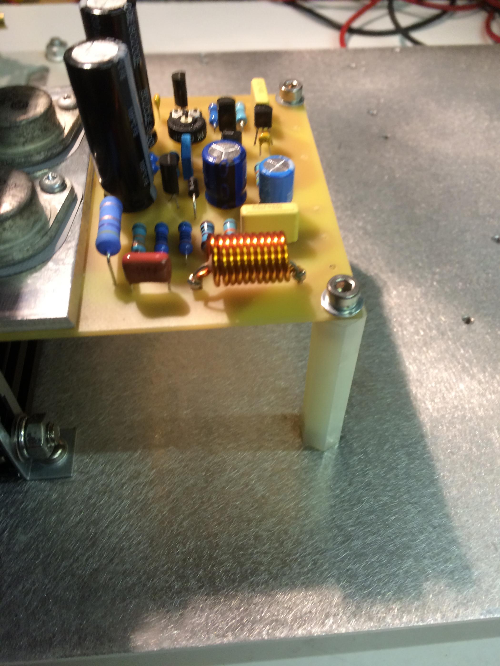

A couple of pics of the final PCB completed .. I have used 90 degree angle pcb tags for all connections and a phono connector for the input.
I know lots of people complain about hum with this PCB design but in my configuration I have always had very good results ??
Hi James,
I like the RCA connector, how deep does it extend under the board?
Where do you source it?
Jacques
