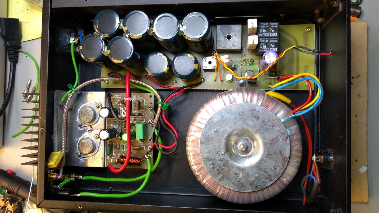

Observation..... it is best to connect the safety earth directly to chassis via its own bolt that wont get undone in the process of removing other items. At present if you remove the amp pcb for maintenance/modification you will disconnect the safety earth . Just thinking of your safety .
Thanks, I've moved that now to a dedicated bolt, M4 tapped into the steel chassis.
The mains socket is a clip-in, and there's no guarantee that heatsink is well grounded (due to all the paint, even though it buzzed out), so I wasn't very attached to the old system.

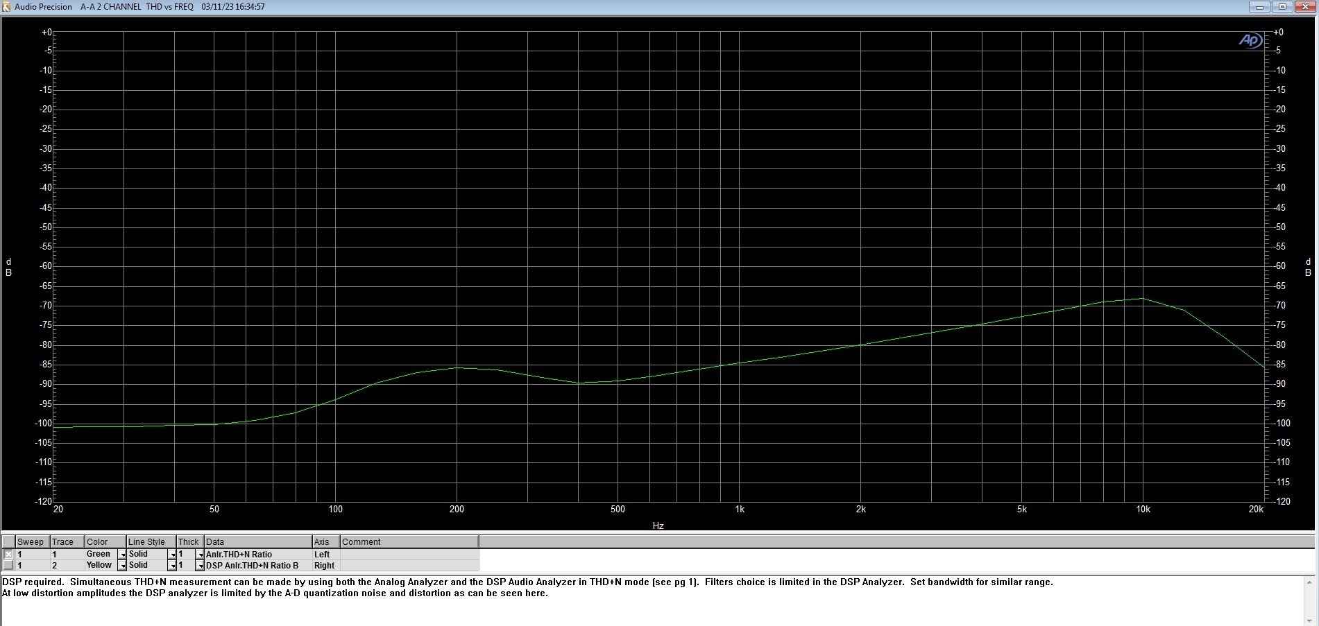

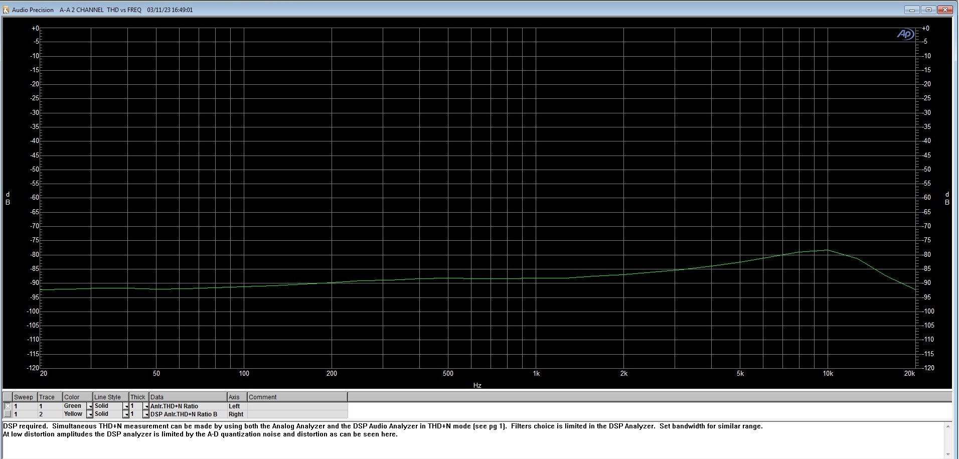

Hello!
I just powered up one of my Maplin amps via a bench PSU on +/-35V and got the attached THD plots. I haven't shown noise as they are naked, with long, unscreened wires to the PSU.
Notes:
They are using Exicon 20N20 / 20P20 O/P devices.
Plots shown are into a 5R dummy load.
There is a lot of bias. In the 10W test setting, flicking the bias switch from low to high has a massive impact with upper-order harmonics. 3rd seems to really jump down, but the higher-order ones disappear.
They were designed to run 600mA @ +/-75V (or 250mA in the low bias position), so in the plots here @ +/-35V the amp is drawing 500mA (would be 220mA in low position).
Mods:
R3 on the emitters of the LTP has been replaced with a CCS (pair of LEDs and BJTs - was a mod sold by David White AKA White Noise)
R13 Gate R changed to 220R (not sure why R14 is still 100R... Made the amps 22 years ago and memory is fuzzy).
O/Ps have 8V2 zeners back to back with 1N4001 to clamp protect against clumsiness. I wonder if this really will do anything?
Collector Rs for the LTP = 4K7 (not 3K9).
R6 changed to 820R (I plan to make it higher as it has way too much gain for my needs, although I might tweak overall FB R instead)
R9 is 15K not 12K
THD increases with frequency (states obvious). The above mods were done mainly in order to run it at higher rail voltages, so I'm not sure how relevant my quick and dirty test on the 35V bench PSU is...

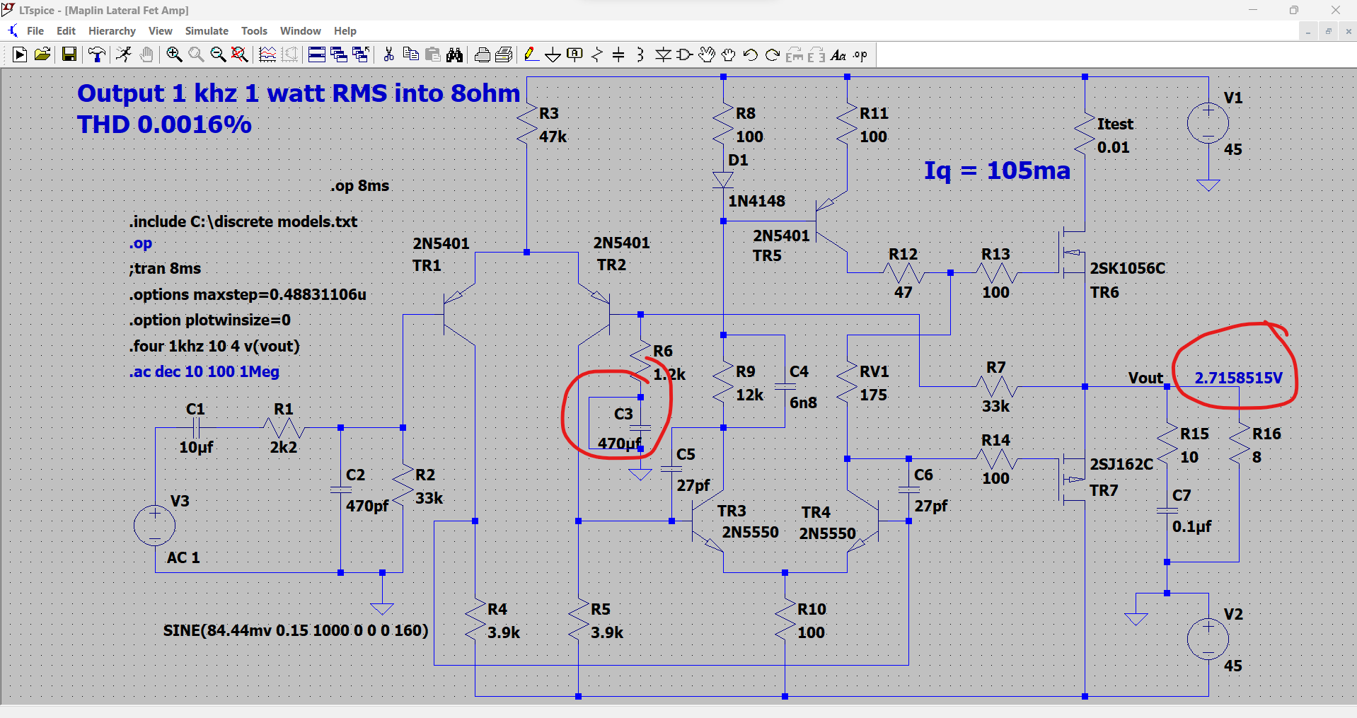

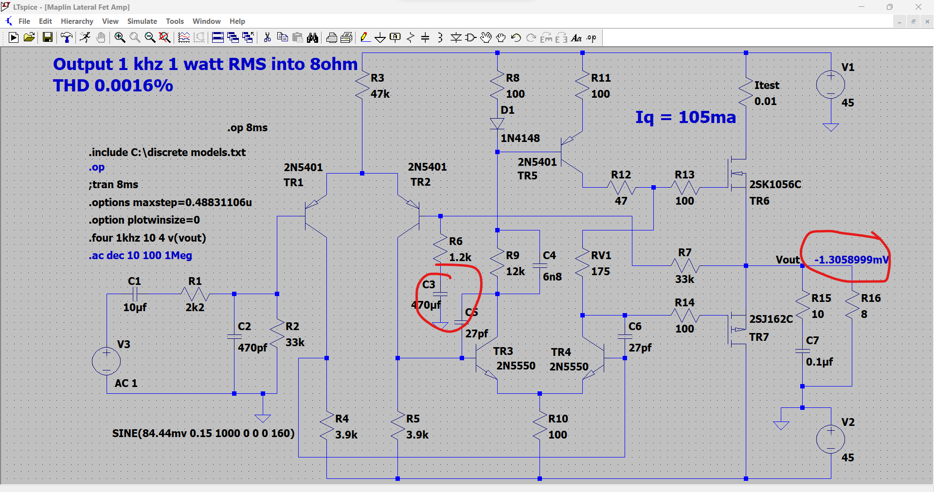

Hi all, I've dusted off a couple of original Maplin modules for my little F6B project, and back in an old post there is mention (by Nigel Pearson) of the 47uF feedback arm capacitor.
This is a polarised cap in the diagram, but the suggestion is to change it for a non polarised. Polarising is a situation where when reverse biased, the capacitor acts as a diode - so it's not a linear situation, so the idea is most excellent.
This 47uF cap connects to the base of TR2, which should be around 0V anyway, due to R2 and the mirror. Not sure how accurate a mirror is in DC - perhaps 0, 0.7 or 1.4V, but still at, or close to, 0V (ground).
So my question is: Why bother with the 47uF capacitor at all? Why not just eliminate it? Any thoughts?
Thanks in advance!

Thanks in advance!
The 47uf gives an AC short while not shorting DC.
This gives an AC gain but not a DC gain which gives more stability.
@Globulator you can replace that cap with a DC Servo module. In this case you’ll add some more components to the schematic, which is not really what you want to do (considering this type of amp).
What’s good to have is an audio grade cap installed (eg. nichicon muse), parallel with a 1uf MKP film cap.
I hope this helps.
I hope this helps.
470uF is only 17 ohms at 20Hz, so whatever distortion it has is attenuated by 37dB at 20Hz, 57dB at 200Hz etc - any quality electrolytic will be fine, bipolar preferred.
Thanks guys, I see now, it lets the brakes off the gain at DC so it corrects the DC offset to a fine degree, so either a manual pot somewhere would have to trim it, or a DC servo added.

Not sure where these two lived before I inherited them. I did test them, both work and waveforms match, despite the rust 😀.
The previous two I built in the 1980s on my bedroom floor - now in the monoblocks - but these will replace a perfectly good 1977 Sony F6B power amplifier section as I prefer them to bipolars. My F7B wannabe LOL, although that was vFET.
... and it allows me a little DIY tweaking, and to keep these lovely Maplin amps alive and in use.
Maplin and Beatties, the 1980s were heaven 😀
The MOSFETs will have their own independent diode bridge + caps, one per channel, the preamp and this little driver board will be from a 3rd, perhaps via dropper (RC) resistors.
I changed the original 100uF caps for 1000uF but only 50V parts, as these modules were destined for a smaller amp once, but now I have settled on an old 35Vac transformer I had around, which gives about 52V per rail. Power draw for these driver board is about 14mA IIRC, so perhaps 50 ohms into the board and 330uF 63V caps might be ok there - any thoughts?
