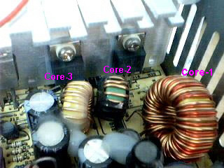

How to build Feritte toroid 4 SMPS with tl494+DC protection
there is a feritte toroid in SMP Sschematic . I did not know hou to making this Feritte toroid core . I want to build SMPS for 300w-400w car amp.
I have some unused PC power supply (230v 235w 4A) and i see some(3) core there (see attach pic). my question is
is this feritte toroid ?
and may i use this feritte toroid in SMPS without modefication?
There is 3 feritte toroid and which one i can sued? (biggest one?)
Any one suggest plese.

the cores are too small for a SMPS. even the biggest one is still too small. you need a core of atleast 1.5" in diameter for a 200 watt PSU.
and also, the cores are powdered iron. you need ferrite. the toroids you mentioned can be used as input filtering so that your amp SMPS will not put spikes or noise into the car electrical system.
The cores are designed to be used for DC filter inductors, as their yellow color code indicates.
If they were the right type, the power handling ability would be more dependent on switching frequency rather than "how big it is"
