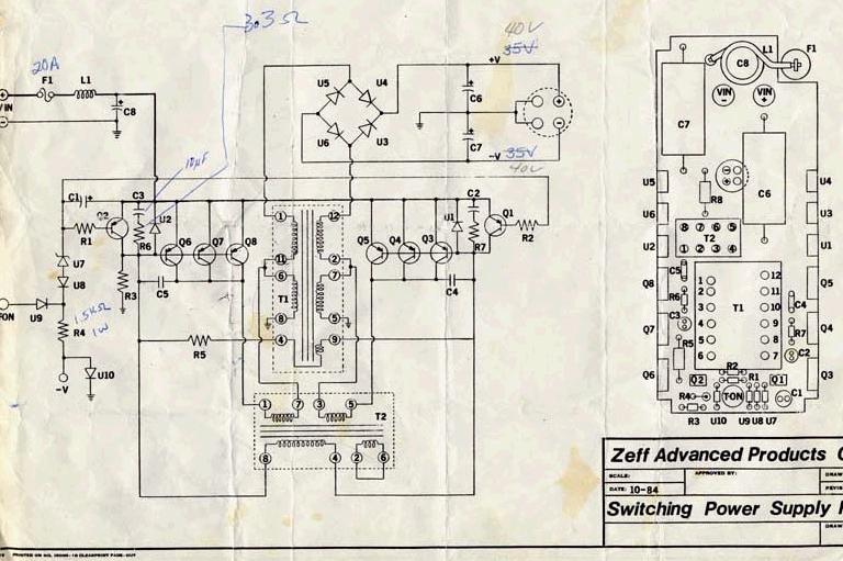

I'll attempt to attach an ancient SMPS schematic from Zapco for their 100WPC amp produced until '91 or so. Somewhere, I also should have their previous 75WPC supply as well. They used no IC's whatsoever, and the supply worked like a charm.
Though the schematic doesn't make note of component values, I do have one of these supplies, and can identify some values if it would be helpful in evaluating a design.
Tim
it may be simple but the need for two transformers makes me think there's a lot more to go wrong than using a 3525 or TL494 to make one.

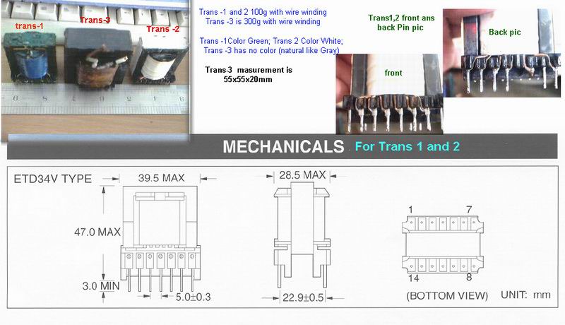

Can i use EE core transformer in this SMPS
Hi djQUAN ,
Thnx for replly (post#163). Idid not find any toroids in my city. So i have to looking for "Ferrite EEcore transformer". I found some EE core in a local old spear shop. I think this are EE core (see pic).
Also think this are ETD34V Type transformer(trans1 and 2). caused i found semelar masurement in data sheet. (see my core masurement pic ).
now my question is :
1. is this possible to use this ETD Transformer in this threat SMPS schematics instant of toroids?
2. if possible what size ETD transformer i can use here? may i use my any one of thus? which is the best ETD core trans# 1/2/3? (see pic for size)
3.U suggest me dont buy any yellow label core (coused they are powdered iron) ; i see some ETD transformer are various color label in out side with color tape i.e yellow/green/ white/brown.
My one are green one is white and another one(big one) has no color lebel .
4. is there is any meaning of this color lebel? what is the meaning of each color?
5.how can i determine this is a ferrite core?
6.this are already wire winding and now i can use this winding? how can i masure its pri and secondary winding ratio?

Hi djQUAN ,
djQUAN for your kind information about STK pls see STK datasheet caused i follow everything from there.
Any one can answer/suggest me pls.
Regards
Robin

robin,
the EE core transforners that you have are of the right size. BUT you have to remove the windings and make a new one. since the old windings are wired for 120/220V inputs and 12/5V outputs. the tape around EE cores don't mean anything (except for the maker).

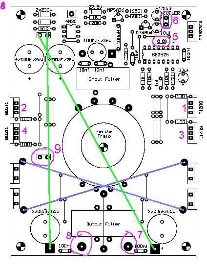

Help me pls
al last i making SMPS as Ristro80's shcematis and PCB diagram (post #5, 6,7). i jsut use ETD39 transformer instand of Triode. and winding was pri-4x4 sec-14x14.
I got some problem when it is running ( i indicated all prob# in the pic):
1. if i use LED, see attachment pic (problem #5) no output volt found. but if i diconnect this LED i can get output volt 55v when input 13.8v
2. i was used a 40w(just connected a 40w buld) load (for testing )in output without LED connection it is working( buld are lighting) find but only BUZ11#1 and #2 are hot littlebit. but BUZ#3,4 are not hot even worm. is this normal. (why not buz 3-4 are wormed?)
3. all time cooler fan are running. is this normal?
how can i wana run cooler only the SMPS are running.
4. where is this SMPS output line?( i think is this #9 )
5.what is the function of point #8 and #9 ??
6. I used extra wire for connection ( Blue and Green colour) this are right way connected? ( confuded caused it was not mantion in PCB Upper /bottom file)
7. there is a remote point near upside 4N35, what is its function. (is this can run /stop SMPS?)
where i connected this point?
8. how can i Test this SMPS with full load with remote function?
any one help me pls

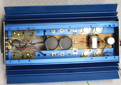

TL494 smps.
Hi all, I have been building car audio for many years. I tried all different controllers and have a fondness for the SG3525. I have made many smps using this chip and have had no failures. There is a TL495 which has pulse by pulse current limiting. recently started with the SG3626 which uses current mode control.
I made one amp using two ETD59 cores for power supply. I wound the primary with copper foil insulated by teflon sheet. The secondary was heavy litz wire taken from an old ultrasonic cleaner supply. The amp ended up with 900 watts RMS per channel into 4 ohms. I have learned a lot the hard way! Litz wire is the only way to go, it gets rid of the "skin effect" and makes the supply more efficient. I recently bought out a transformer winding company's inventory and have a lot of litz wire in my warehouse. I will be offering it for sale as soon as I get it all cataloged.
