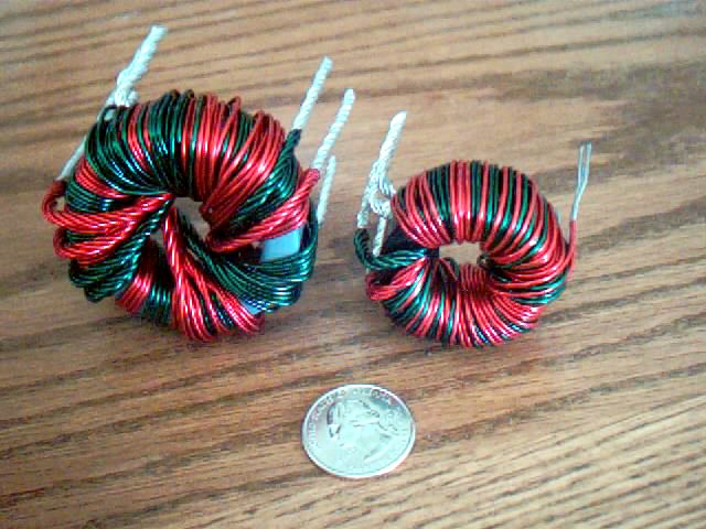

Prices were $17 for large units and $13 for small units. If interested feel free to e-mail me. I have a large quantity available and they do look and perform great! :)
They designed to be run in regulated mode (where voltage feedback goes back into the PWM controller and PWM is adjusted to keep output voltage constant). The large unit was wound to put out +/- 35V from 10-16V supply. There are dual secondaries and dual primaries that have massive leads....the big unit will supply 500W or so with no sweat, I have a few running in my car right now with no problems, power supply based on the TL598 though. I am not sure how the TL494 and 598 differ though, any of you know off the top of your head?

Matt, I'm running my small Transformer I got from you at 45khz unregulated. These transformers are so much more forgiving than the ones I wind myself. I just threw it on the board and it was solid as a rock. No tweaking and no heat and no noise! My home wound cores would sing an eirie whine similar to a horror movie soundtrack.
