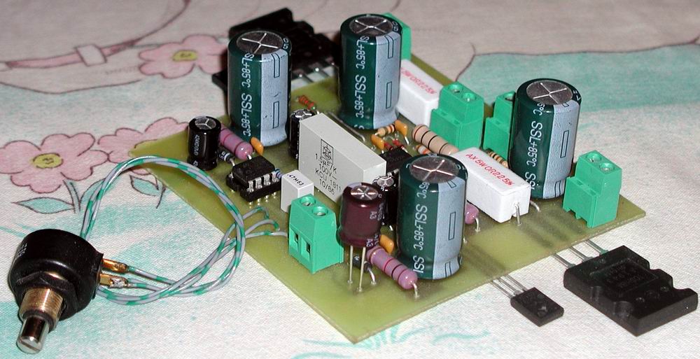

luka said:this is my SMPS and AMP from risto80
I love how clean that amp board is. What output transistors are you using?

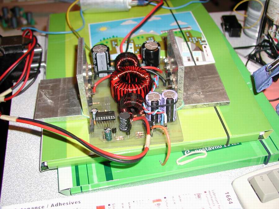

hello everybody
i am in need of all the help i can get
my first SMPS project though it works
the problem was the torroid heats up quickly and i mean HOT
the PWM controller use was TL494CN
plus the fact that the other mosfet is cool while the other one syncronize with the torroid heating up
what seems to be the critical problem of the said project
ANYONE? Plzzzzzzzzz help
