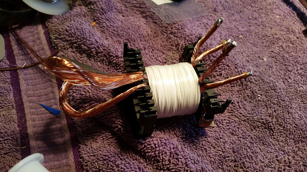

praymery:i make 5 turn in half of core and more 5 turn in half or core
secondery:i make 20 turn in all of area core
how correct it??!

الان تبدیل ولتاژ من کار میکند اما من میخواهم مطمین باشم از نحوه پیچیدن هسته!
Hi yes your first link worked, i think u need to rewind the transformer and make in neater and more uniform. here is a picture during the winding of one i made.
